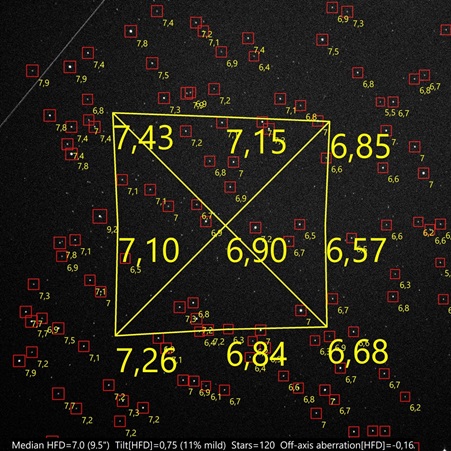

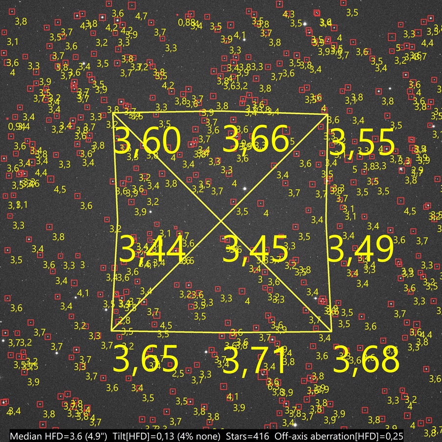

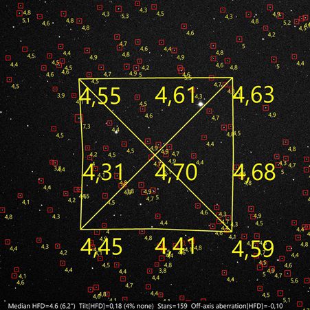

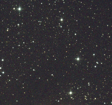

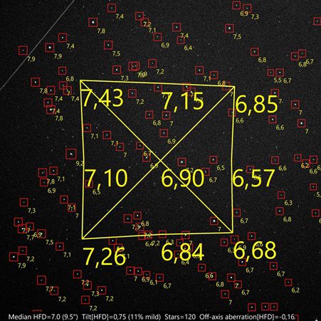

Tilt causes a change in focus across the field. If you posted a sample frame, people would be able to weigh in more.
Here are some examples captured without guiding in city center:
before tilt adjustment
after tilt adjustment
Now i prepared this telescope for guiding and waiting for the weather to do more tests and do fine adjustment.

You was absolutely right! I tried to think logically - what part of telescope forms light cone to focuser? Ofcourse it is the secondary mirror.. What if try to adjust it under the stars, not by chinese collimator? Yesturday i tried slightly move screws and see what happens with tilt in astap, and it works! Thank you very much, finally i can remove the tilter and see good stars in each corner.
So if that laser collimator is enough for my 130PDS (F5), for F4 i need adjust secondary mirror much more carefully. Hope that will helps someone.

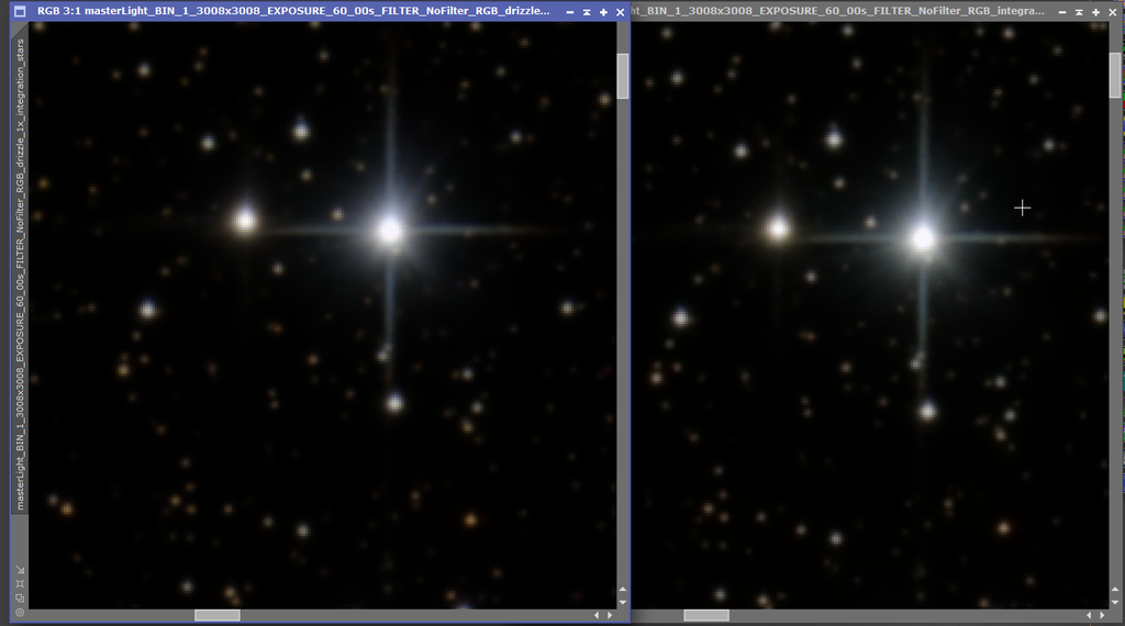

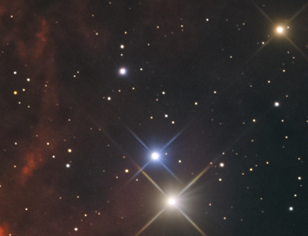

Hello Experts!
Don't want to create another post and will ask new question here. After carefully adjustment and first tests i found another problem that i can't explain. On the fits image i see pretty round stars, but after initial stretch in ghs they looks like a small crosses. It happens only wigh middle-bright stars on the whole image, not in the corners. If i use bxt to reduce their size they looks like sharp crosses) I didn't see that before with another telescopes. What can it be - pinched optics, astigmatism or something else? Bright stars looks good..
daserpey 6.02
Hello. It is difficult to say. Looks like undersample but I think you have 1.36 arsec/px. What I would do is to drizzle 1x or 2x and see if there is an improvement.
deadshad 1.20
David Serquera:
Hi, thanks for that idea. I've compared two same stretched images - without drizzle and with 1x, and last looks a little bit better. So this pixel scale is not enough for good seeing, right? And solution for me is only with postprocessing by PI?

I think your images are fine anyway. It depends on what do you want to show, if small stars or large nebula gradients or fine structures. I personally always try to do drizzle 2x to gain from deconvolution with BxT but that it is up to you.

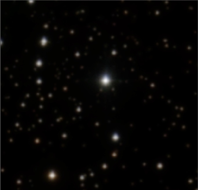

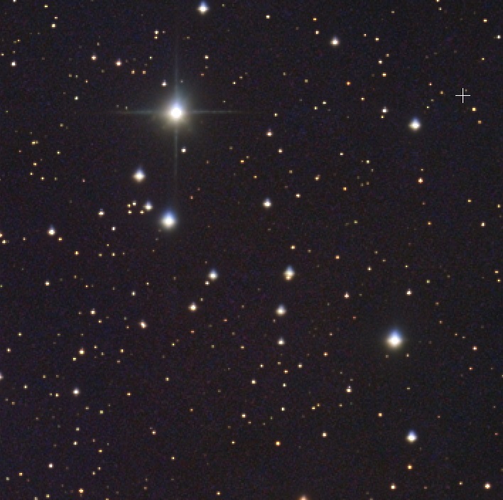

After all it was a pinched mirror. Here is crop of processed picture (without drizzle) after releasing the mirror clips - stars looks round and pretty good.
