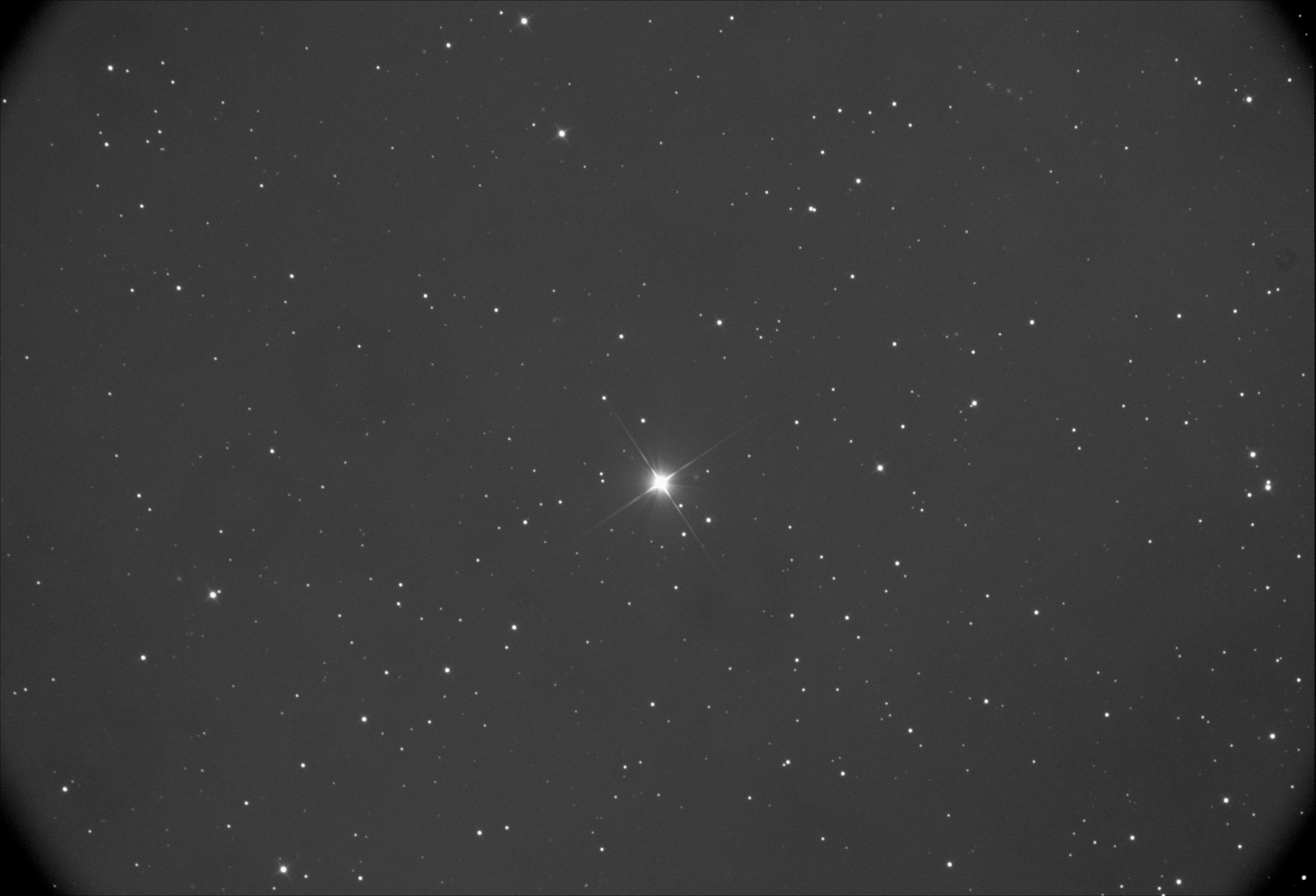

First light with the Steeltrack on my 8" f/4.5 ONTC. 10x1 min subs, ASI294MM Pro, unguided, so there may be some slight tracking errors. Seeing was bad due to jet stream.
The Steeltrack seems to be more precise than the Moonlite CR2. It runs smoother and has less slop around the Paracorr 2. In the data below, only the clamping mechanism was used, though I intend to employ a screw thread adapter.
The only thing I didn't like was the "VersaBase" of the Steeltrack. It has to be sealed for light leaks and it also has some very sharp grub screws that will scratch the focuser. But I guess one can change those.
NB: I have had serious annoyances with the OOUK primary mirror cell on my setup (flop, pinching) and there are some modest issues with my OOUK mirror having a slightly irregular edge. It seems like I have managed to mount the mirror correctly now but make sure you don't get faulty components if you buy this telescope. I would go for the TS ONTC mirror cell rather than the OOUK cell as it seems to be easier to use correctly.
