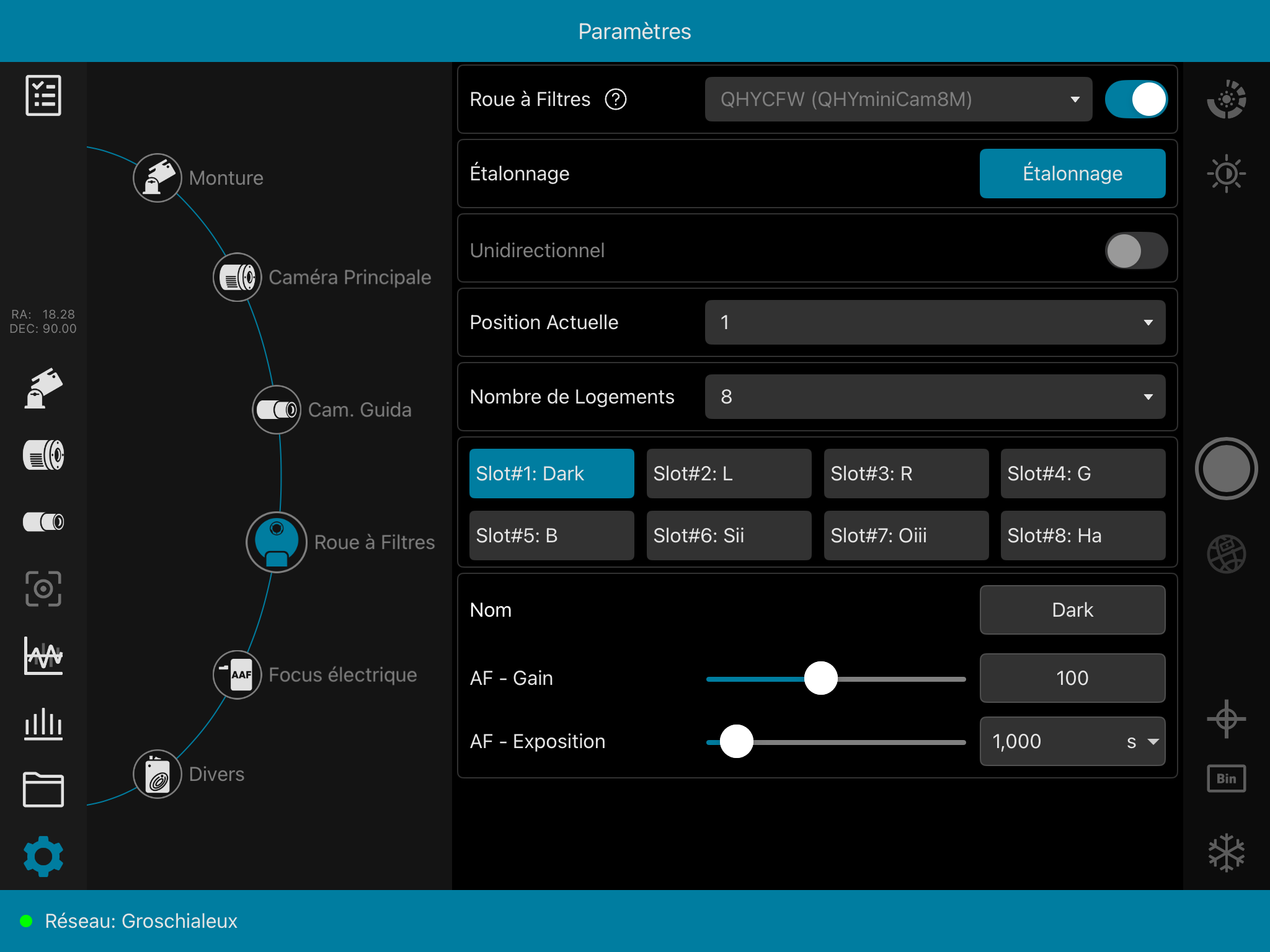

But, how did you get MiniCam 8 to work with Stellavita. Mine does not recognize filterwheel?
EricGagne 3.82
