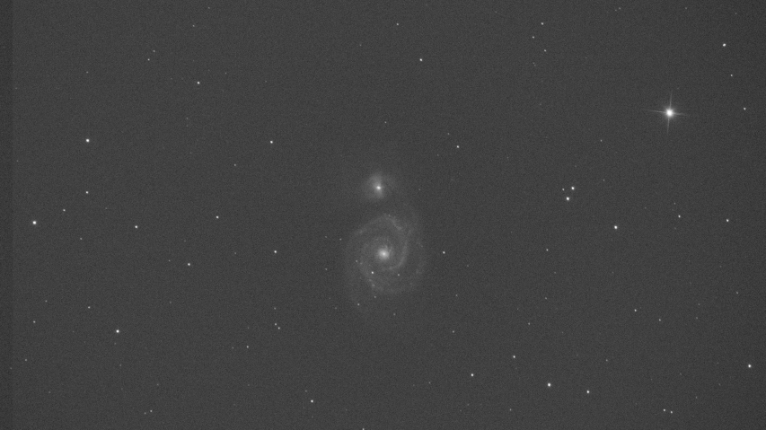

I last night tested my new ATR585M for the first night and I am getting a weird problem (that will ruin calibration frames). In about 30% of subs the image is offset and a part of the right image is wrapping over to the left edge (creating the darker border seen in the image below).
Acquiring through NINA. Tested both the ASCOM driver as well as ToupTek's own software and updated both. USB limit does not help...
Does anyone happen to have any idea what might be causing this? (Firmware is v4.50, I did not yet reflash that since the latest on the website is v4.49.)

Okay. I pulled the trigger and rolled back the firmware to v4.49, which seems to have fixed the issue for the time being…
