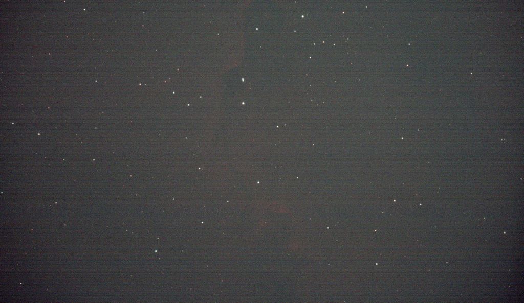

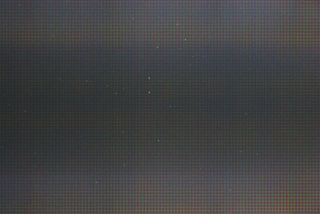

I have one of the knock-offs IMX571 from aliexpress color camera. I have two issues: Α. Once in a while it generates a completely problematic sub. Look at the two consecutive subs below of IC1396, both 240sec, @-10C, 500gain/ 1000offset (but it does it at any gain/offset) B. even the normal sub has some horizontal lines. I would like to hear from fellow astrophotographers if their ZWO/QHY 2600 has similar horizontal lines or if this is a result of the cheaper clones. normal sub (IC1396 240sec @ -10C, 500g, 1000offset)  problematic sub:  |

Cosmetatos: B. even the normal sub has some horizontal lines. That's some serious noise. The only time I've ever had a similar issue with any camera (I don't have an IMX571 sensor camera - yet), was when the data cable was inadvertently bound with an unshielded power cable. Wasted a perfectly clear night trying to figure that one out. Cosmetatos: Α. Once in a while it generates a completely problematic sub. I've never seen checkerboarding like that before. Have you contacted support?
Cosmetatos: I have one of the knock-offs IMX571 from aliexpress color camera.
I have two issues:
problematic sub:
 I’ve had this “ problematic “ sub lots. More times than I can count and it always happens when I’m doing a heavy process(like stacking) when the sub downloads. Horizontal banding, every camera has it and some people experience it worse than others.
Matthew Proulx: Horizontal banding, every camera has it and some people experience it worse than others. Thanks -- is there a solution about it? sometimes it shows in the stretched stacked image...
I have two issues:
problematic sub:
 For the first example, are you using the high gain switch at all or just increasing the gain value? I've also experienced the horizontal lines, they are non-fixed pattern noise that shows up in my autofocus exposures and bias frames at low gain on the camera (both mono and color version). Flipping the high gain switch mostly removes them. I can attest to the strange "weird sub" effect. I've had bad subs with the risingcam 571c exactly twice, both times I was experimenting with using NINA's Pixinsight tools to livestack.
I have a Touptek cooled mono 571 camera. It's been extremely good, cools down well (I limit my cooldown and warmup rates to 7K/min but it will go faster than this if you take off the limits) and images very nicely. There was some research posted on cloudynights a while back regarding optimum gain settings that concluded that in either low or high gain mode gain 100 was optimum: I use this and have had zero problems with banding or checkerboarding. It plays nicely with INDI (can't comment on ASCOM) and integrates well with the ZWO 7x36mm unmounted filter EFW. Also works well with AstroDMX capture. I haven't got it to work with FireCapture yet but Torsten did send me a message with some suggestions, seems like it may be a question of my setup or installing the latest SDK from Touptek; I haven't had time to do anything about it yet though. The 17.5mm backfocus hasn't been an issue for me, I'm using it with a Skywatcher 150PDS and Baader MPCC upstream of the filter wheel and it still requires M48 spacer rings.
For the first example, are you using the high gain switch at all or just increasing the gain value? High gain value - not sure if correct or not Adrian Knagg-Baugh: concluded that in either low or high gain mode gain 100 was optimum Thank you for the suggestion, I will try this and see how it goes. Do you get the feel that my subs are particularly noisy, or is it similar to what you get? (before dark subtraction)

Cosmetatos:
Thank you for the suggestion, I will try this and see how it goes. Do you get the feel that my subs are particularly noisy, or is it similar to what you get? (before dark subtraction) I'm not sure on the sub evaluation, but based on the gain/read noise curve, the camera doesn't experience a large drop in read noise by increasing the gain - only by applying the high gain switch. See: https://ae01.alicdn.com/kf/Hcf93f6e44a7447559ccdcee5bccacd09k.pnghttps://ae01.alicdn.com/kf/H8d0dd002341b4ff0bb710ab3b12ba2b5S.png |
See:
https://ae01.alicdn.com/kf/Hcf93f6e44a7447559ccdcee5bccacd09k.png https://ae01.alicdn.com/kf/H8d0dd002341b4ff0bb710ab3b12ba2b5S.png Thanks for the tables - so if I read it correctly, best is Gain 100 and HCG as it manages both low read noise (second graph) and high dynamic range? What about 150 or 200 gain (lower read noise) and slightly lower dynamic range?
