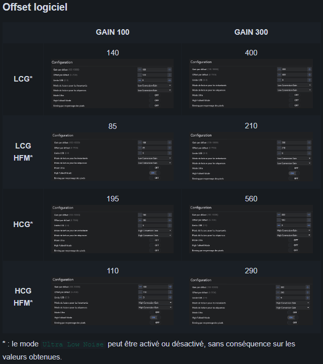

What are the best settings for the ToupTek camera 2600 MM like Gain and offset in the different modes, HDr etc

I found these values after some software offset tests in NINA:

This is the first pic from the table:
It's easy to understand with the table, and adapt to your case.
