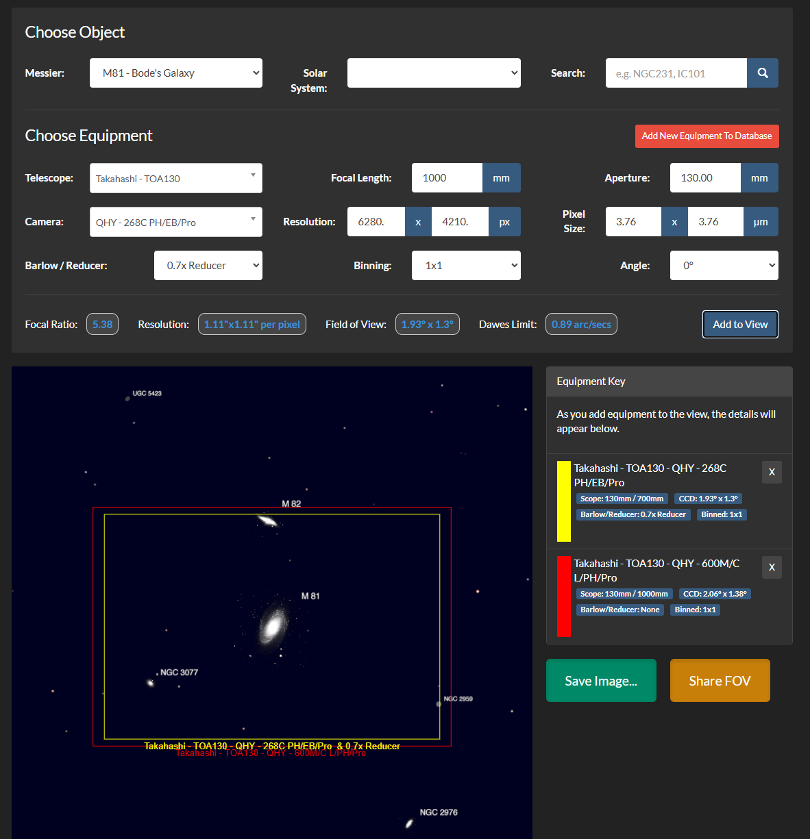

What's your opinion about full-frame cameras?   They're incredibly expensive, the filters are expensive, the files are huge, the processing time and data storage increase a lot.
Those that have gone that way;  Is the extra resolution worth the expense to you?  And why?
It doesn't show it in the chart below but the QHY - 600 samples at 0.78"/px compared to the 1.11"/px of the reduced APS-C.
Leela.Astro.Imaging 1.51
I have a Tak FSQ106N and moving to a full frame camera was without a doubt the right thing to do.  Pick a good camera though (I heartily recommend Moravian CMOS).
whwang 15.16
I think it's a general phenomena among TAK's correctors that a flattener gives you better angular resolution than a reducer does.  If you put a camera with larger pixel scale on a reduced TOA, I believe you will see a difference in resolution compared to the flattener case, unless your seeing is terrible, of course.
So, similar FoV, sharper and less sharp image.  Is it worthwhile to spend the extra to get the FF camera?  It will depend on the seeing of your site, and how much you value image sharpness at pixel level.  I think only you can answer this.
