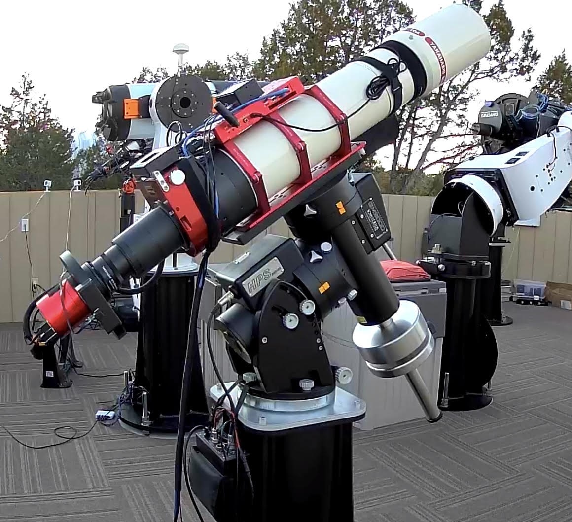

Hi, I'm considering purchasing a TOA-130NS because of the amazing published spot diagrams of the 645 0.99x flattener. I'm looking for a 'galaxy' scope so the 1000mm focal length appeals to me. I know that I'll have to replace the 2.7" focuser so I'm looking for options. I already own a WandererAstro M68 rotator. 1.) $3.5k -- Moonlight WR35, great focuser but it's 2/3 the price of the scope which seems excessive. 2.) $2.2k -- Feathertouch FT3445B-A + Wanderer v2 M68 rotator + Oasis Rose electronic focuser 3.) $3.6k -- Optec Gemini, see comment from #1. 4.) $2k -- ESATTO 4" robotic focuser + Wanderer v2 M68 rotator Here's a picture of something close to what I'm thinking. I welcome any and all advice and comments... what are your recommendations? Thanks.  |

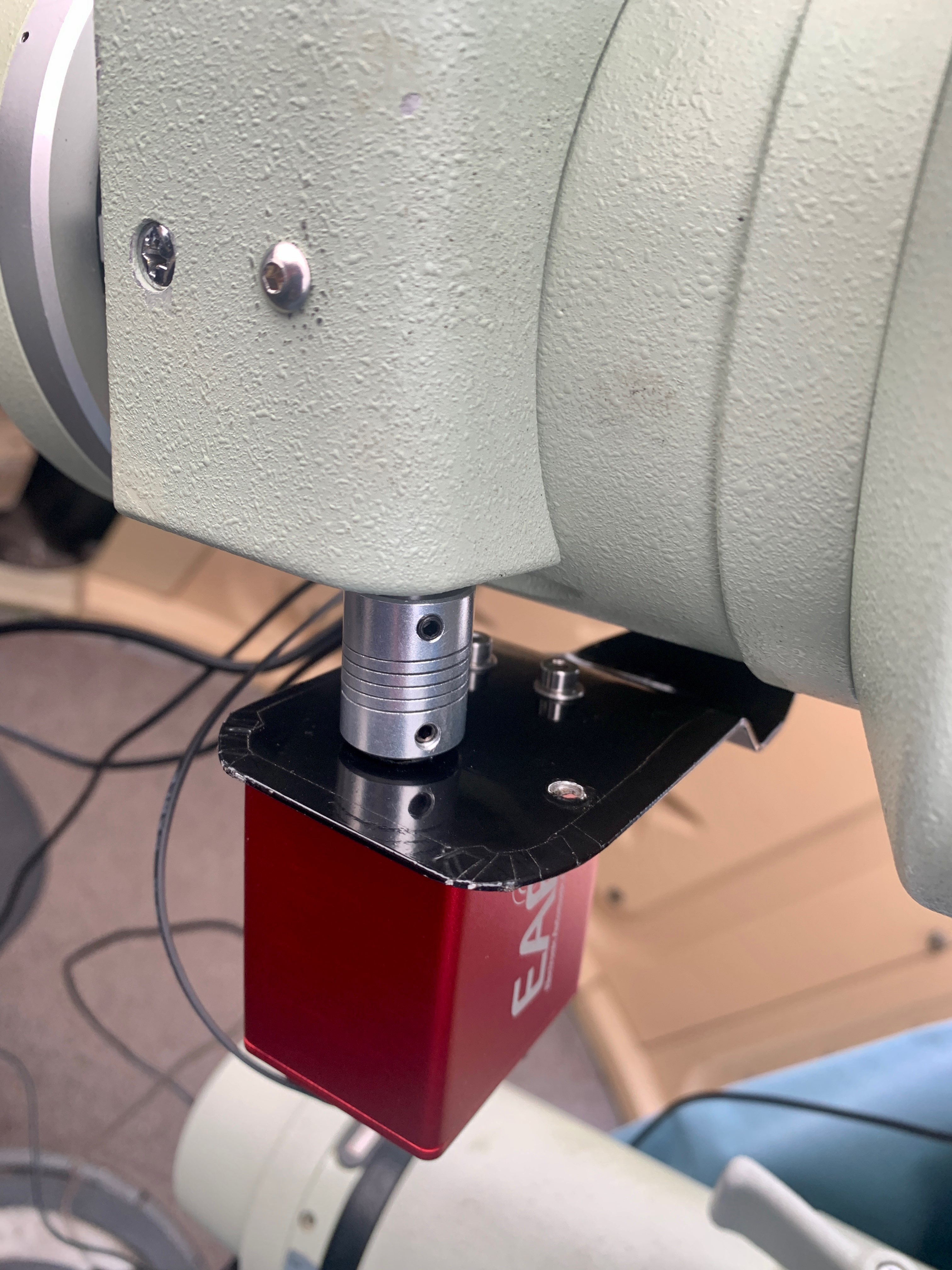

Hello John, We went for a simple ZWO EAF Auto focus unit and have never looked back. Cheers from Tasmania. Richard  |

I got the NFB version, and just added the ZWO EAF. I've never had any problems with AF or slippage. (payload is OAG, EFW, asi6200mm) I'm constantly tempted by the esatto/arco combination, but just haven't had a good reason to pull the trigger.

I’m sure you could get any of those four options to work. I have three WR35s on three rigs, including one on a TOA130. I also have a Gemini on another rig. Both are rock solid. I never even think about focus or rotation—it just works. I will give a slight edge to the WR35 because unlike the Gemini, it doesn’t require an external controller that has to be mounted somewhere.

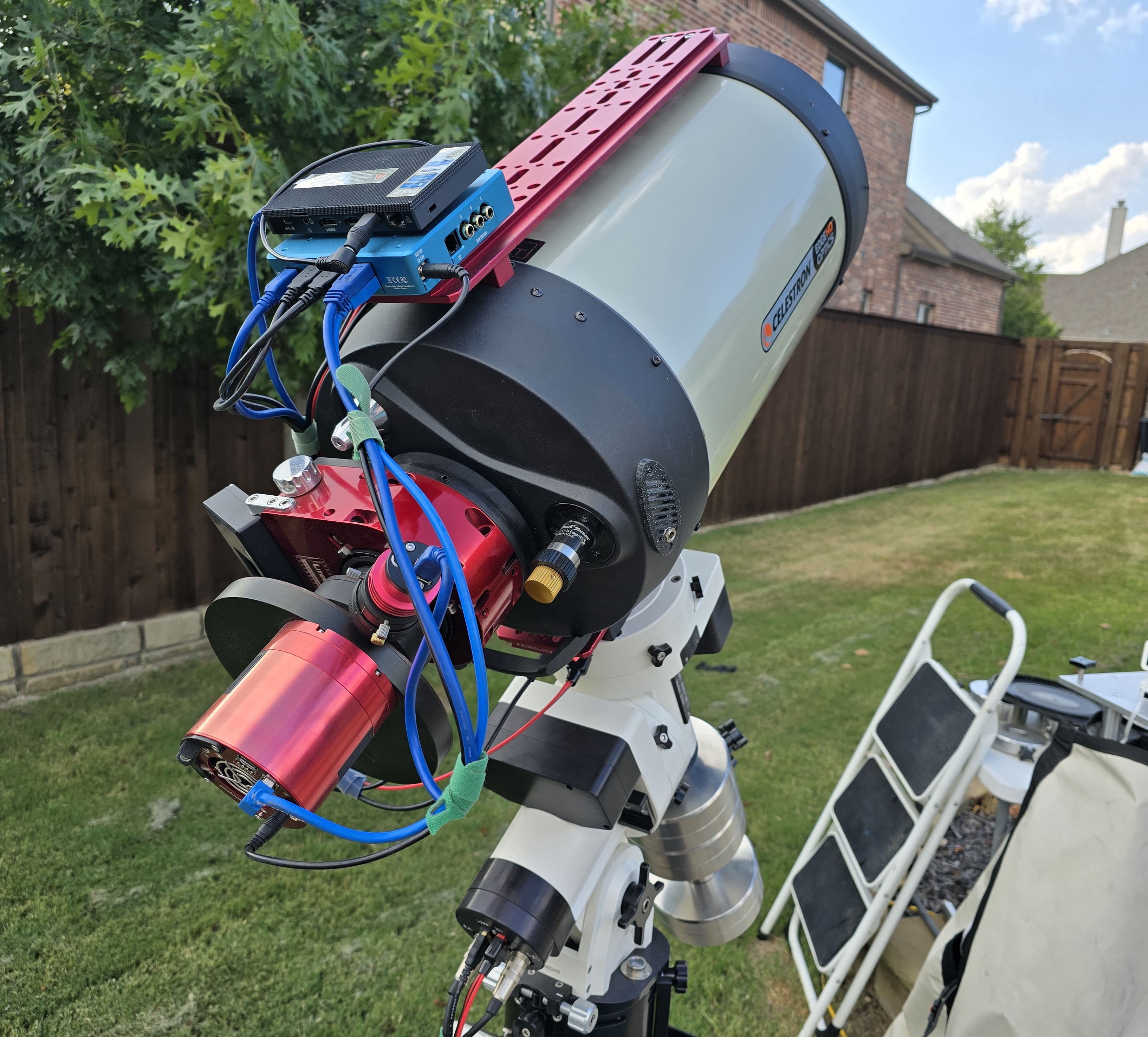

Just FYI, the TOA with 645 is a monster. It’s the best scope I’ve ever owned. It uses a C5 with the giant medium-format 100-mpix IMX461 sensor. The field is perfect all the way to the edges. If seeing is decent, the FWHM consistently comes in at about 2.6, which means I can drizzle. That effectively turns it into a 2000mm rig with a 400-mpix sensor.

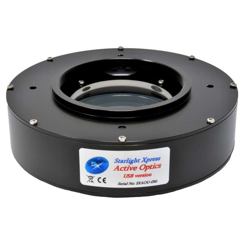

Okay, I’m convinced/. WR35 for the win. Any thoughts on spacers before the focuser vs spacers after? Second question: anyone figure out how to use an AO unit with a TOA? Maybe put it before the flattener?  |

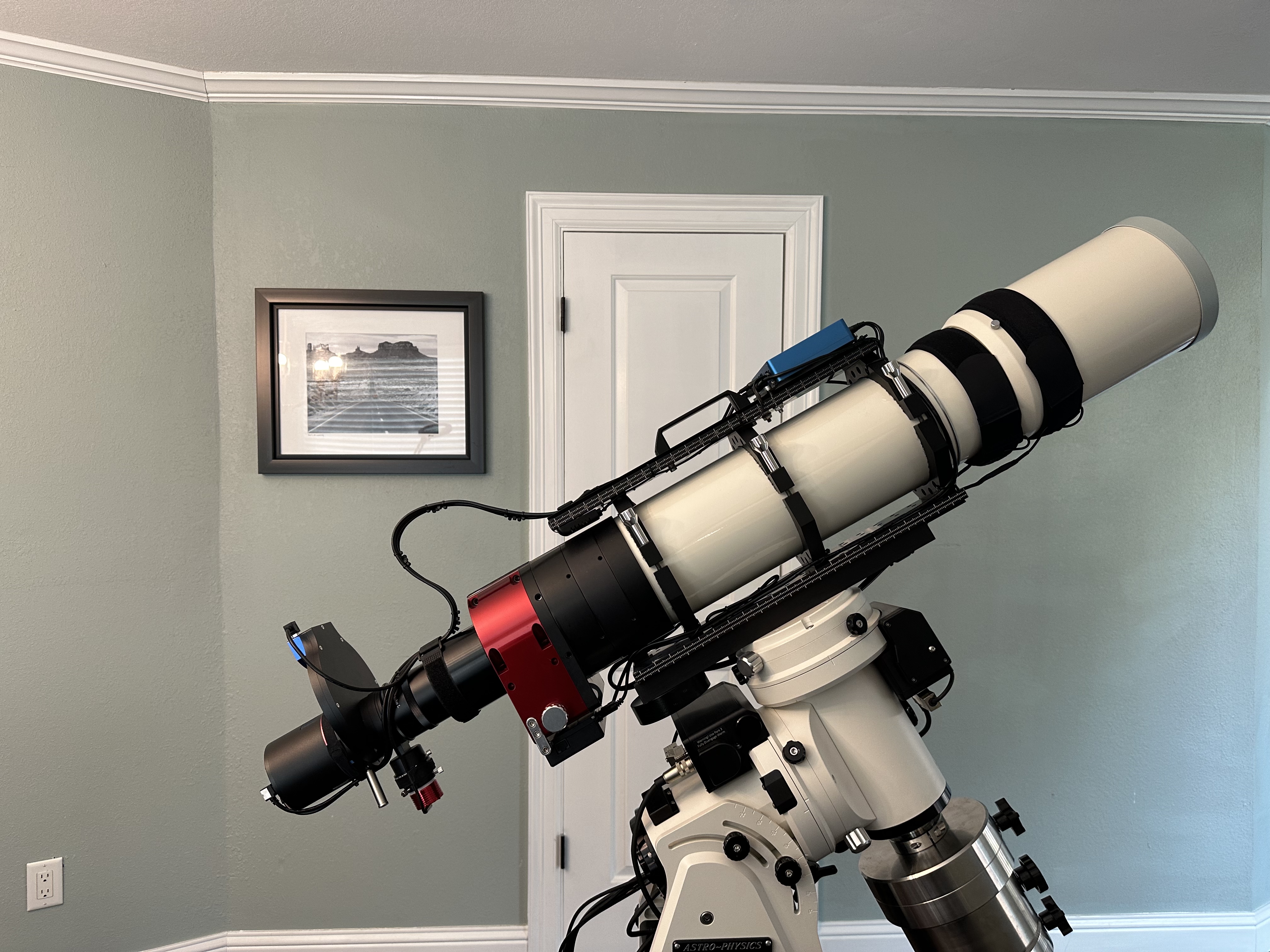

I'll add another recommendation for the NiteCrawler WR35. I installed a second 1.7 flange adapter in front of the focuser to reduce the length of the imaging train. There is a Precise Parts drawtube extender between the focuser and flattener. I have three MoonLite TOA tube rings sandwiched between two MoonLite dovetail plates.  |
