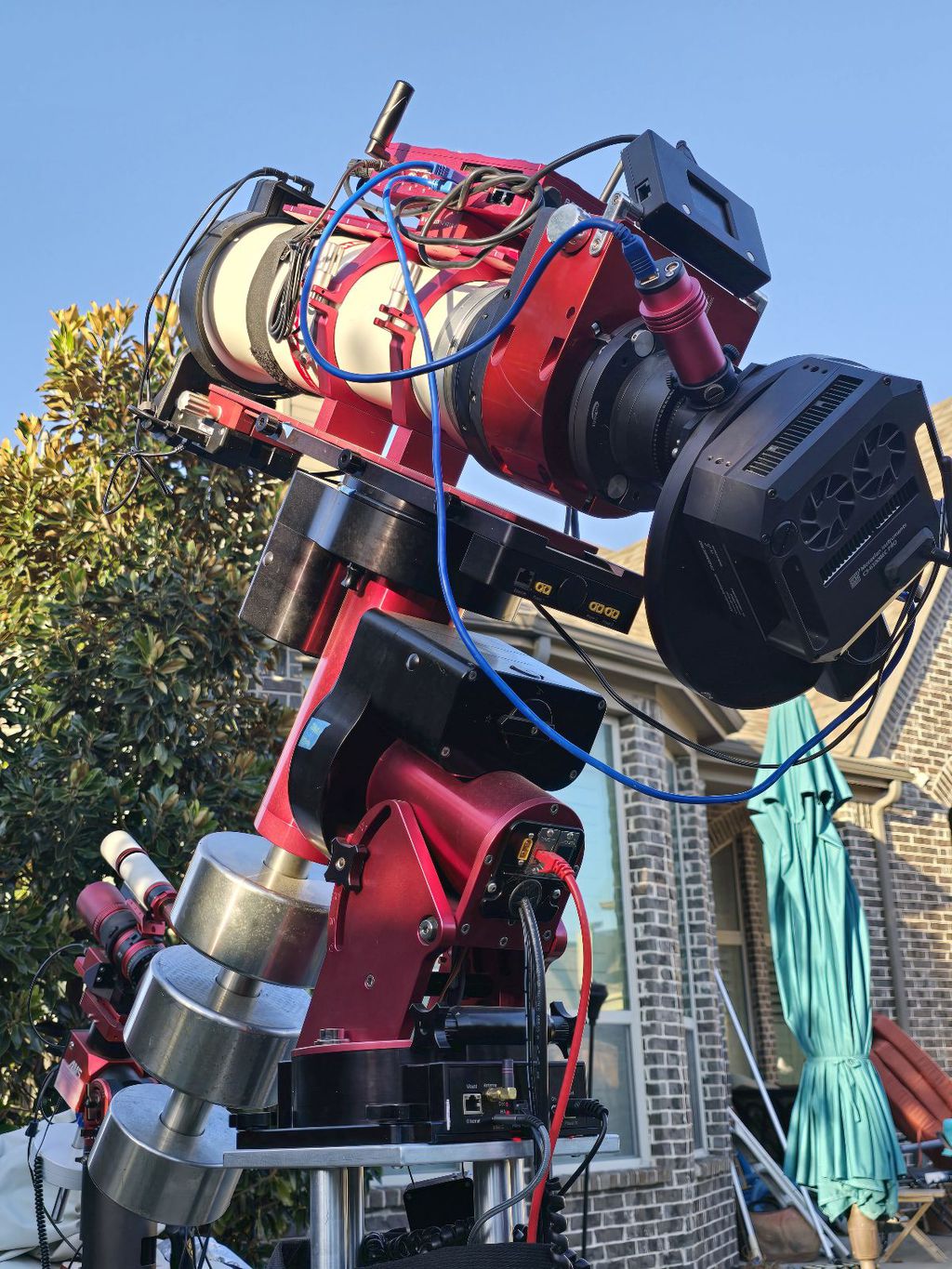

I'm considering purchasing a TOA-130NS because of the amazing published spot diagrams of the 645 0.99x flattener.
I'm looking for a 'galaxy' scope so the 1000mm focal length appeals to me.
I know that I'll have to replace the 2.7" focuser so I'm looking for options.   I already own a WandererAstro M68 rotator.
1.) $3.5k -- Moonlight WR35, great focuser but it's 2/3 the price of the scope which seems excessive.
2.) $2.2k -- Feathertouch FT3445B-A + Wanderer v2 M68 rotator + Oasis Rose electronic focuser
3.) $3.6k -- Optec Gemini, see comment from #1.
4.) $2k --  ESATTO 4" robotic focuser + Wanderer v2 M68 rotator
Here's a picture of something close to what I'm thinking.
I welcome any and all advice and comments...   what are your recommendations?

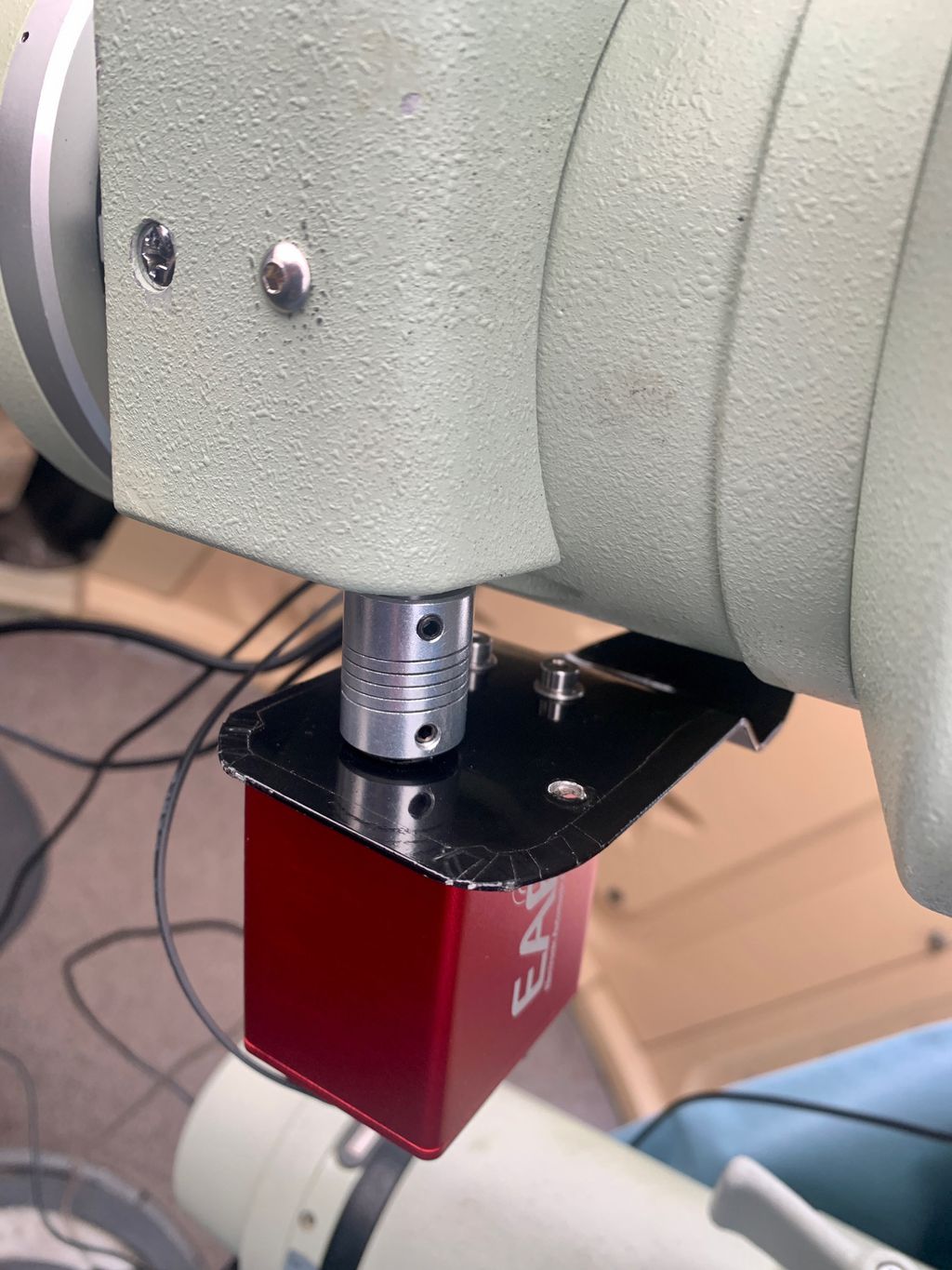

We went for a simple ZWO EAF Auto focus unit and have never looked back.
Cheers from Tasmania.

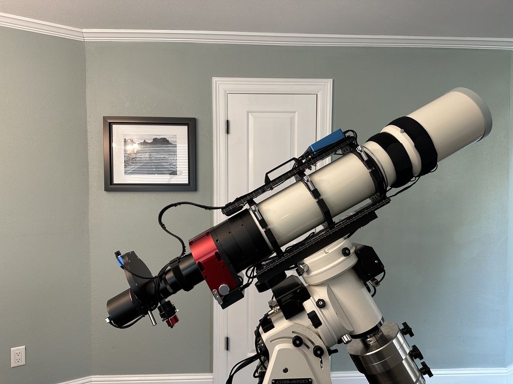

After using the ZWO EAF with the stock 4" focusur on my TOA-130NFB for some time, I ponied up for the WR35.  No regrets whatsoever.  It's rock solid, no sag, bombproof so far.
Worth it to me.  Plus, I can move it to my next scope if that day ever comes!
PS, I like that you're using 3 rings on your TOA.  I'm doing the same thing!

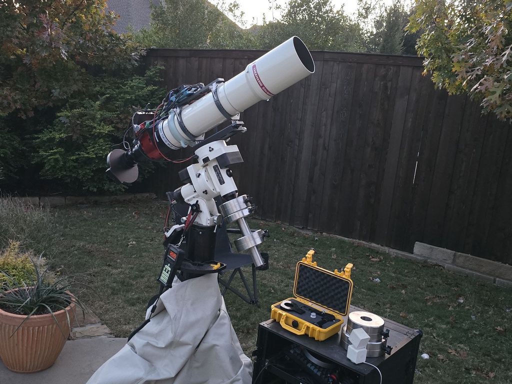

Since you specified "value" instead of "cheapest", I'll put my money where my mouth is.  I own a WR35 for my FSQ106EDX4 ($3,300 new with tax and shipping), I own another WR35 for my TOA130NS ($2,200 used, sent to Ron for a tune up for $100) and I own a LR25 for my EdgeHD 11" ($1,600 used, sent to Ron for $100 tune-up).  Any of my scopes that have any kind of heft to them get a Moonlite XRX5Focuser.  The ability to put in a call to Ron and get personal help from the owner of the company on anything also carries a lot of value.

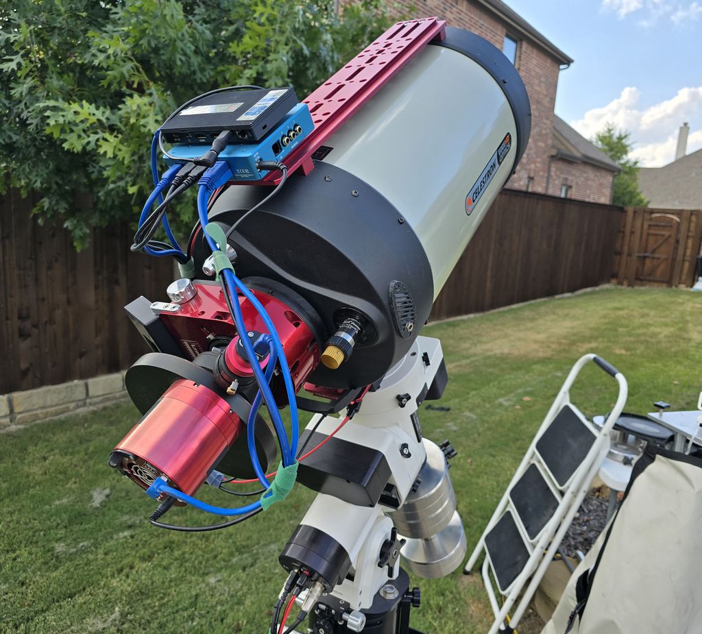

I’m sure you could get any of those four options to work. I have three WR35s on three rigs, including one on a TOA130. I also have a Gemini on another rig. Both are rock solid. I never even think about focus or rotation—it just works. I will give a slight edge to the WR35 because unlike the Gemini, it doesn’t require an external controller that has to be mounted somewhere.
Just FYI, the TOA with 645 is a monster. It’s the best scope I’ve ever owned. It uses a C5 with the giant medium-format 100-mpix IMX461 sensor. The field is perfect all the way to the edges. If seeing is decent, the FWHM consistently comes in at about 2.6, which means I can drizzle. That effectively turns it into a 2000mm rig with a 400-mpix sensor.

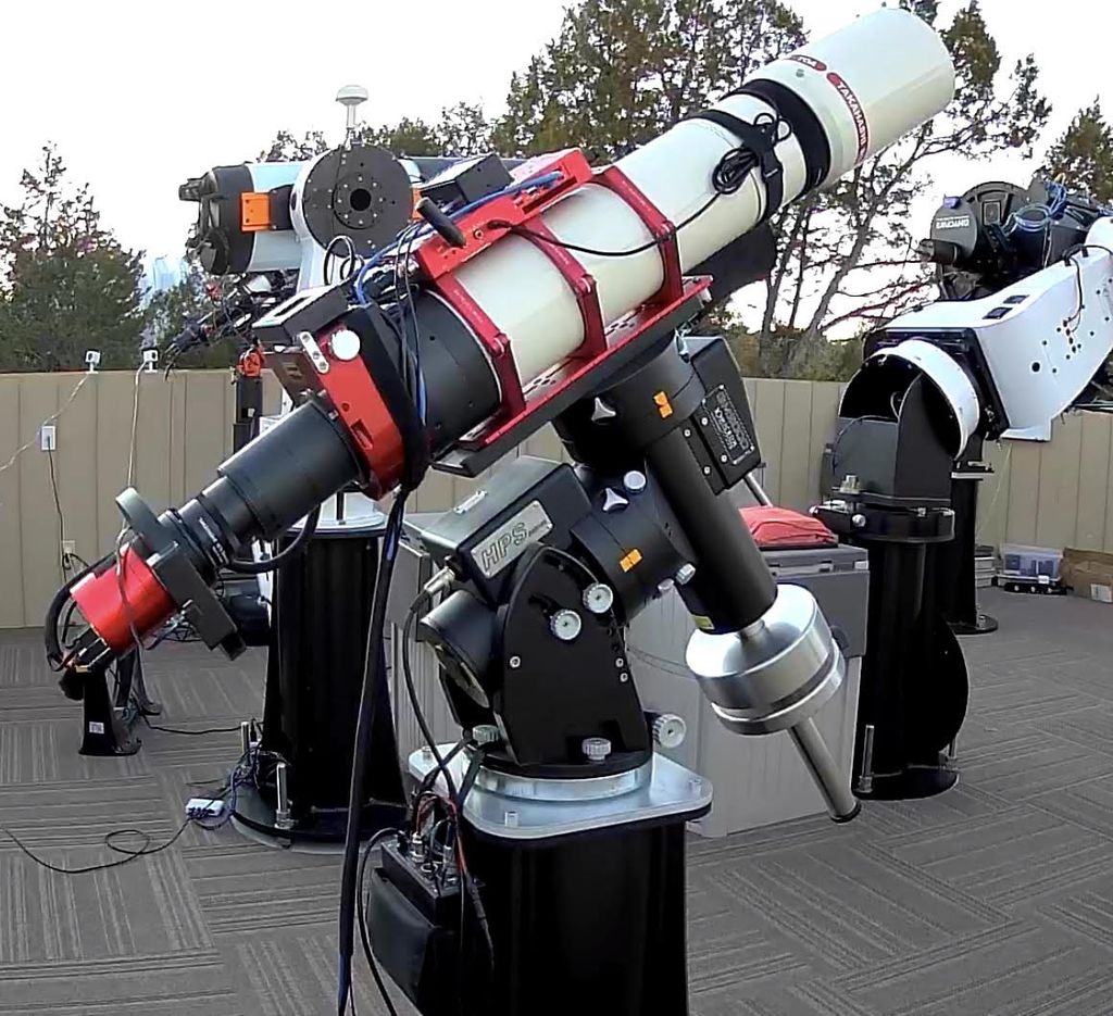

I'll add another recommendation for the NiteCrawler WR35. I installed a second 1.7 flange adapter in front of the focuser to reduce the length of the imaging train. There is a Precise Parts drawtube extender between the focuser and flattener. I have three MoonLite TOA tube rings sandwiched between two MoonLite dovetail plates.
