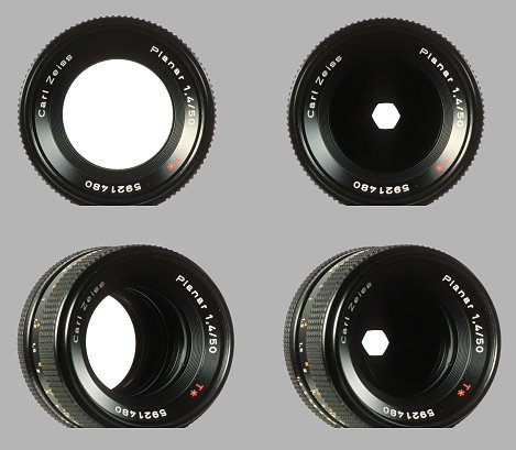

Yeah, this was the way to limit the iron cross effect on older star 71 scopes and all the recent 70mm F5, 90mm F5 and the new 60 mm quads that have the same effect...corrector small and too far up the tube to prevent mechanical vignetting diffraction. Fsq 85 has a tiny corrector. Stopping down the front lens aperture is the best way to deal with this, but it will slow the scope up a lot. The cat eye bokeh that causes the inverse lighthouse dark wedges seen here in a camera lens. When you look down the fsq 85 from the front and move the scope, you can see how much of an almond shape forms compared to a normal triplet.

Yes it is the reason. I know it's a quad, and if you read the post carefully, you ll see that I stated a triplet doesn't form as much of an almond shape when you look down it and move the scope from side to side, as happens with a fsq 85. With the focuser end unobstructed obviously.
Vignetting diffraction is the fundamental reason why the fsq 85 forms the inverse lighthouse beam, dark wedges etc. whose position (line bisecting the centre of the star and the collinear wedges) is orthogonal to the centre of the frame, all around the frame.
