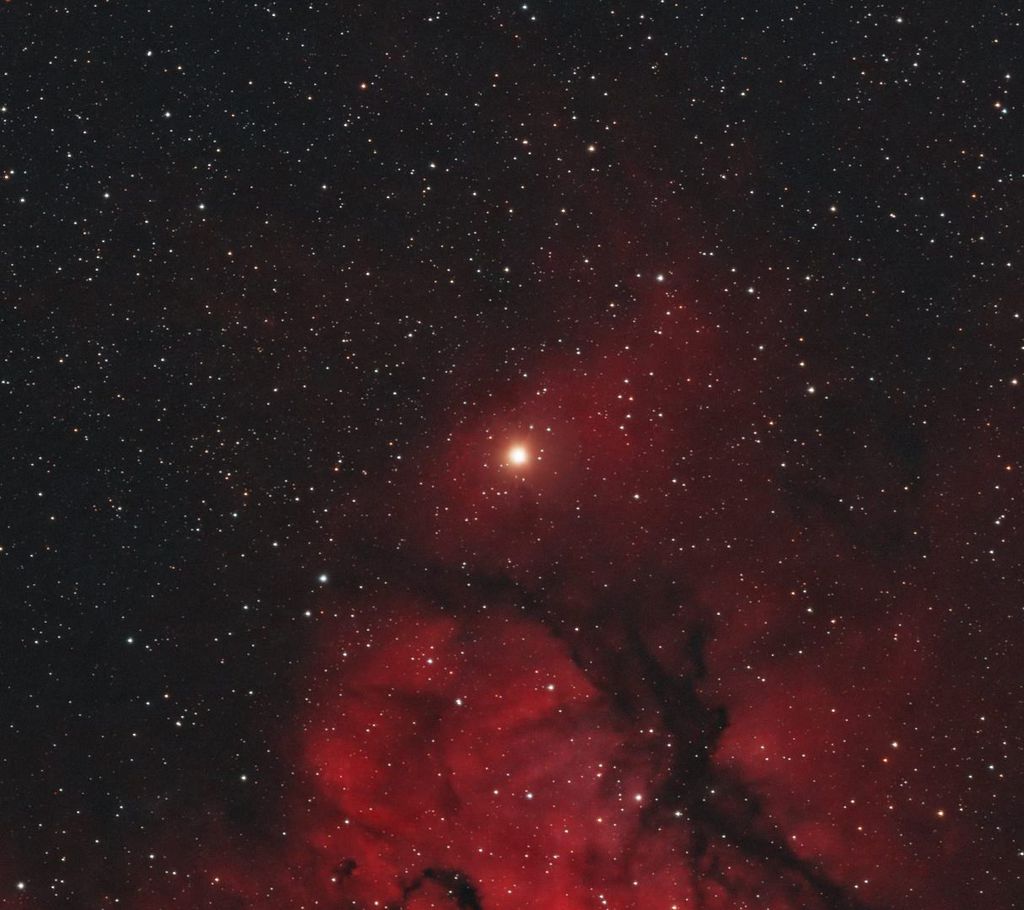

A way to fix the so-called inverted lighthouse or hourglass effect caused by the Tak FSQ-85 EDX on some bright stars Takahashi FSQ-85EDX · Bruce Donzanti · ... · 31 · 2131 · 8
umasscrew39 13.55
Many of us using the Baby-Q have seen the so-called inverted lighthouse or hourglass effect on some bright stars.  I discussed this with Adam Block on his forum and asked if he had a suggestion as to how to repair it.  He made a short video (on his Adam Block Studios website) demonstrating it using clone stamp and it works pretty well.   Here I fixed the star Tejat Posterior (Mu Geminorum) using a clone stamp technique.  Basically, you open up two versions of the image and rotate one 90 degrees.  Then center your pointer in the middle of the star on the rotated image and then move over to the image you are going to correct and click dead in the center.  Then carefully flare out from the center outwards to fill in the gap of light on one side and then rotate the first image again to the opposite side and do the same on your final image.  It is hard to explain this as the videos demonstrates it so easily, but once you try it, you will figure it out quickly enough.
Inverted lighthouse effect
Fixed using a clone stamp approach.  Note the correct color is also coming out.
Eteocles 1.51
Nice fix! This should also help with Rokinons that produce this effect.
aabosarah 9.31
·  8 likes
It is a good fix visually, but using clonestamp to fix anything rubs me off the wrong way. I know we use false color, enhance the image with deconvolution, process stars and background separately and stretch an image. But the one thing I feel I need to draw the line at when post processing an image is messing with the actual structure of the image / pixels by copying one part of the image onto another part, or creating objects that do not exist, like stars and nebulae. The only time I may use clonestamp is if I have a completely neutral background without any structure that needs to be fixed (dust mote in an empty region when stars are removed, or some neutral background errors).
For example in your image you can clearly see that you created stars that do not actually exist in the hourglass area that you were filling by copying it from the non affected region. I just don't know if it is worth the fix to create non existent stars in the final result. Would rather just keep the artifact if that is the only solution.
Just my personal preference, of course everyone has other tolerances.
umasscrew39 13.55
Ashraf AbuSara:
Well, yes, of course, we all have our tolerances on how we "doctor" up our images.  I never even liked false colorization but NB is better for where I live vs. RGB.  However, to your valid point: 1) this is weak fix if those funny stars annoy you; I am still up in the air about it but I found this an intriguing easy fix; 2) the extra stars (I only see two but maybe your eyesight is better than mine) could have been avoided if I was a bit more careful.  Adam specifically pointed this out as a possibility if you are not careful when using the tool.  It can be avoided by making sure you do not touch any stars from the image you are copying from.  So, I need to get better at this; and 3) for me, I see this less an issue on these very wide fields as the focus is almost always on the large area of nebulosity.  I would never even think of something like this using a scope on closeup images.  Like you, just my personal preference.
