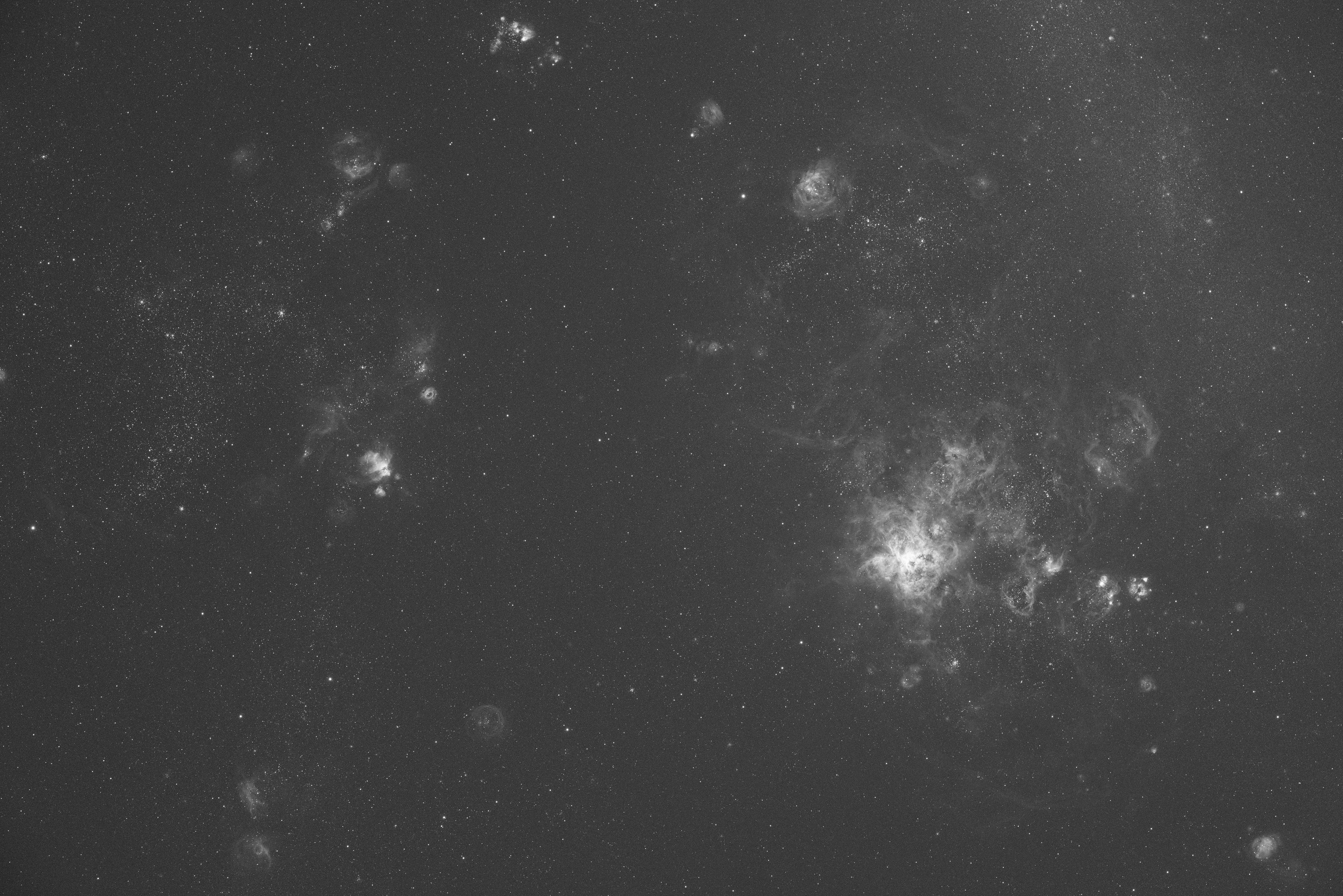

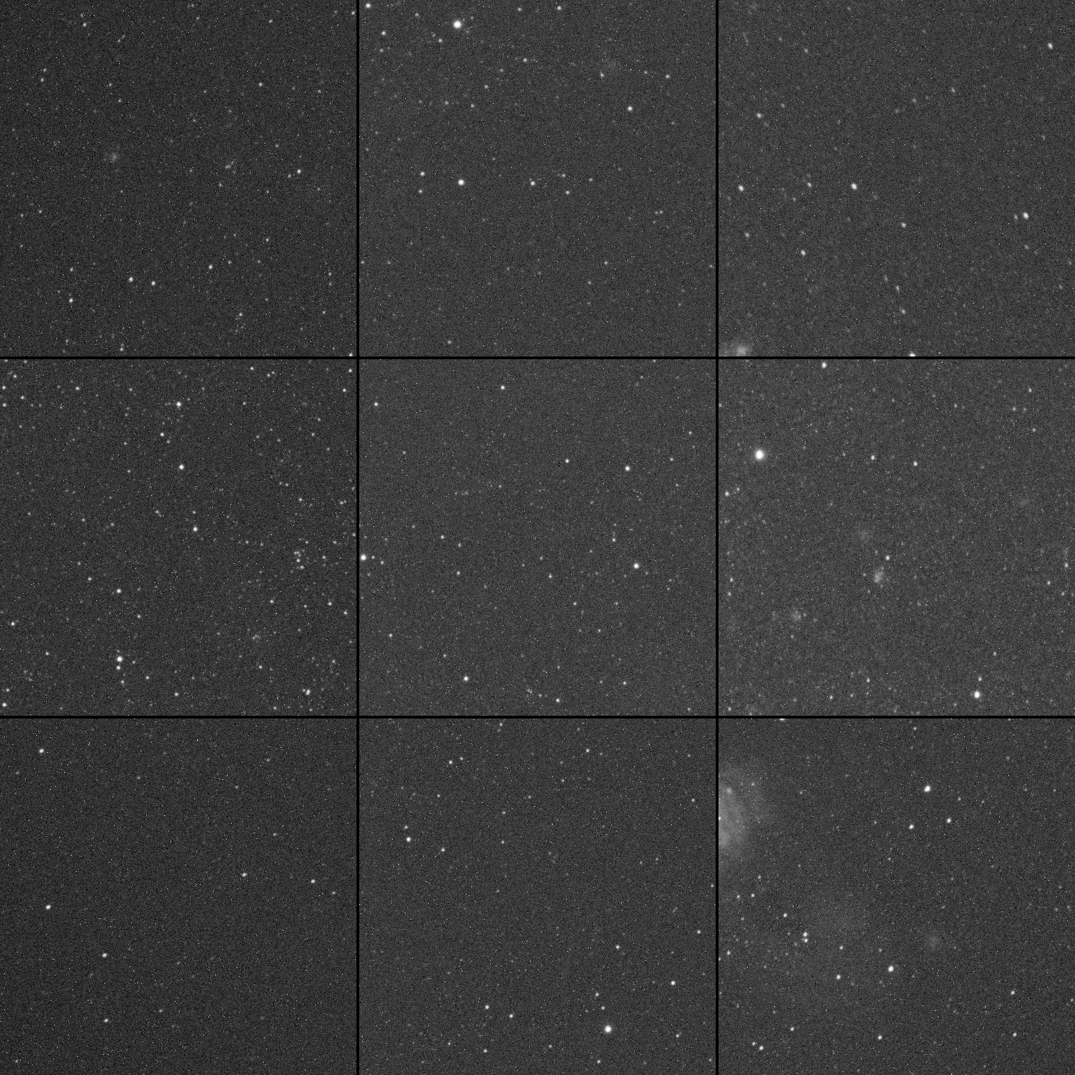

Do you have a test picture to show
Ola Skarpen SkyEyE: Do you have a test picture to show I will upload, thanks for the reply.

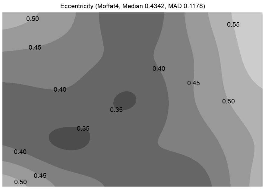

Test image: NGC2040 area; Ha filter; 300s; BIN 1x1  Corners (PI AberrationInspector)  Eccentricity plot (PI FWHMEccentricity)  |

Best Regards, Jacques * Hello Jacques, my system is similar: A FSQ85EDX and the QHY600. I have a tilt adapter in the image train. It took me several runs of HocusFocus and a few hours and the tilt was eleminated (2% according to ASTAP) However: When i changed the angle with the CAA i noticed that tilt was introduced back again and i had to start from scratch with tilt adjustment. As a result, i am not touching the CAA i.e. leave the field of view at a fixed angle. That causes no problem i.e. no sag etc. and tilt, once eleminated, stays eliminated. If your CAA introduces random tilt you should have it checked. CS, John
Just get rid of the CAA, it is unnecessary adapter in your rig. Get a custom adapter straight from M98 thread of FSQ-106 to the M54 of FW / camera.

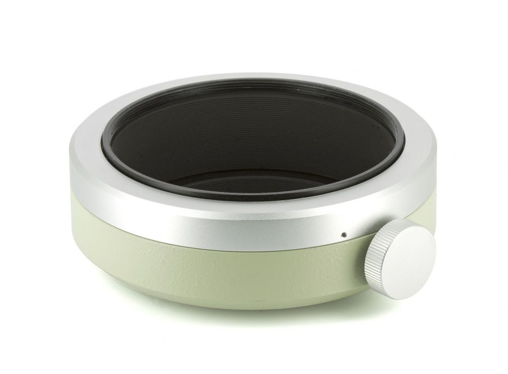

Bob Lockwood: FSQ 106’s are pretty solid scopes except one, it’s the one they put a captains wheel type rotator on, not the typical CAA. It was a bad design by Tak and they stopped making that model. It had a hard time re-centering itself when you locked it back down, very not repeatable. Not sure if it was the EDXlll or the EDXllll. Thank you Bob, I have the one below, I took mine off the scope, definitely feel some play in it. ![TKP30200CAA[1].jpeg](https://cdn.astrobin.com/ckeditor-thumbs/98771/2023/2e65ffab-985d-42c4-bb6f-bb605c0593c3.jpg) Hello Jacques, my system is similar: A FSQ85EDX and the QHY600. I have a tilt adapter in the image train. It took me several runs of HocusFocus and a few hours and the tilt was eleminated (2% according to ASTAP) However: When i changed the angle with the CAA i noticed that tilt was introduced back again and i had to start from scratch with tilt adjustment. As a result, i am not touching the CAA i.e. leave the field of view at a fixed angle. That causes no problem i.e. no sag etc. and tilt, once eleminated, stays eliminated. If your CAA introduces random tilt you should have it checked. CS, John Thanks John, Thats exactly what I fear will happen when rotating. Keeping the camera at a fixed angle is an option I also considered (maybe in the intrim)... but not ideal for framing. Nadir Astro: Just get rid of the CAA, it is unnecessary adapter in your rig. Get a custom adapter straight from M98 thread of FSQ-106 to the M54 of FW / camera. Yes, I see this is probably going to be my future... Think I will probably go the full 9 yards and replace the whole focuser assembly with CAA. Just an expensive proposition... Currently looking at the PrimaLuceLab focusers (Esatto 4"), looks very nice. The focuser uses a 'stop ring' adapter that facilitates camera rotation. I just dont know how stable these are and if it will be another weak point for sag/flex.   |

Bob Lockwood: FSQ 106’s are pretty solid scopes except one, it’s the one they put a captains wheel type rotator on, not the typical CAA. It was a bad design by Tak and they stopped making that model. It had a hard time re-centering itself when you locked it back down, very not repeatable. Not sure if it was the EDXlll or the EDXllll. It is the FSQ-106ED, the model that came after the Fluorite model. I never used the Captains Wheel and had installed a CAA on it instead. I used that for many years without issue. When I moved to larger format sensors I started to notice sag in my images represented as tilt. As an experiment I removed the CAA and the bad corner was gone. In order to get image orientation back I installed a WanderAstro WandererRotator Pro. It is amazing and guaranteed not to introduce any tilt. I have used a few times now and am 100 satisfied with it, so much I picked up the new WandererAstro Flat Panel V4-EC Here is my baby :-) I am the third owner (have had it for close to 12 years) and other than the CAA this has been an amazing instrument.  |
