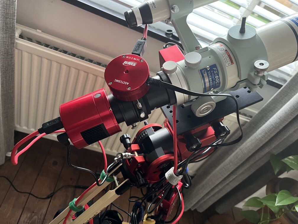

I have now reached the point where I have already been able to make some tests.
As I have indicated before, it is not easy to find adapters that are suitable for Takahashi.
Taking into account that I need to get a metal backspace of 56.2mm
I currently have a backspace of 57mm, but that can be reduced if necessary.
I have now purchased the following parts:
-Takahashi 0.72 reducer
-Zwo filter drawer with cls filter
-Zwo OAG
-ZwoEAF
-Zwo asi585mc
-Zwoasi715mc
-2mm Optique-Underlinden adapter ring
-Takahashi CAA
