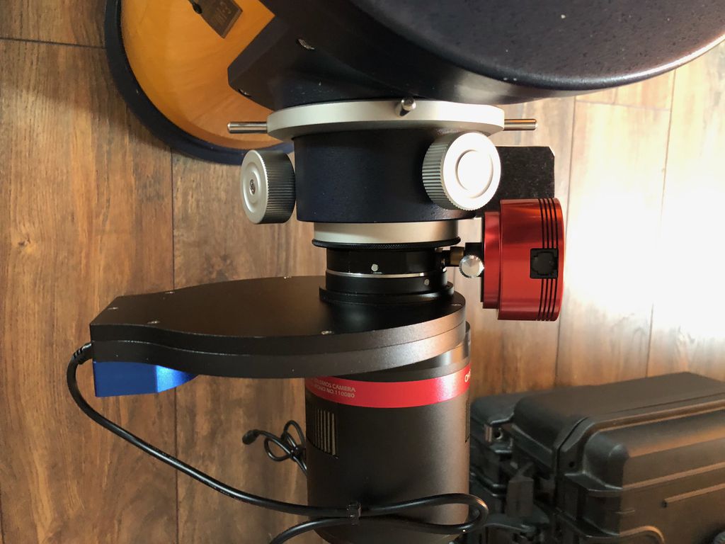

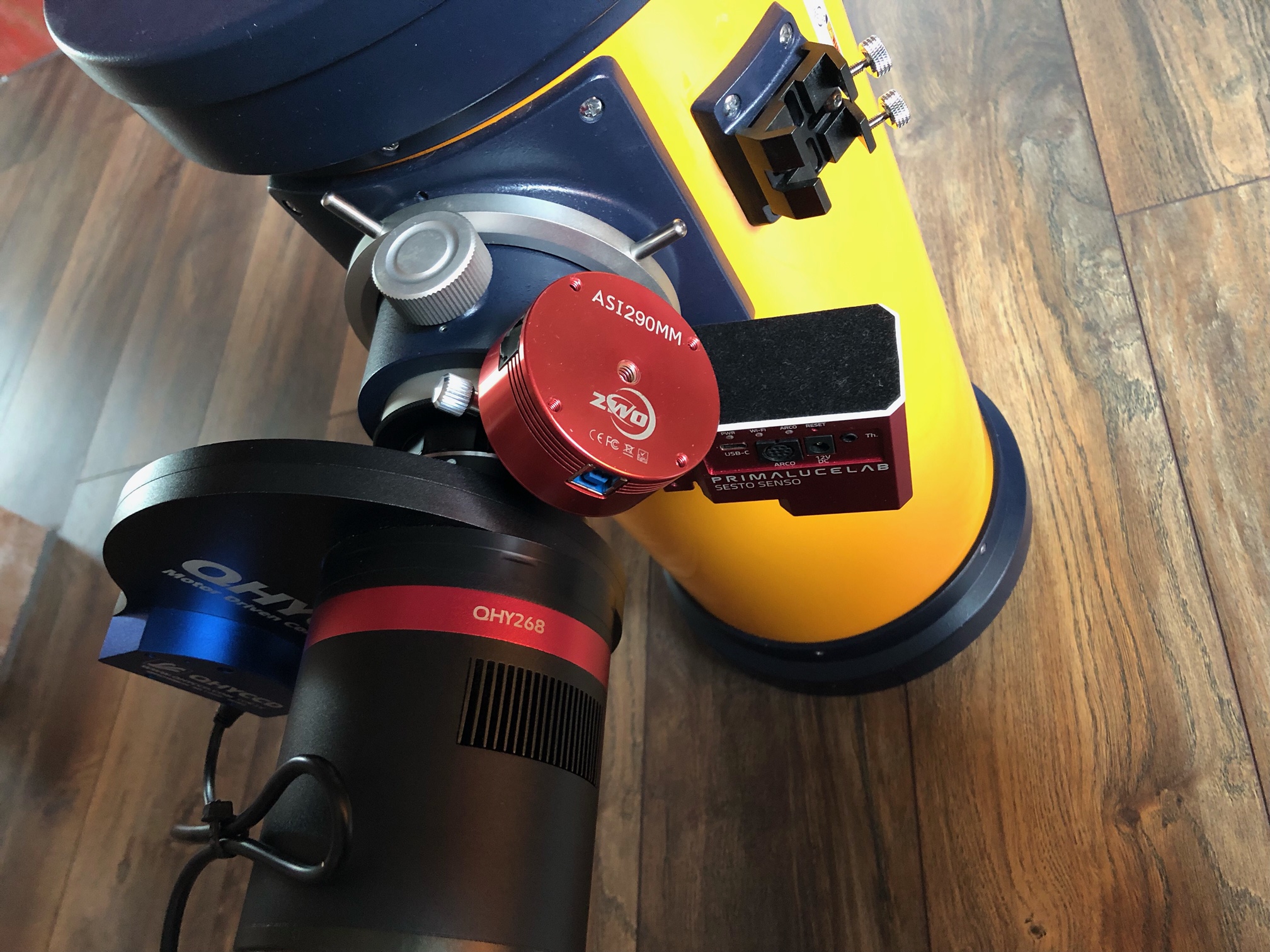

Simeiz 0.00
Hi Deepan,
I used my Epsilon 180-ED for astrofotography  in two ways:
1. Guidescope with 205mm  focal length and a ASI290mm guidecam
2. With TS-OAG and a ASI290mm guidecam
I tested very long with the image train before I came to the final configuration
My configuration with OAG is now the following:
QHY268m(12.5mm) + QHYUSFilterwheel(17.0)mm) + M54Spacer(5mm) + M54 QHYEOSBajonett(10mm) + TSOAG(10.7mm) + M48-M54-Adapter (Selfmade)(1.4mm) = 56,6mm.
The backfocus of my Epsilon is exact 56.2mm . Because I used astronomik filters with a thickness of 1mm I must add 1mm/3 = 0.3 mm to the Epsilon backfokus and came to 56.5mm.
Lights are corrected now perfect with pinpoint stars in APS-C and fullformat with my EOS 6da.
You can see the configuration on the added pictures
My other working on the Epslon is with  a small guidescope:
Here I connected the QHY268m with a WideMount EOS Adapter (TATKA00233). This Adapter has a thickness of 12.2mm and gives in my configuration a total backfocus distance
of 56.4 mm. The results are the same
Peter
