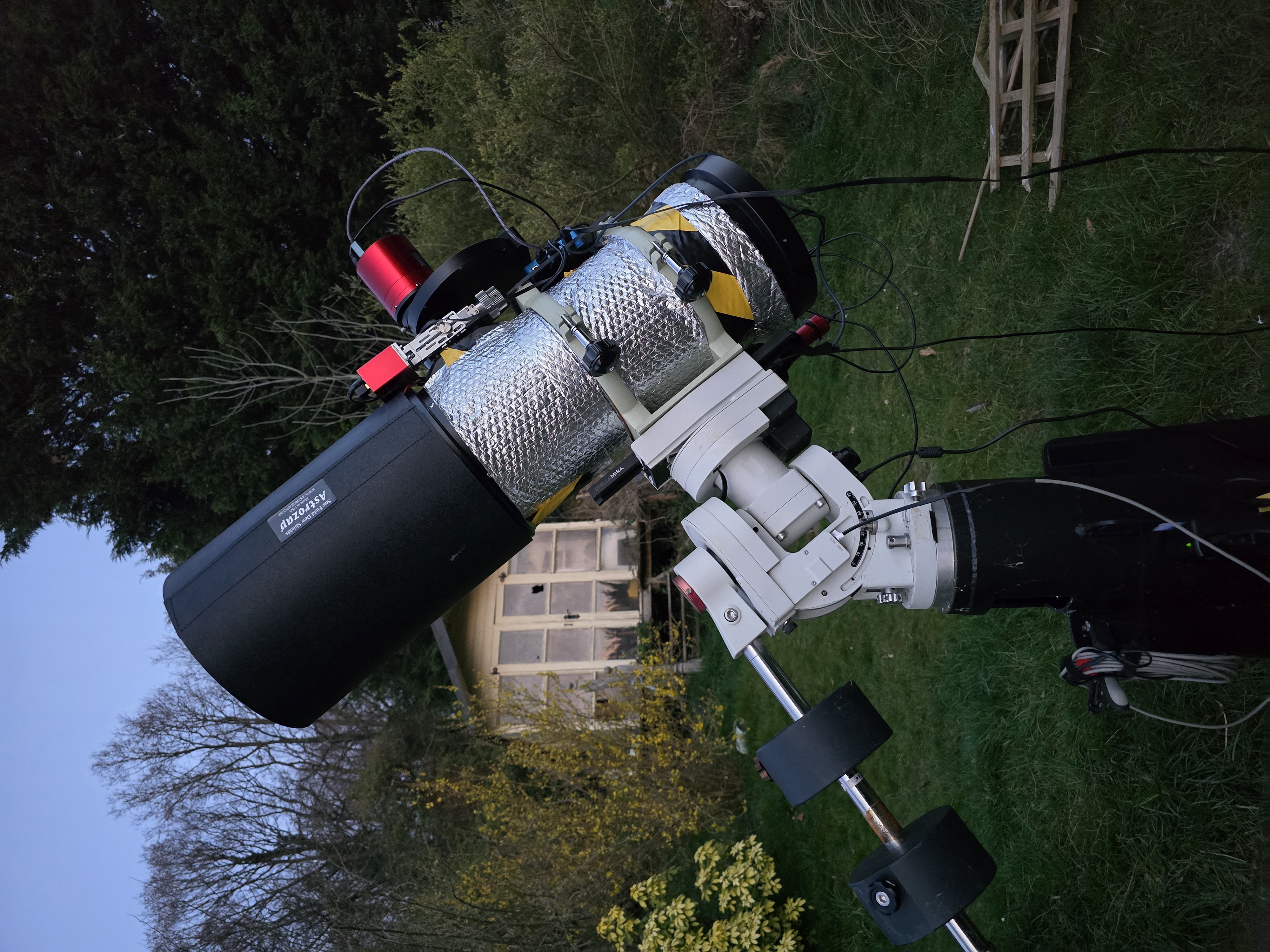

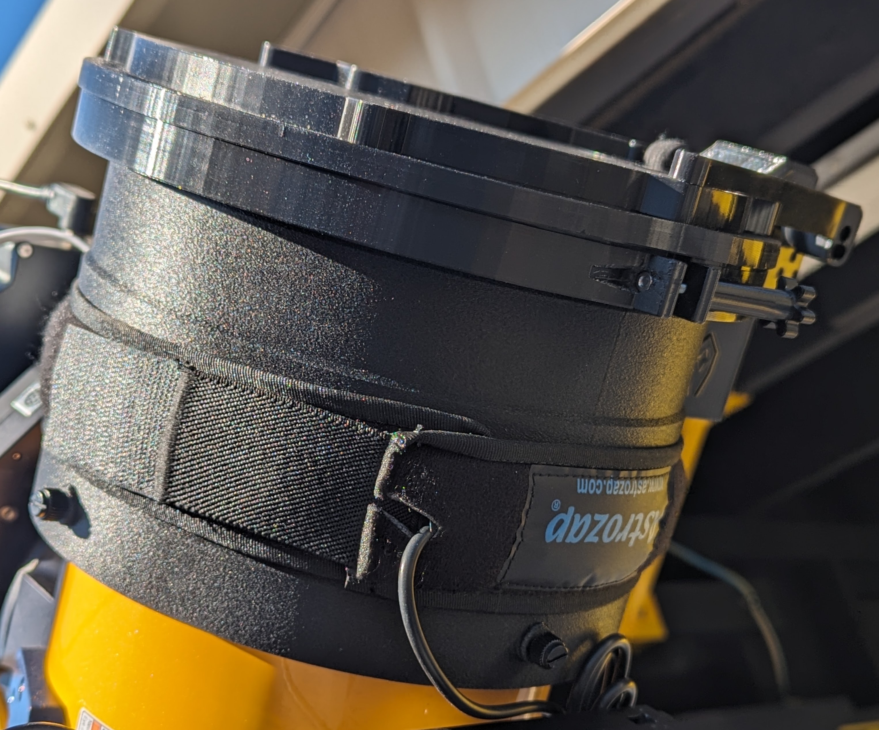

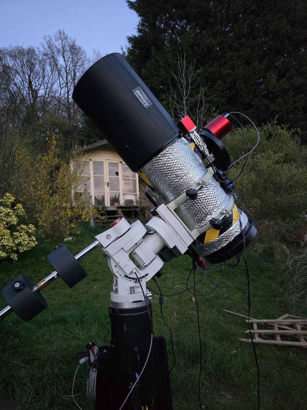

I installed a ZWO camera heater on the secondary mirror and control it via a Pegasus PBA. I also have a dew band around the rear of the tube but I'm not so sure its actually doing anything. Can see pics here: https://www.r3gdigital.com/blog/epsilon130prep |

*That is eactly what I meant. Kudos! Thanks every one. Great discussion, I am going with something like this. I have the Astrozap and reflective foam sheet, waiting to but the Fan.
I had issues with primary fogging up on my SCT aswell. This went away with the reflective insulation.
