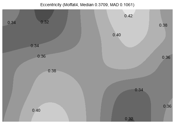

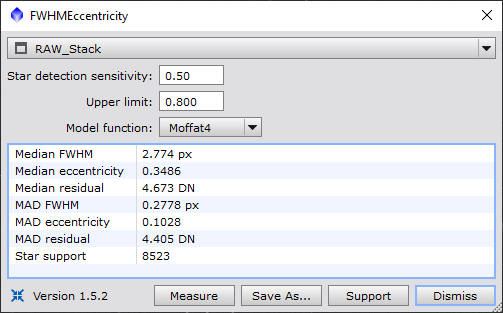

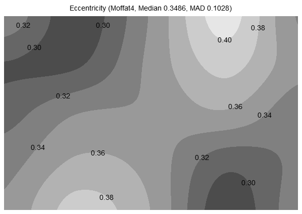

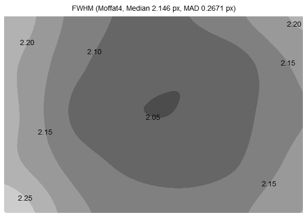

Overall, the field looks to be fantastic in the RAW Image. Much more orthogonal than the first night when I just threw it outside.
Running BlurX on the data, also looks great:
