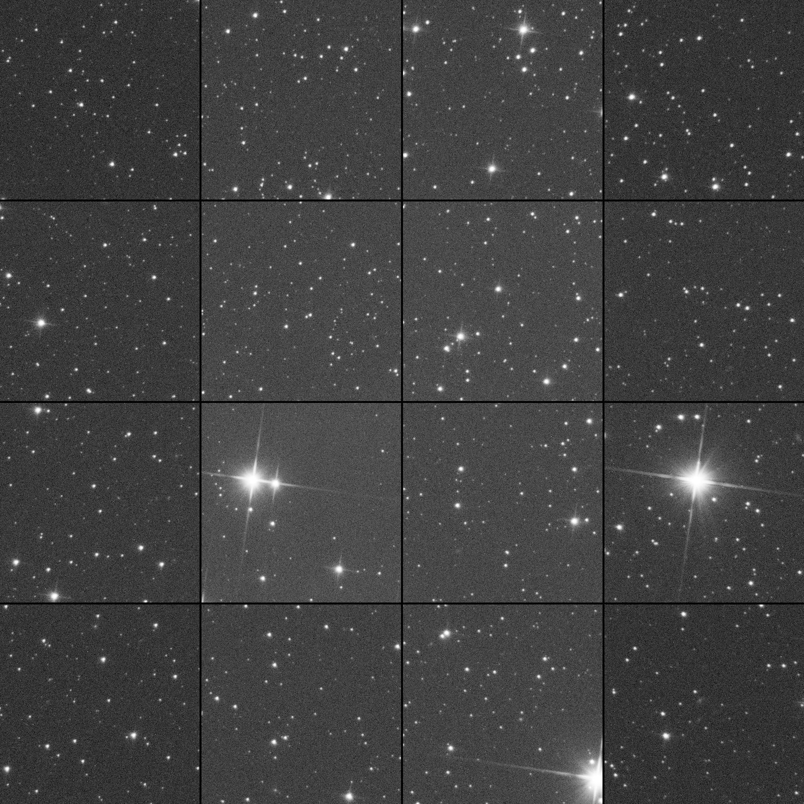

So I have been imaging exclusively with the 1.5x extender now for nearly a month from SFRO. I also made comparisons with the native corrector. My subs with the extender can get down to a FWHM as low as 2". With the native corrector it is closer to 2.4". There is definitely an improvement in details for smaller subjects compared to the f/3.3 corrector. I have already produced a couple of long projects with it. The real test is going to be when using it for galaxy season next year. I will try to squeeze as much detail as I reasonably can. Here are some examples from my recent projects:
https://www.astrobin.com/yu5xr7/
https://www.astrobin.com/60zy2u/
That being said I feel like it introduced some aberrations with a full frame sensor that I didn't see as much on the native corrector. The stars in the corners have odd diffractions, and I am seeing some halos on my bright stars in the middle of the field that I didn't see with the native corrector.
I still enjoy using it for now. I will swap for the native corrector at some point.
