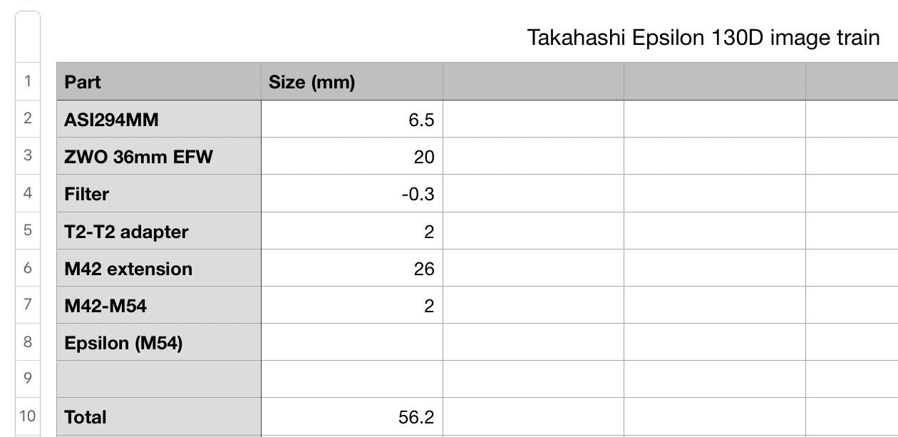

I've got the scope out tonight and I feel like i'm crazy because I can't retract enough to get in focus. I'm at 57mm backfocus with the optical train out from the corrector. I installed the focuser checked collimation after. (all looked good so far)
But now I'm bottomed out at 100 on the focuser. Any thoughts? It's the Optec Leo kit for the 160 that I installed. Did I miss something?
Backfocus should be 56.2mm

I could be wrong on this one, but I calculated about 57.2mm to be ideal given that my filters are 3mm. (they say to add 1/3 of your filter thickness to the optical train) Is that incorrect??
Should this be a factor though. I was guessing this is all prior to the corrector.

Are you sure your filters are not 3nm (which is not the thickness of the filter)? My filters are 1mm thick, so I add 0.3mm to the calculation…

back to your problem though: you say “this is all prior to the corrector” - the 56.2 is from where the corrector ends to the camera sensor (i.e. you can ignore the corrector completely in the calculation).
also, the optec does not change any of this as it’s identical in backfocus with and without.
heres how I have mine setup:
