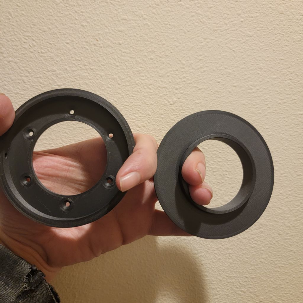

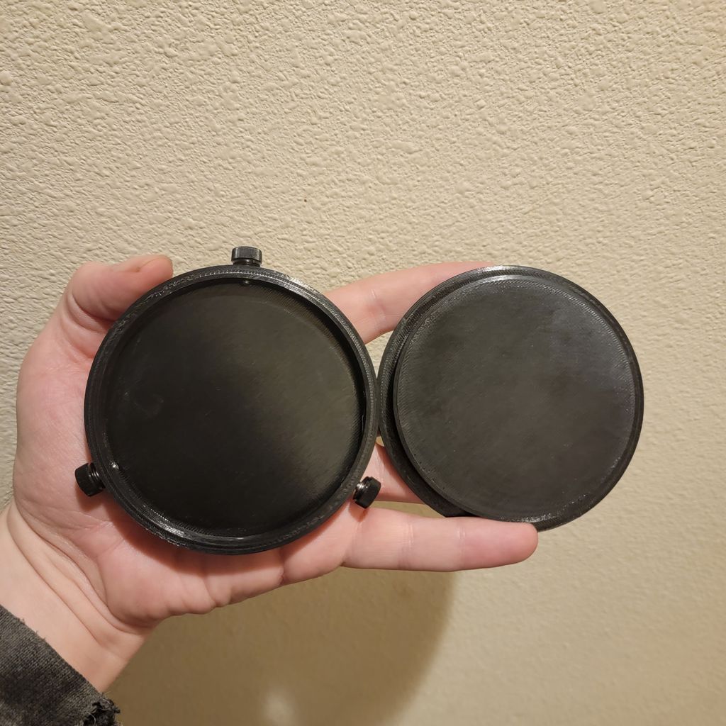

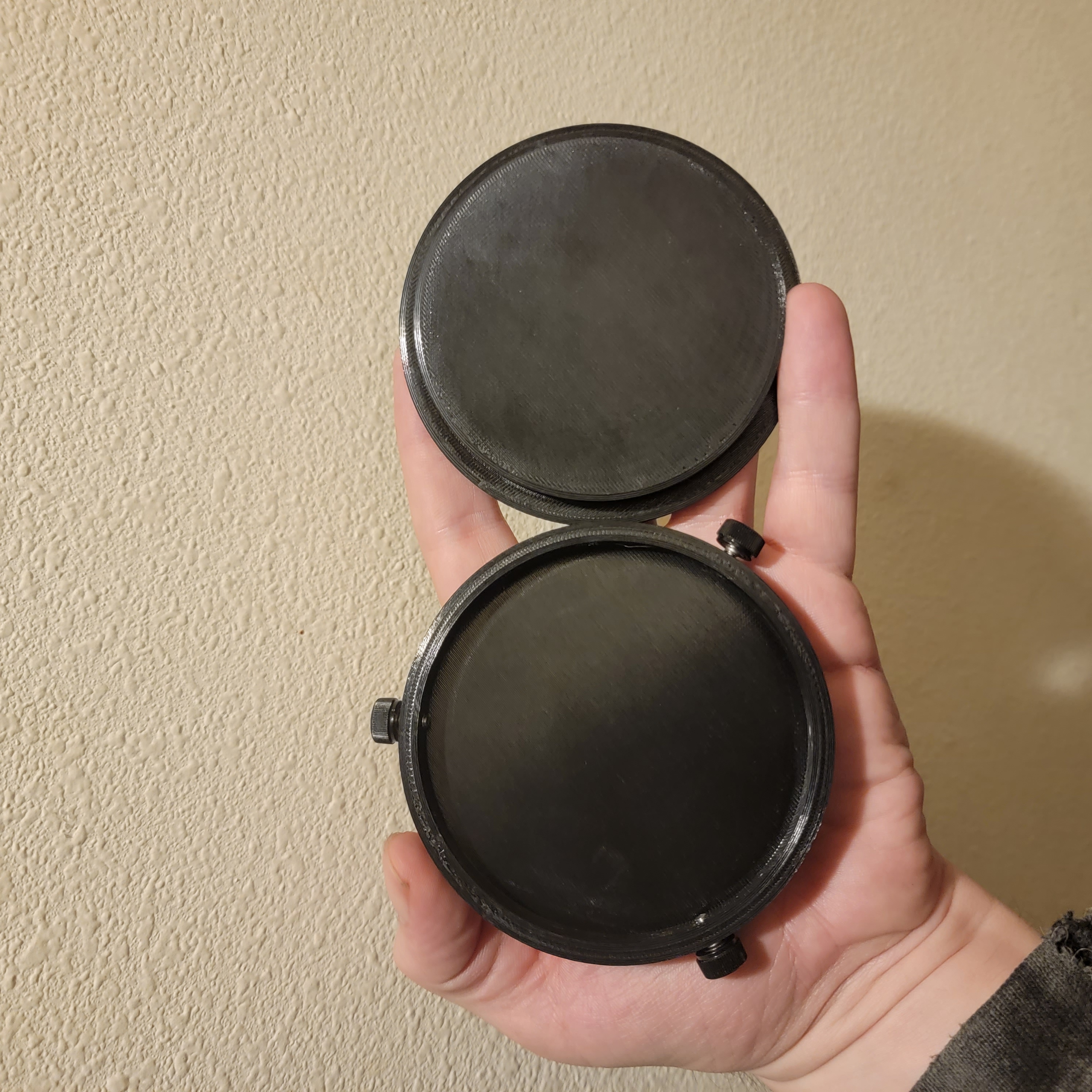

darkmattersastro 11.95
Here is a photo of the Lyra device before it gets tapped for the thumbscrews. On the left is the base that bolts to the wheel, on the right is our dovetail with a pre-installed M54 male gender changer ring. The native thtread is female M54 and is buttery smooth -- very much like machined, as we custom tuned the thread parameters meticulously and ensured that both Takahashi made adapters and Blue Fireball adapters worked flawlessly with either the female or male connection. Since M54 is not a standard metric thread, this was a ton of work, but worth it for a good product.
Here is a finished Lyra Cap Set that is ready to ship to its new home with Jeff. This is made in PETG and is intended to cover the Lyra dovetail and cap the camera when they are disconnected.
