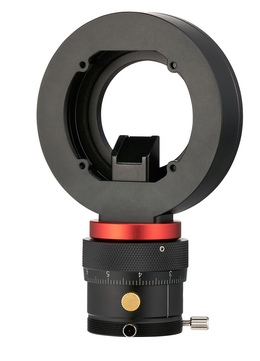

I am posting this here, as this product was developed with the E160ED community in mind first, and thus would be the right place for us to plant the first seed of the product.  The big announcement, for those that followed in the other thread, is that the price has been reduced for the Base Lyra from $200 to $125. We were able to obtain a good deal that helped reduce the cost of production of the device greatly. The custom spaced dovetail option has been reduced from $75 to $50 as well. For those unaware, Lyra is a manual rotator and quick disconnect system that supports QHY, ZWO, and Pegasus Astro filters wheels, as well as the QHYOAG and Pegasus Indigo OAG for connection. The base unit as it comes, only uses 12mm of backfocus. The dovetail portion of this, uses 1.5mm and can be made in any thickness larger than 1.5mm that you desire -- thus allowing you to obtain a very low cost custom spaced solution. The rotation and quick disconnect feature is incredible for framing your target and for making very small 0.1mm incremental spacing changes, as removing the imaging train no longer requires you to thread the entire thing on and off. Just loosen the thumbscrews and pull it right off! More information is here: Lyra Base: Dark Matters Lyra Base Unit | Dark Matters AstrophotographyLyra Custom Dovetail: Dark Matters Custom Lyra Dovetail | Dark Matters AstrophotographyThe updated photos and descriptions and product details will be in place by the end of the week. If you have any questions for me, just let me know. I have many units in stock and ready to ship. Thanks, Bill Long

Paul Wilson: Gosh I have been wondering how I am supposed to rotate the camera on my new 160. This is a must have! We tried all of the other options on the market and they did not work well, so we made this to solve the problem.  The big selling point on top of rotation and quick disconnection, is that you can order a custom sized dovetail to also minimize/eliminate the need for spacer stacks. That's great news. I love my Lyra and may buy another to permanently mount on my other camera.

Are there any pics or diagrams of your unit? Struggling to see how it works with OAG / Tilt plate adapter etc?
Sorry just saw your above post lol. Look forward to the pics.
Hi Bill
Are there any pics or diagrams of your unit? Struggling to see how it works with OAG / Tilt plate adapter etc? We are working on the photos.  The Lyra connects to your filter wheel directly or the OAG directly. It uses 10.5mm of backfocus for the base and 1.5mm for the dovetail it connects to. We can make the Dovetail in any thickness you want. Thus it can replace precise parts for basic adapter needs. -Bill
So these parts are plastic FDM? No issues with flex etc?
So these parts are plastic FDM? No issues with flex etc? The parts are made with a filament that is Polycarbonate with chopped carbon fiber. We do not use traditional plastic (ABS) as it's not strong enough. The parts do not flex, sag, etc.
I've worked a lot wit PCCF. It's very strong and prints very clean. You can make mechanical components out of it.

Cheers The ZWO EAF in the 2"/50mm model has holes on the back of the device that we can bolt the Lyra to with two of the bolt holes. The pattern they use is not the same as the one found on the QHY and Pegasus devices - but customers have had success with this without any modifications needed to the Lyra. The ZWO OAG does not have a compatible set of holes we can bolt onto, and if we enlarged the device to accomodate the pattern they use, the Lyra would collide with the helical focuser. A workaround for this could be to have a M54 female thread at the center of the Lyra which a customer could use a 0mm gender changer ring to connect it to the OAG plate ZWO provides with the cameras. The QHY and Pegasus wheels and OAGs work perfectly with the Lyra as is. The Omega tilt correction device is still in development, and we completely changed the design about halfway through. We are not sure yet on the ETA for completion of it.
Thanks Bill I don't really want be buying new OAG's and filterwheels if I can help it - it's not the sort of spending we like to do in astronomy, right?  . I have a 5 position filterwheel, and as this is OSC that is more than enough. The size of the EFW is important for portability (think: air travel). Huge 7 filter wheels are harder to fit in to flight cases which have a max depth allowance of 25cm on UK flights. I think I would really need to try and make it work with the current OAG and EFW - and if it was not acceptable performance, then look to swap gear out. It's difficulty for me to envision the problem as I have only seen some random customer shots of the Lyra, but would it not be possible to "jut out" holes on the 3D print to accomdate rather than increase the whole diamter of the Lyra? I am possibily misunderstanding you but as I have not seen the device it's hard to imagine. Excuse my crappy sketch:   |
No problem. The Lyra would bolt to the other side of the OAG. That side is where a user installs the tilt ring from the camera face. The holes that tilt ring bolts into would require a larger diameter Lyra, which would get blocked by the helical focuser. The 4 hole pattern you show in the image can be used by the Lyra (2 of them anyhow) but that's on the filter wheel itself and the opposite side of the OAG. The direct connection to the wheel works fine with the current design. It's the OAG from ZWO that's an issue.
I have one of their OAGs here and I have yet to find a way to make this work with it.
Ok Bill, I do want to make this work. Perhaps I can just replace the helical focuser if that is the issue. I think I need to wait for your images on the website to see how this all goes together before I make plans. To be fair, snap shots will probably do if you have some (especially agains the ZWO OAG).
