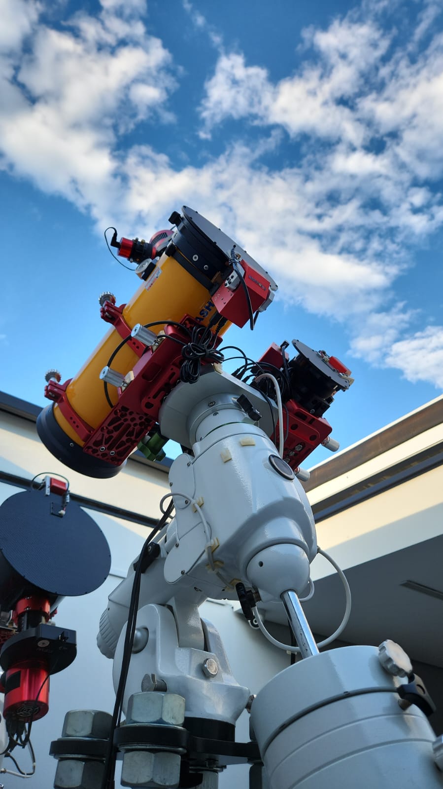

It delivered very sharp images for months without any problems. I used to leave it covered with a proper telescope cape and under a sunshade to block direct sunlight during the day. I wouldn't leave it in rainy weather though. I'm telling this because I think heat is one of the major contributors to the problem. As I leave in Brazil, we have hot days throughout the entire year, getting up to 40°C on some few. The telescope would reach a temperature higher than ambient (maybe 45-50°C, I estimate), but I never thought it impacted it in any way, as it is very well built with high quality materials. However, heat in excess seems to be able to soften the glue that is used to fix some pieces of the focuser together, and the fact that the weight of the camera and its accessories are making pressure on those pieces all the time, made the glue rip and the pieces to slide in opposite directions (friction) every time it auto-focused. It is a slow process and you don't notice it until the focuser is done and unusable, as it collapses after both pieces lose contact.

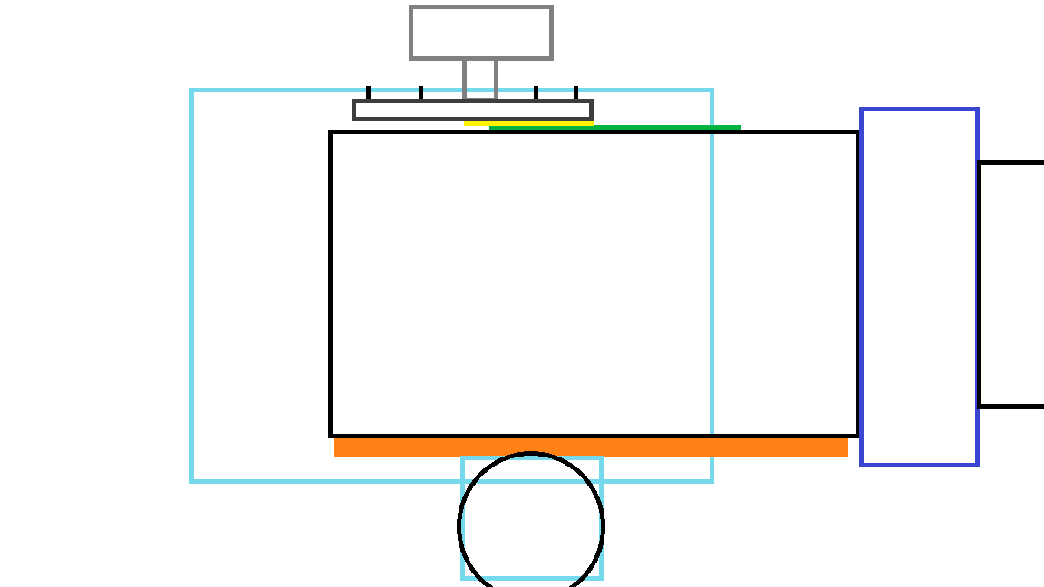

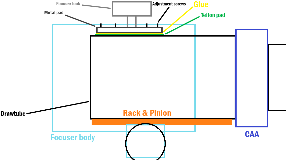

Focuser diagram:
(Note: the image may not be accurate and there are two fixed drawtube supports points that I chose not to show to not confuse the diagram)

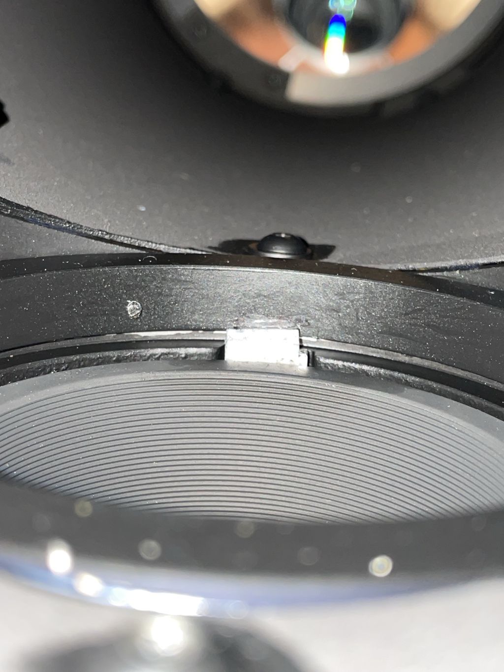

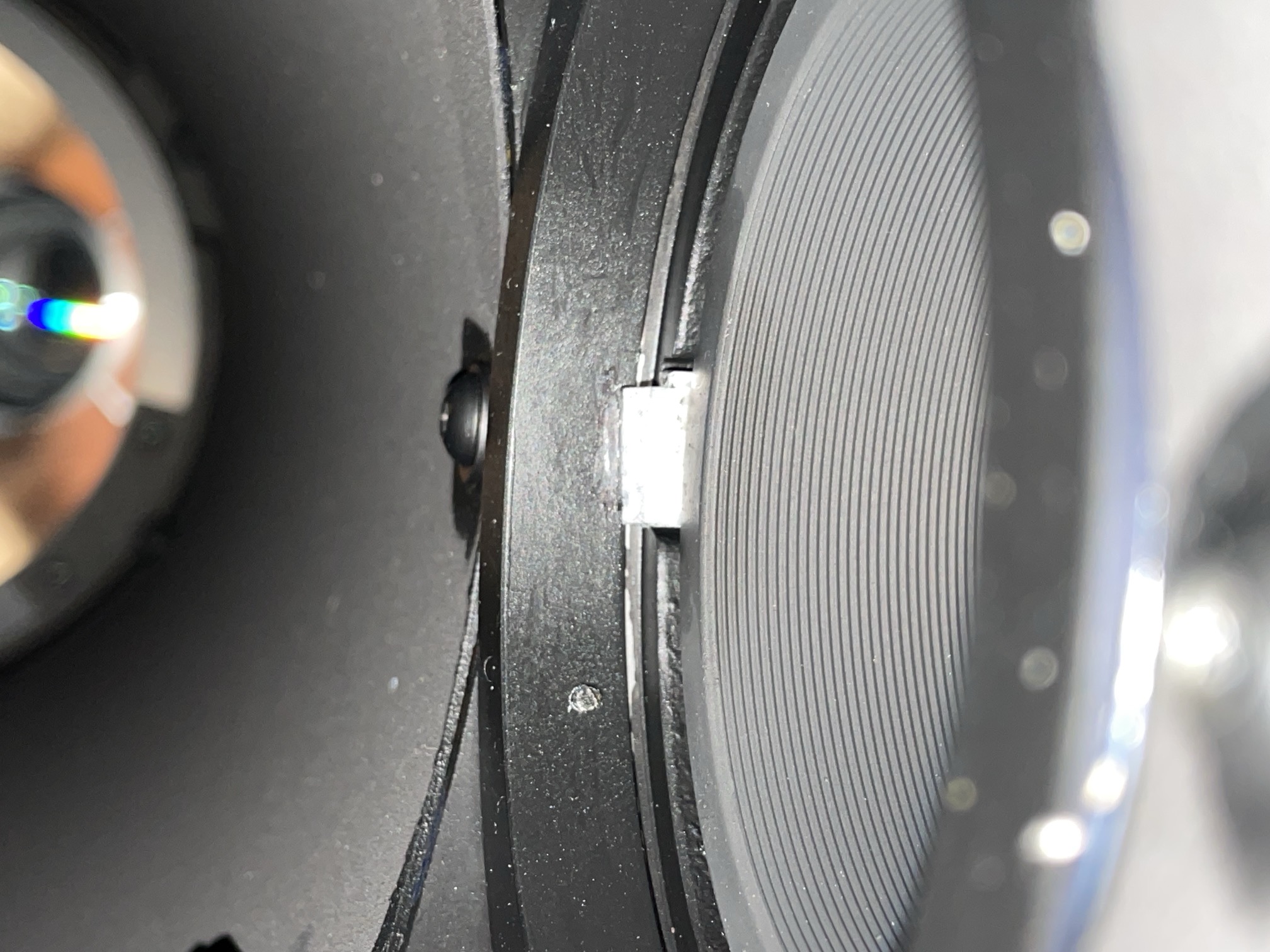

The problem:
Glue is ripped off from between the teflon pad that accommodates the drawtube and the metal pad. The teflon pad is dragged out of the its original position due to the friction and starts to appear on the outside. When there is no more contact between the teflon pad and the metal pad, massive tilt appears in the images and the drawtube can lock because it is not parallel to the rest of the focuser body anymore. It is worth to highlight that it took several months on hot weather for this to happen with my FSQ, so it is probable that it takes year for this to happen in a colder environment.
The solution for the FSQ85 focuser was to glue both pieces together again. I don't think it is a permanent fix though, the ideal fix would be an upgrade to a feather touch or similar.

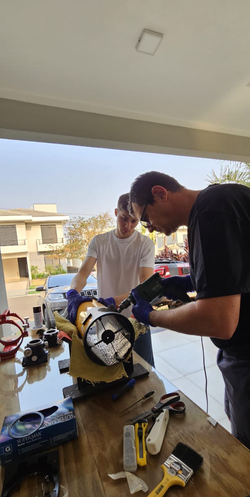

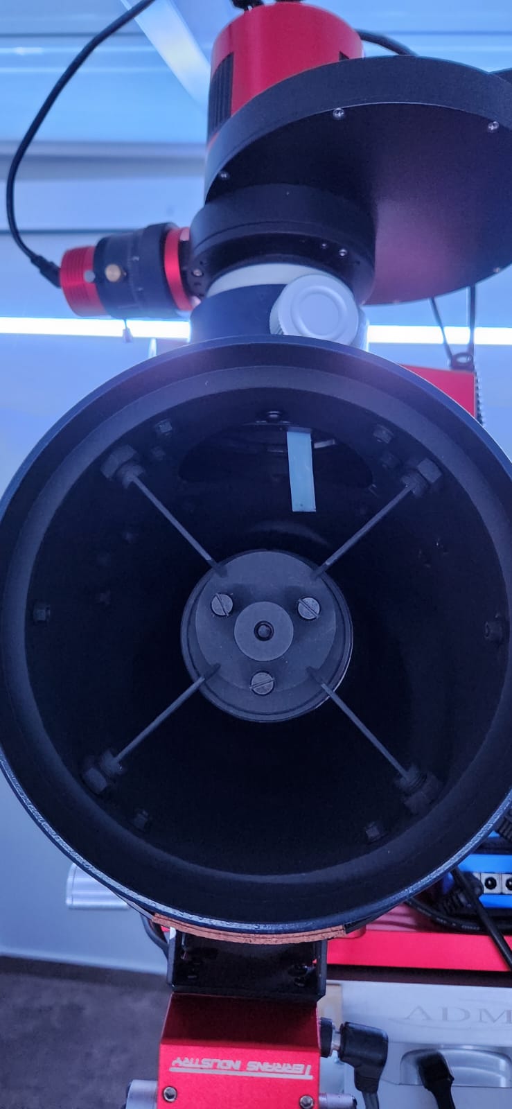

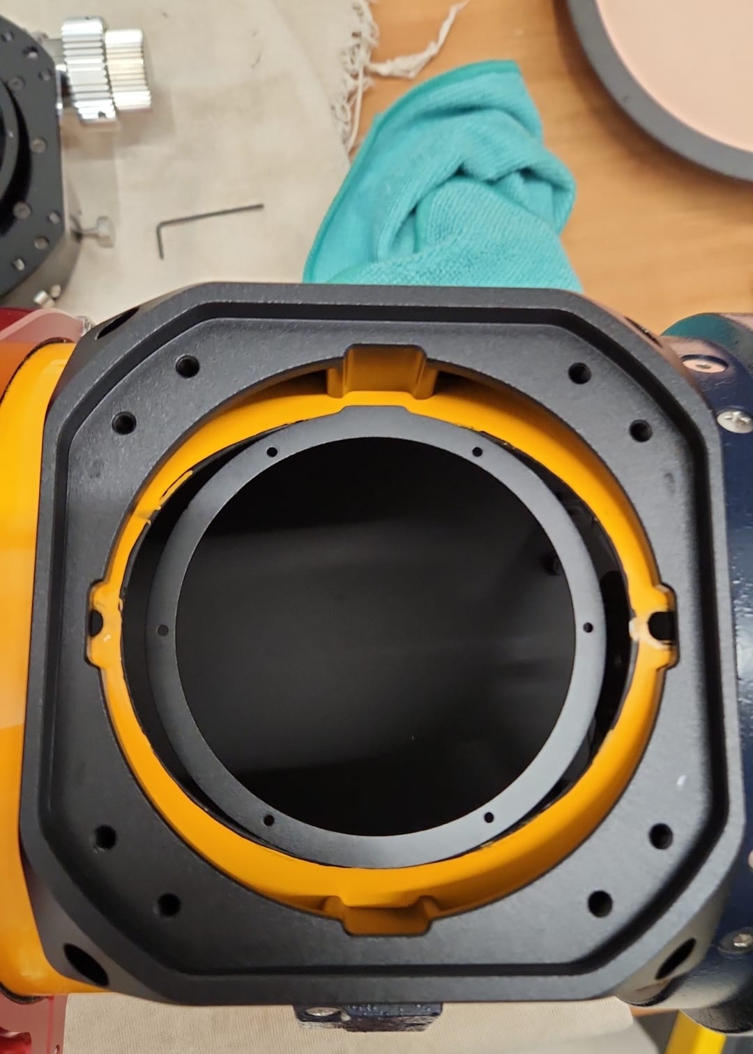

When I bought the E-130D, my second Takahashi telescope, I was already very aware that the stock focuser is not ideal for the precision that F/3.3 requires for sharp images, so buying a new focuser was in the plan and an eventual problem was expected. At that point I already had an observatory and I thought that having a much cooler environment would help to preserve the focuser long enough before I could buy an upgrade, of at least one year.

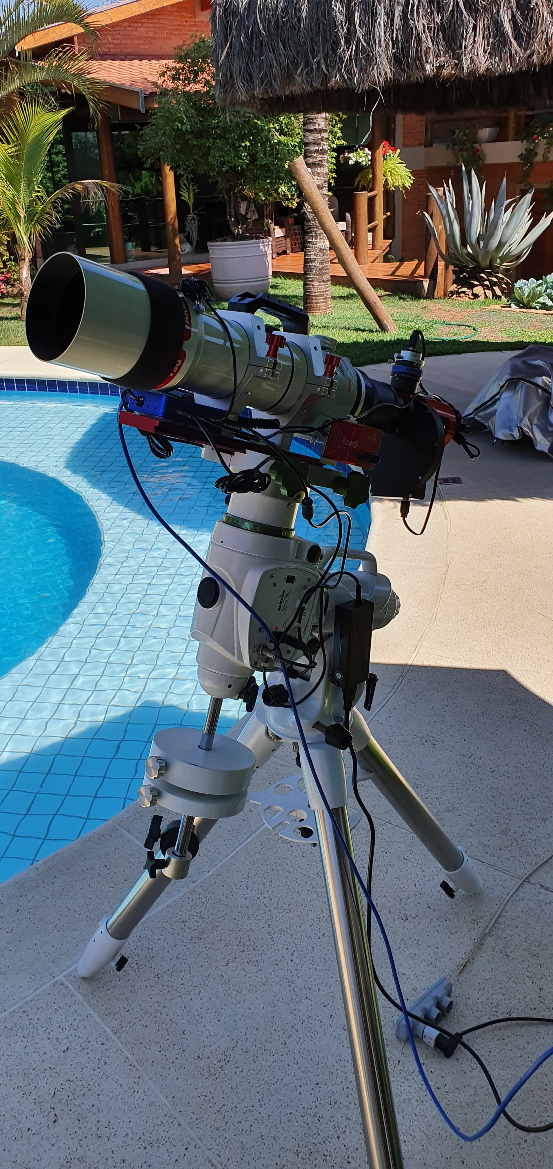

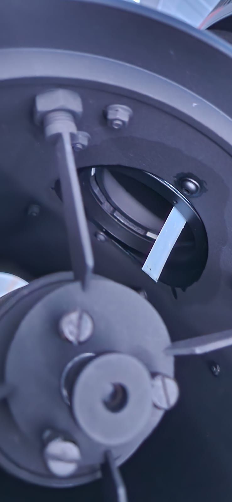

However, the problem happened again, and much faster than I was expecting. It took only 6 months for it to collapse while being exposed to 30°C inside the observatory, much cooler than what the FSQ85 sustained for much longer. And again I had a paper weight telescope and had to spend money much sooner than I originally planned, which is a quite disappointment, considering how much money we spend on these things and how inaccessible they are over here in South America. I still think the heat was a problem, but the weight should be considered as well.

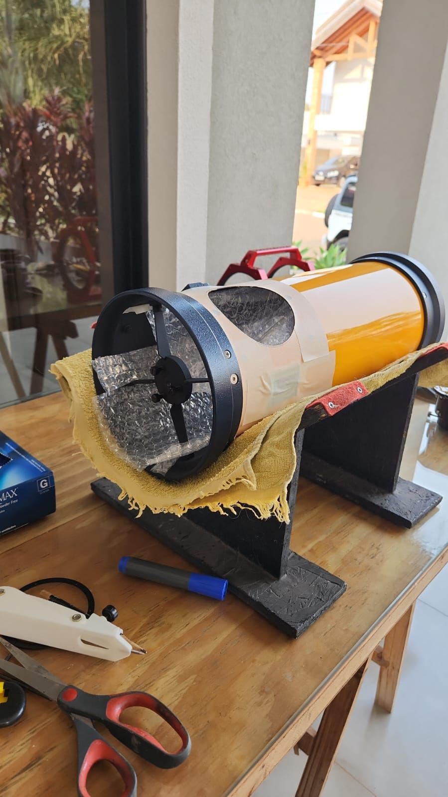

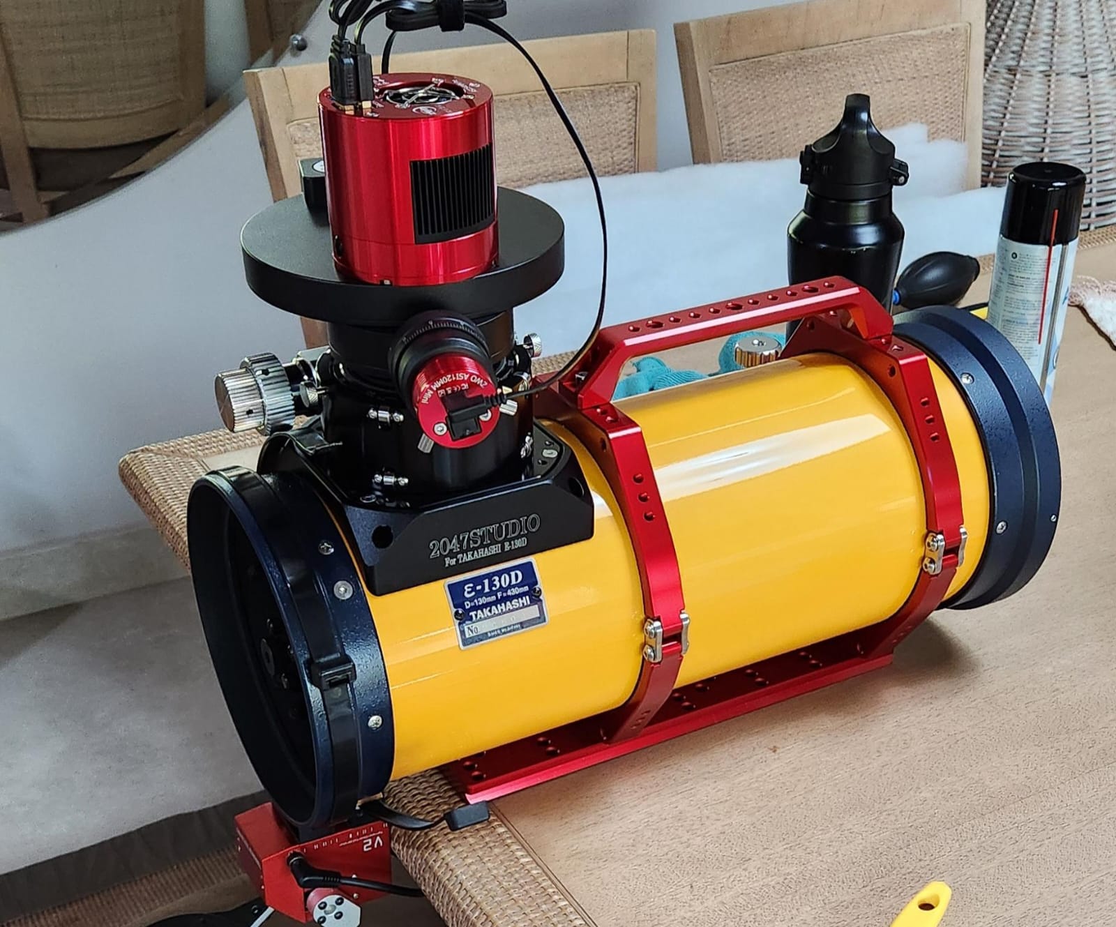

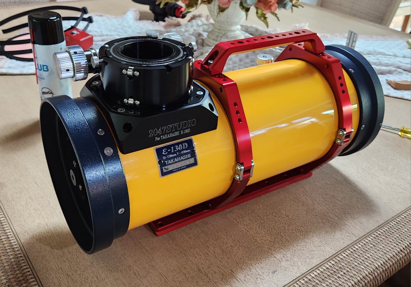

The solution this time was to replace the focuser entirely. In a perfect scenario I would have chosen the Optec Leo, but that is way outside my budget (considering the import fees are as high as 100%, not considering other shipment costs), so I bought a 2047 Studio focuser upgrade for it. I liked the quality of the new focuser and I believe it should be a reference for minimum standards (for Epsilon telescopes at least, which are very sensitive to misalignments). Is is also very well thought to not use any glue or anything that can decay in the long term, just stuff made of metal and adjusted by screws.
It just required some modifications on the OTA... I won't elaborate on that because it is off topic, but I can explain what needed to be done to anyone that considers this cheaper option.

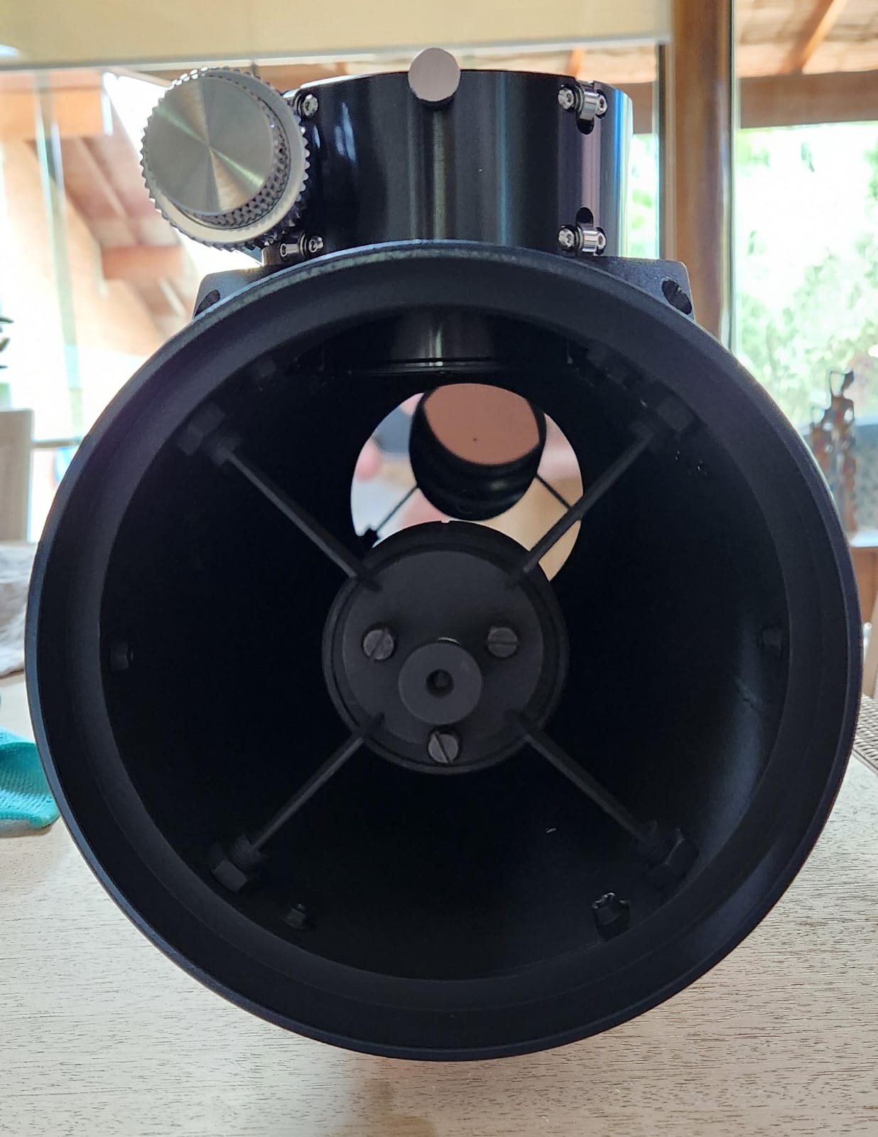

Sure!! The 2047 Studio focuser I bought is compatible with the new E-130D. However, the drawtube is significantly larger than the original one and was hitting the edges of the hole of the OTA which the drawtube goes through. So the problem with this focuser is that it's oversized (maybe 0.5 to 1mm), at least the drawtube part. You can see it touching the tube in the photo below:

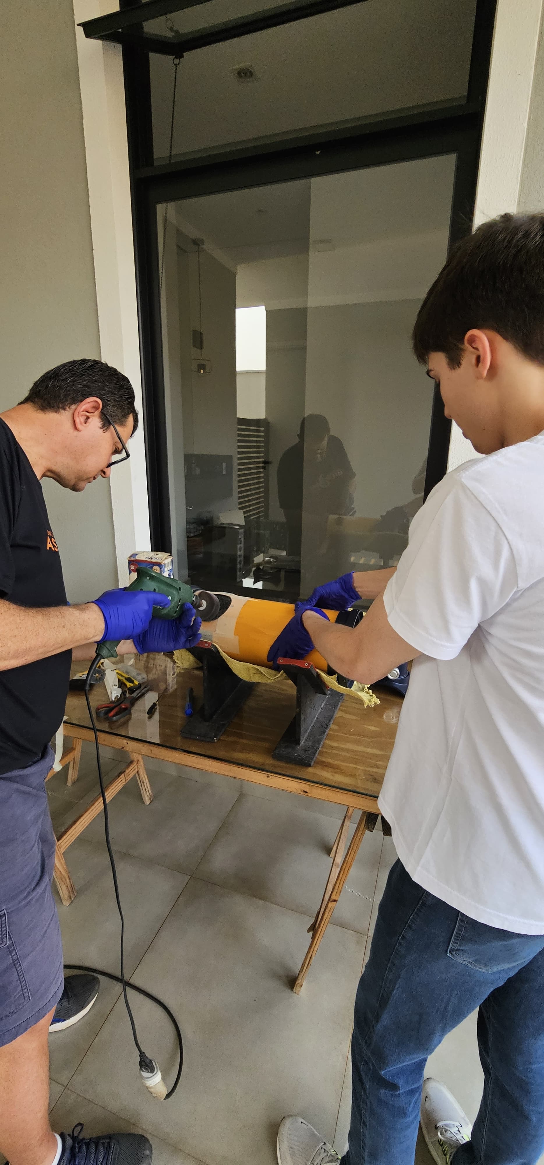

To go around this problem I had to disassemble the both mirrors from the OTA and grind the edges of the focuser hole so the drawtube had space to pass through. I asked an ATM friend (Herik - makes carbon fiber tubes for us) that has the right tools for the job and skills to do it without damaging the entire thing. Here's some photos of the modification we did:
Imagem do WhatsApp de 2024-10-10 à(s) 22.46.11_9b3f2b1b.jpgImagem do WhatsApp de 2024-10-10 à(s) 22.46.11_414dd659.jpg
I am the one helping holding the tube in place.
While it is heart wrenching to see someone doing this to the Epsilon, I have to say we did a pretty good job on the modification. We put all this plastic to prevent iron powder from getting stuck inside the tube and then rusting, and when we were done with the grinding we also made sure to paint carefully with non-reflective black paint those areas, then cleaning for last. In the end you couldn't tell it was modified.
To conclude, I would say that if you have no choice, like me that can't afford an Optec Leo or similar, if you have the endurance to face this little modification, it might be worth it to get this 2047 Studio focuser. However, if you don't want to touch your tube and just change focusers without headaches, it is worth to get the more expensive options.

I appreciate you sharing that.I have bought the e180 variant of the stido247 focuser and will make a decision once it arrives on If and how I will proceed.
Your right this is something Takahashi should of addressed along time ago.
astromauchrisouza 5.27
Glad to help in some way.
I hope yours fits perfectly without any problems. Maybe the E-180 has a bigger hole than the E-130D.... If that's the case, then you should be good and wouldn't need to do anything.
daywalker
Mauricio Christiano de Souza:
The seller is saying no mod required..we shall see.
tlmaurer63 0.00
I wish I'd have come across this thread when battling my Tak focuser. It would have saved me a lot of time and frustration. I too picked up a 2006 Epsilon 180ED on the used market and found the focuser to be absolute trash. Simply unusable with the drawtube slop and rotation when racking in and out. Adjusting the grub screws proved to be useless. AstrOasis sold me a really nice pinion replacement that definitively improved the stability and action but nothing for the slop. Tak America can rebuild/refurb them for $200 but I wasn't confident enough to think the rebuild would be enough to mitigate/eliminate focus issues at f/2.8 with large fine pixeled sensors. Optec's solutions were simply out of my budget. I came across 2047Studio and heard good things about their quality. I picked one up new for $600 on Ali (Star Trip store is great!) and gotta say it is fantastic. Build quality, fit and finish is amazing. I've had zero issues since with the 180ED and highly recommend it. I paired it with the new AstrOasis Rose Electric Focuser and get sub micron focusing steps in a really nice compact unit. I'd be happy to answer any questions.
Timothy Maurer:
Good to hear that the 2047Studio focuser worked for you as well. I've been using mine and it is quite good to be able to trust the build quality it has, not having to worry about it failing at some point and having to adjust it over again.
The only con I have about it is that the over exaggerated drawtube size of the focuser blocked the access to the allen screws of the ZWO OAG tilt plate (that faces the focuser), which is really important for fine tuning collimation. I solved it by changing the camera train completely to Player One, as they make the cameras with built in tilt plates with the screws facing backwards, being way easier to access and adjust. I know it doesn't have anything to do with the topic, however, I must say that the build quality of the Player One camera is much superior than ZWO and it is a few hundred dollars less expensive, not going back to ZWO to be honest.
