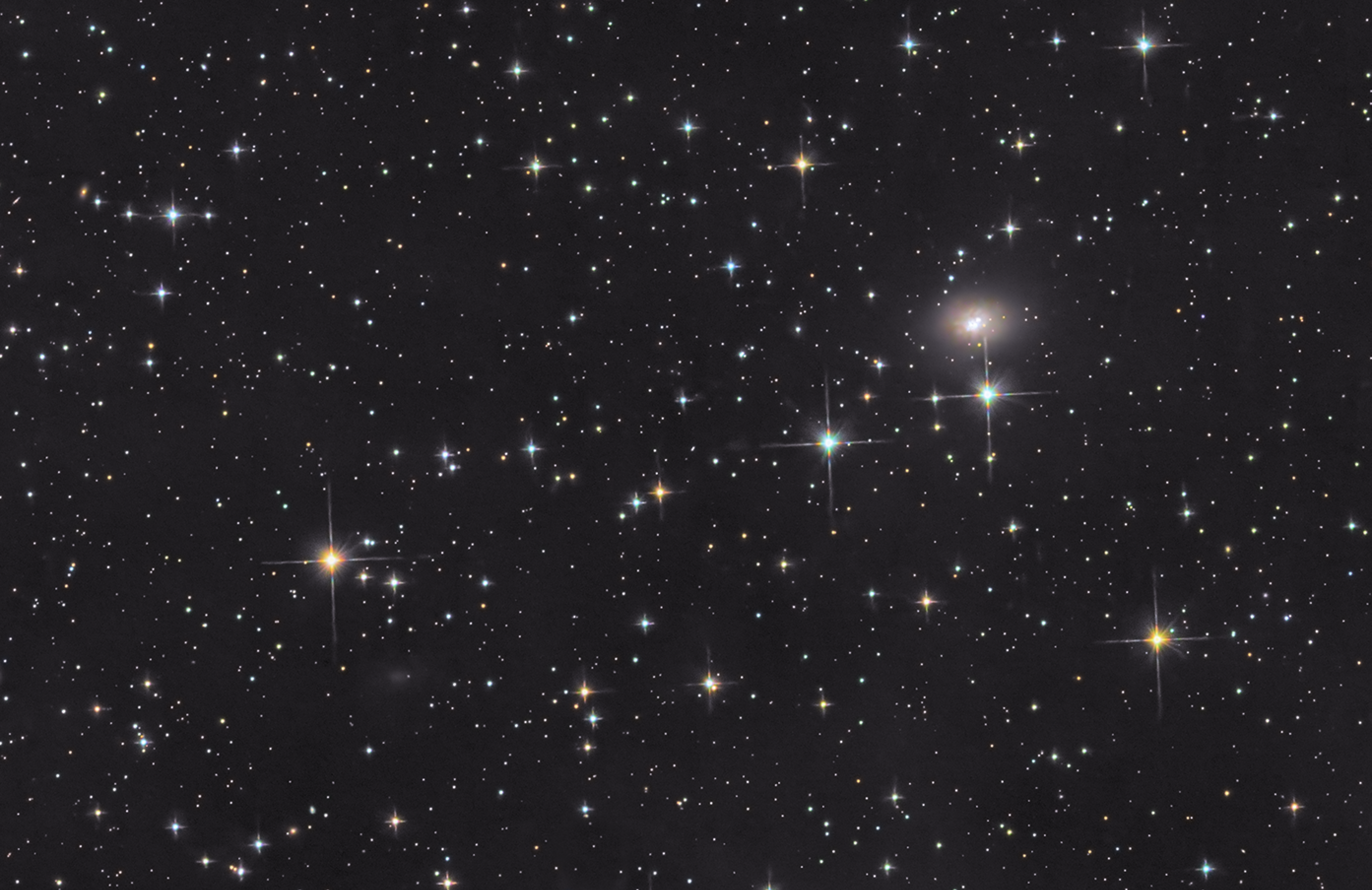

Screenshot 2024-01-05 at 5.55.36 PM.pngScreenshot 2024-01-05 at 5.53.30 PM.pngHello everyone,
I have a Takahashi E-130 for about a year now. I installed a Moonlite focuser as soon as I got the scope.
After using it over the last year and posting some images I have been told that it looks like something is not right with my optics.
I spoke to another Tak owner this past weekend and he helped me ensure that collimation is good. I also sent some images to Takahashi America and they called me back today. They said that after analyzing my images that it seems the focuser that I installed is not centered correctly. He said that I have light flaring towards the right of the stars on the right side of the image and light flaring on the left side of stars that are located on the left side of the frame. He also said that the diffraction spikes are showing rainbow coloring which is a sign that something is off. He said it is a sign that each filter is requiring a different focus point and therefore creating the rainbow.
His recommendation was to send the scope to them to get aligned properly. Before I ship the scope out and pay around $500 I was hoping to maybe ask some of the experts on this website.  Thanks in advance.

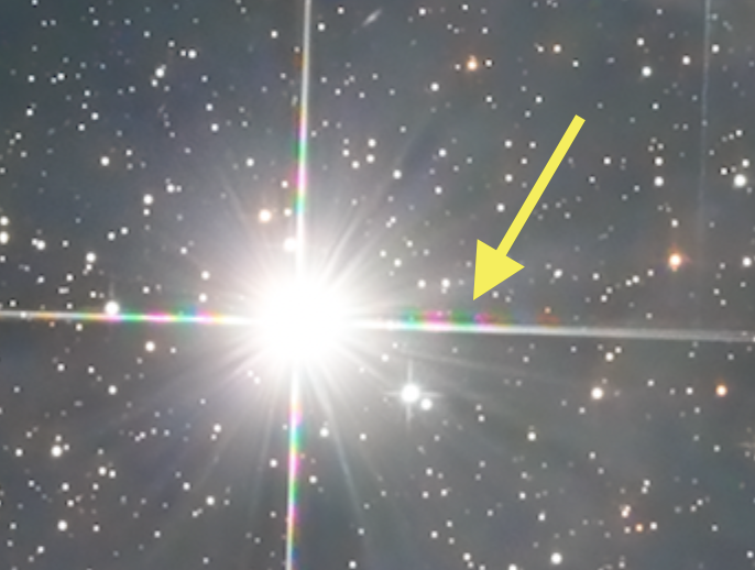

I generally trust the Tak America guys, but I am fairly sure that the rainbow coloring in the diffraction spikes is normal. Here's on my 160 image.png
I remember a thread where this was discussed as an artifact of the light wavelengths (I could be wrong though)
Psion 0.00
I agree, that the diffraction spikes showing rainbow colouring are normal, but you have double spikes, and the rainbow is a shift.
dunk 1.81
I agree with Nick - I also see these colours on my images occasionally (and it’s common for different filters to be non-parfocal even if the manufacturer claims they are).
tbh, your images look good to me - esp. the 2nd one. Perhaps some odd patterns on the larger stars but that could maybe be simply fixed with a mask on the primary (which my E130 came with via the shop I purchased from).

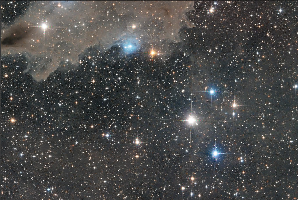

Your images looks good, I can see any flares on right or left sides. If you want to see flares look at me last image NGC1999 . It's probably due to the close star on the right side of the field. It can also be a light leak on the focuser, I have to check this. But it would be surprising because I already done a lot of images with no problem.
Saying that, it would be nice to know what type of camera you use for your image, stars look a little over exposed and you need as I do install a chamfer mask.
