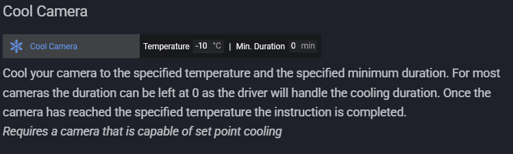

The NINA instruction documentation is not clear on this point. For example, here is what it says:
So clearly, NINA does not take the instruction as having been completed until the camera is within a certain delta of the set point. I think most programs work this way, if you are starting at a warmer temperature than the SP. The question is what happens if the set point is warmer, and I suspect the behavior may be different depending on if the set point was warmer at the beginning of the run or the outside temperature got colder as the night progressed such that the set point was too warm for the camera to maintain. I could totally see NINA continuing on in the second instance, but waiting indefinitely in the first, since the command documentation clearly says that the desired temperature has to be reached and only then the command is considered completed.
