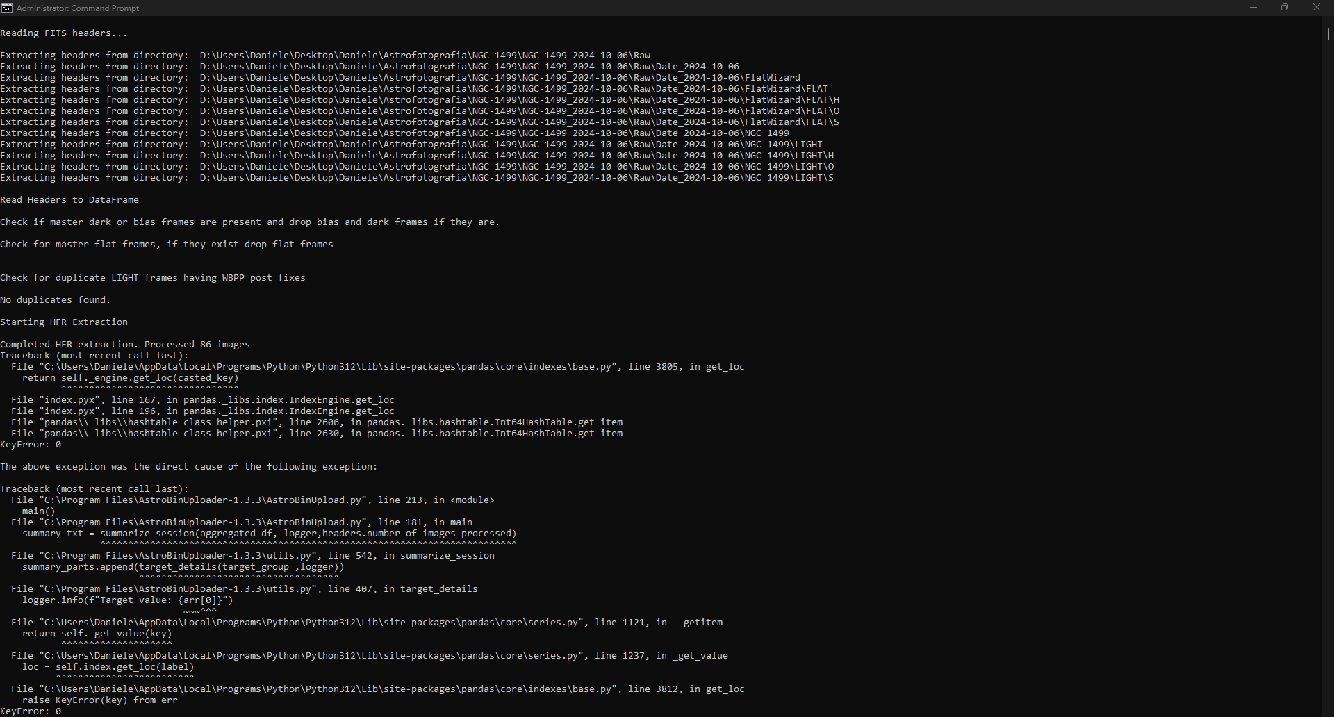

AstroBadger 6.62
Hi Jeff ,
looks like you are sorting this out. Can I ask you run with the debug option activated and send the files to [email protected]. This way I can see exactly what is happening .
thanks
steve

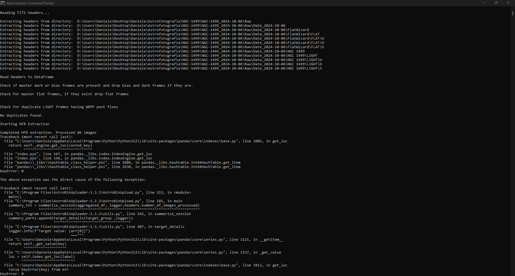

daniele.borsari 5.25
Looks like an interesting tool. I'm not very into coding so I ask:
Is it possible to use somehow the date of observation -12 hours to group each session by its starting date (e.g. I start a session tonight and it finishes tomorrow morning, I want the selected date for all the subframes to be 10/01/2024 and not half 10/01/2024 and half 10/02/2024) and also to customize what kind of information needs to be extracted (I want just the # of frames, the duration, the filter, the date -12 hours, the f ratio and the Bortle scale, without all the calibration frames etc. etc.).
Thank in advance,
Daniele

AstroBadger 6.62
Daniele Borsari:
Thank in advance,
Hi @Steve Greaves,
I tried to run the script but I get this error and there is no generated csv file. Do you know how to solve this problem?
Daniele
AstroBadger 6.62
Please send me the log file for the run
Thanks
Steve
[email protected]
I've sent the log file to your mail, thanks in advance.
Daniele
