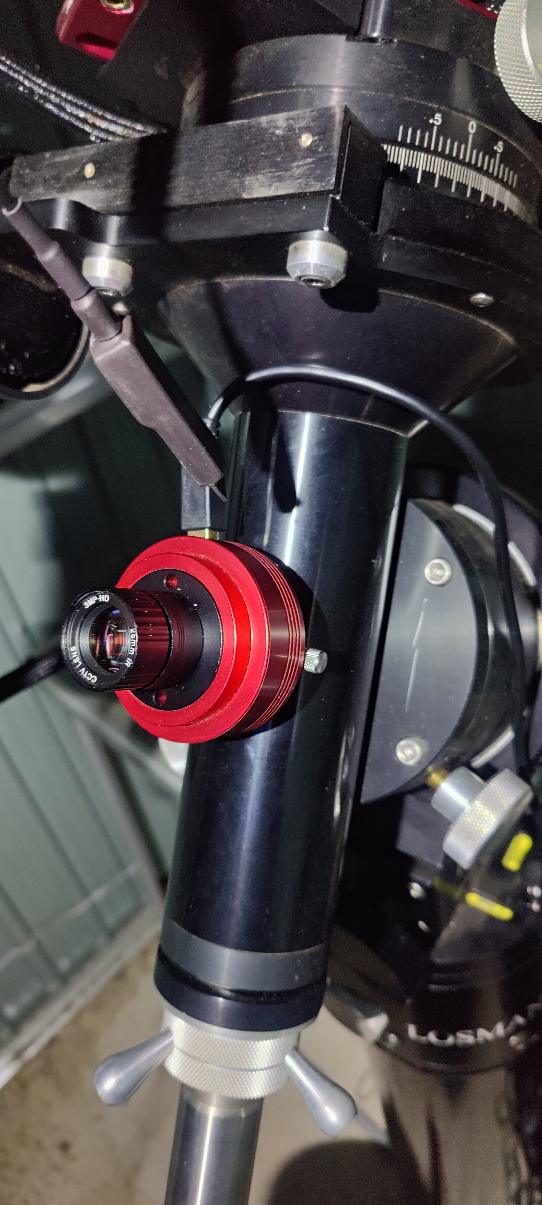

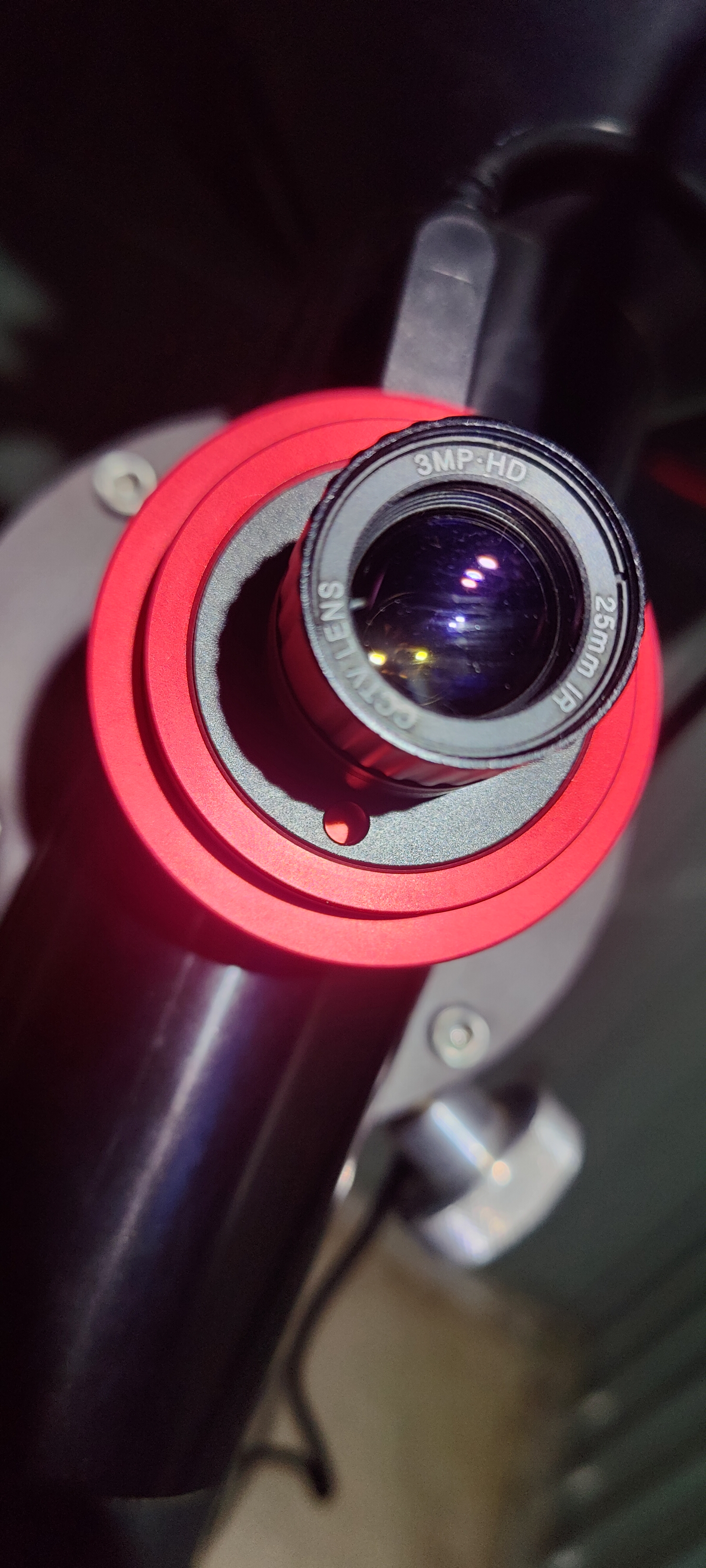

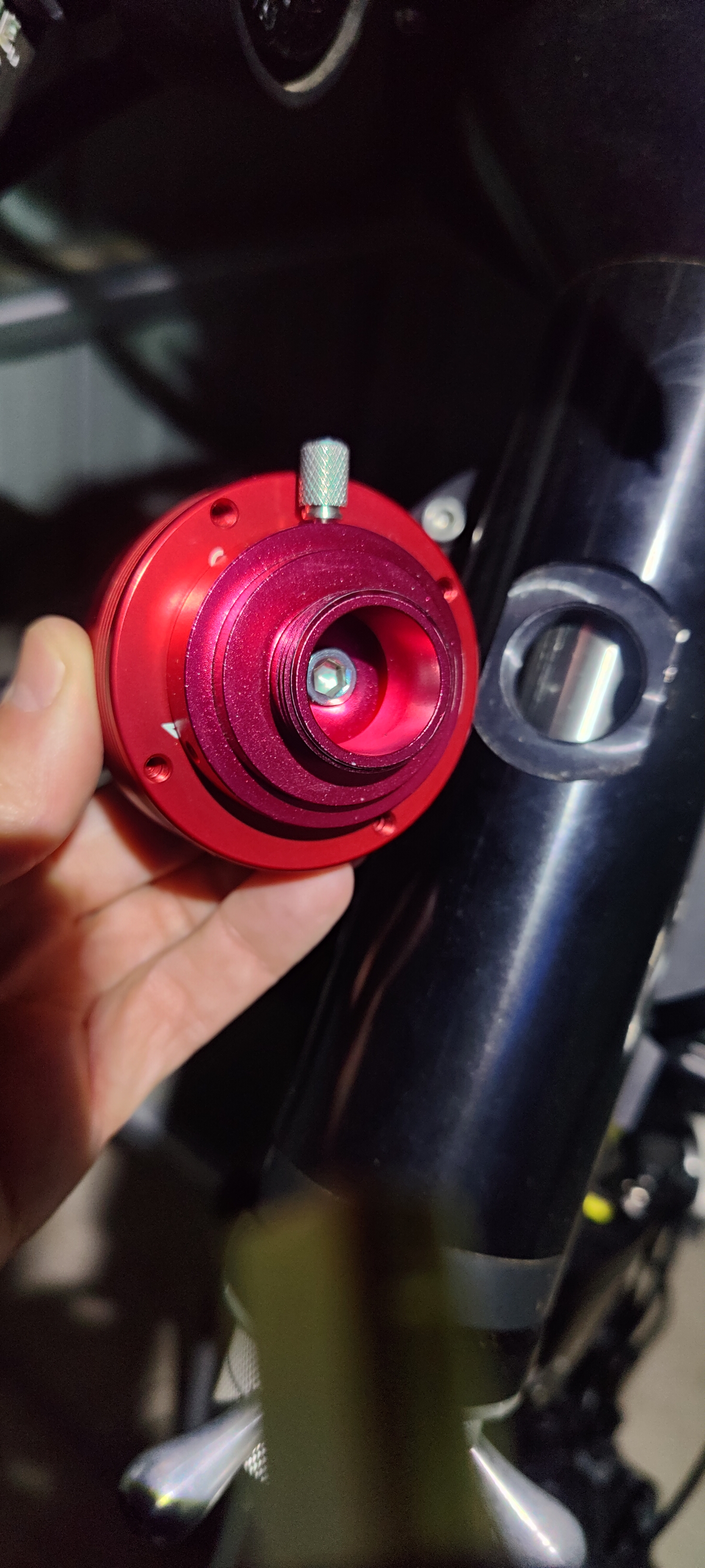

manu.zaitun 0.00
This is a hacked obsolete ZWO ASI 034MC camera used as Polamaster in a G11 Losmandy mount. It is used to align this mount to the Polaris star through SharpCap app.
