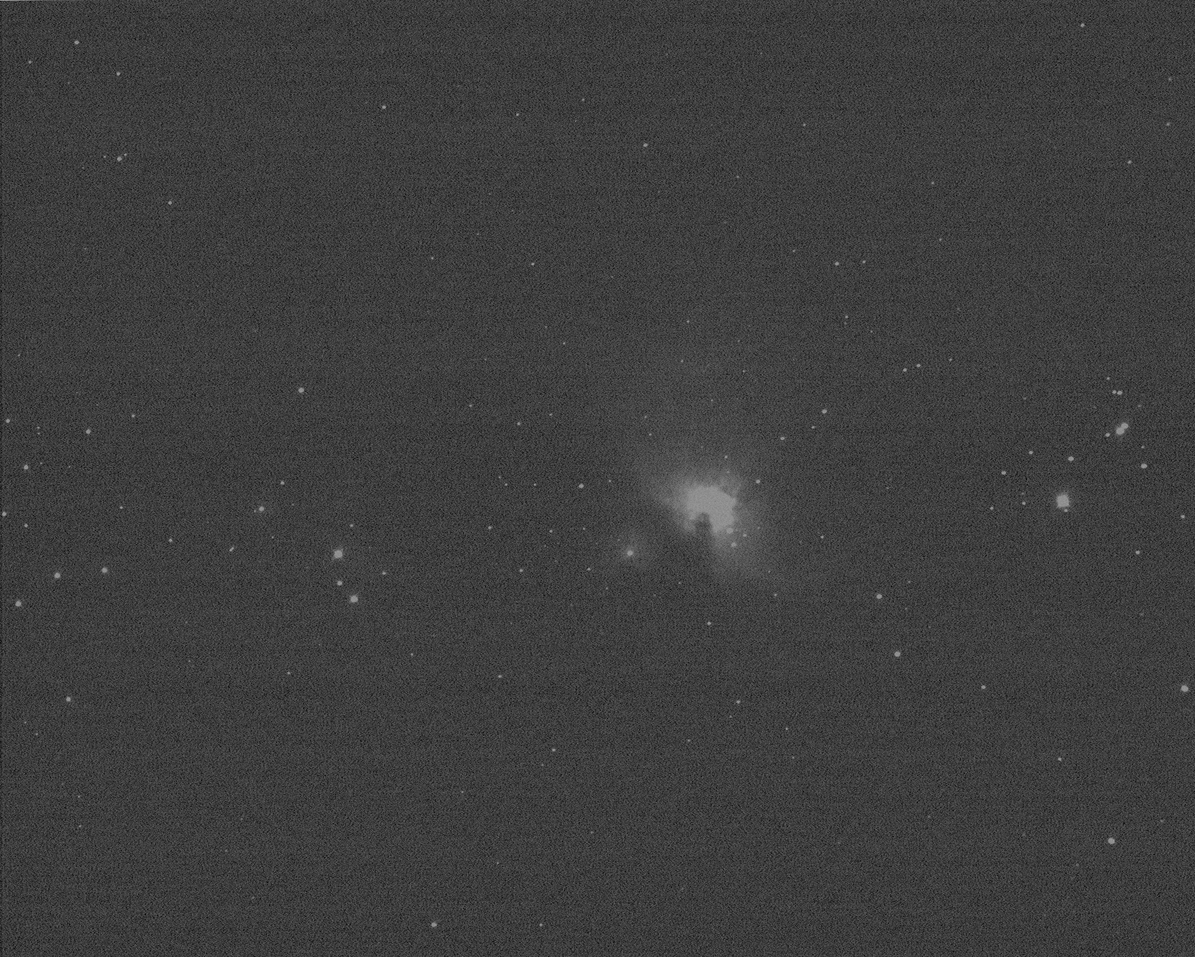

I've been running my SX 814 Pro a couple of years but after a short break I've been having issues with the bin1 data from the camera. Also the bin2 data looks weird.
The bin1 data is completely black, zero histogram and not even any sensor noise. The bin2 data does have some data in it and does show a histogram. But the image itself looks awfull. Shown here:

Now on the bench during the day the weird thing is that if I unplug any power and download bin2 data the histogram does show some data in the histogram with or without power. The bin1 doesn't change and stays black. It's like the sensor isn't getting any power passed on from the main board during bin1 operation.

Indeed, I've been in contact with Terry. First we tried to reflash the firmware via a windows program which showed some promising results since it showed some data in bin1 again. However, under the stars the data was still very poor as is shown in the bin2 data.
Terry suggested the head amplifier might be faulty which needed replacement. I've had the oppertunity to swap the main board of the camera with another working 814, which resulted in a good image. Suggesting the fault indeed lies in the main board where the head amplifier rests.
We're now in the process of replacing this component. I'll keep  you up to date.
