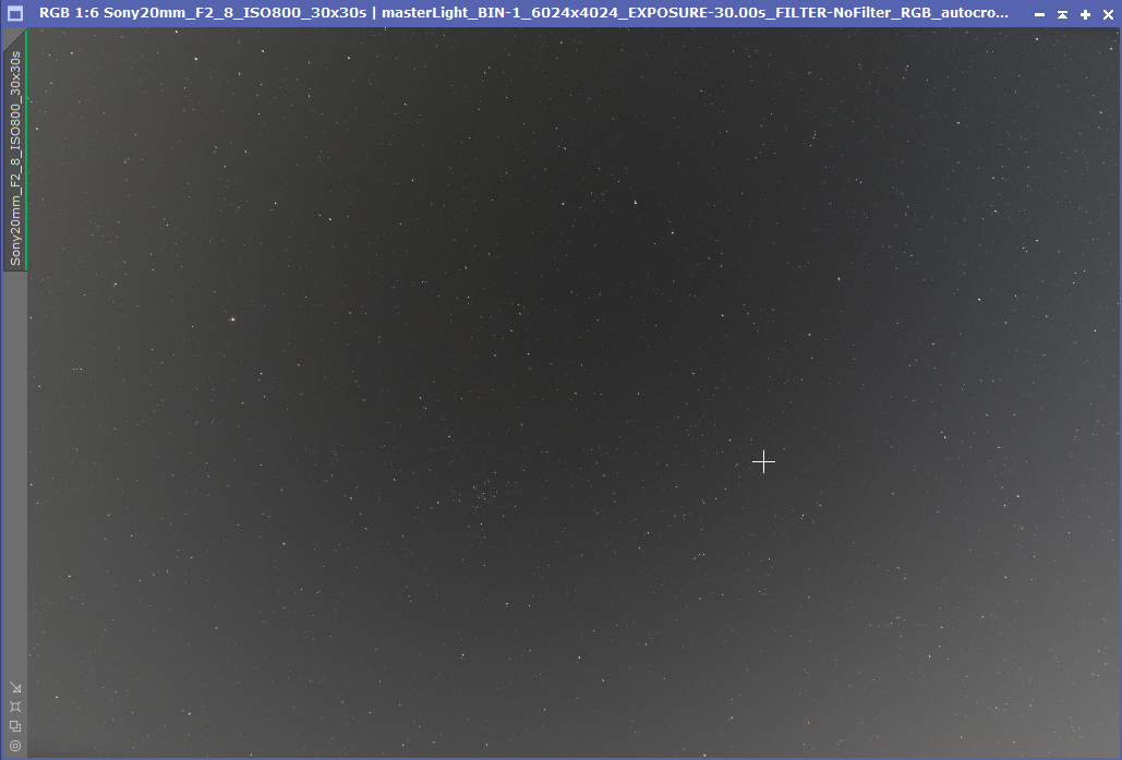

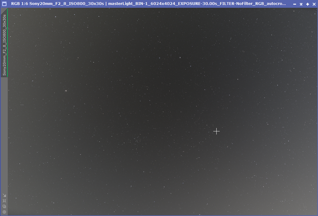

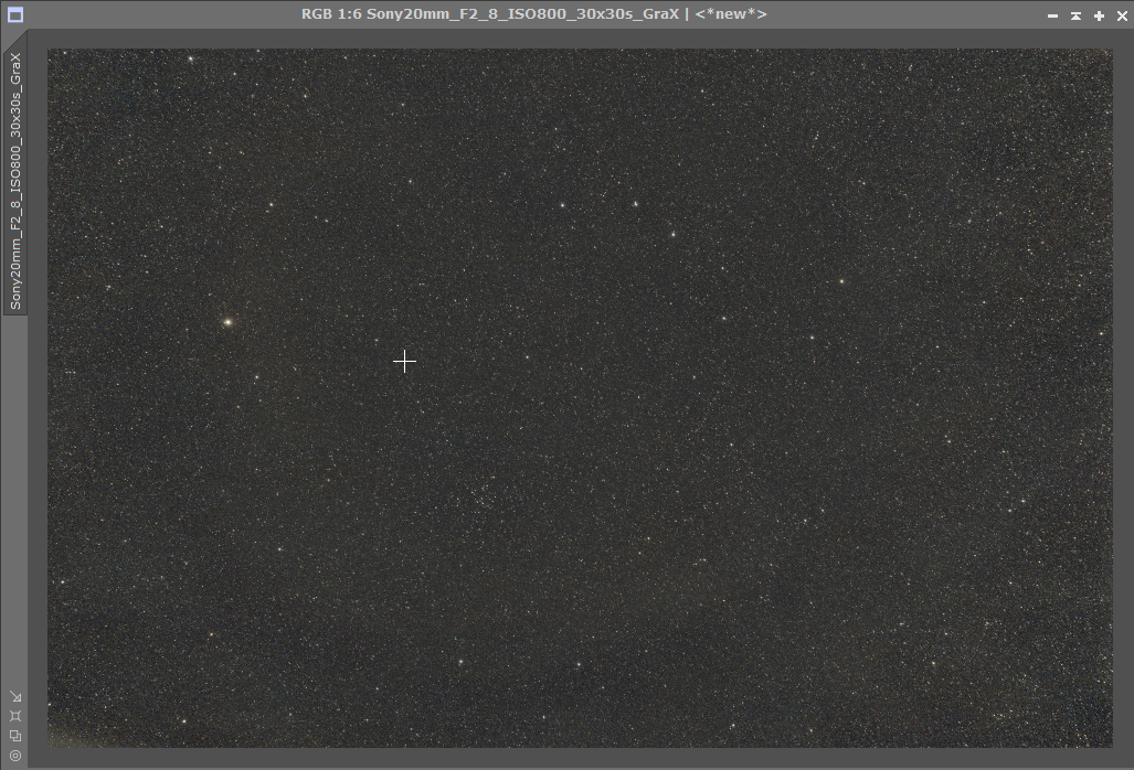

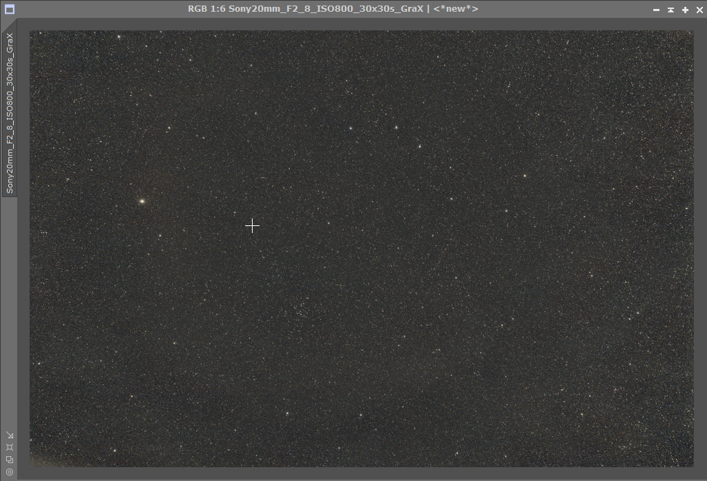

I had a clear evening and had a chance to test the pixel re-mapping before the Moon rose. Honestly, I didn't expect much. As suggested by Armin I tried F2.8. Here is a stack of 30x30s, Sony 20 mm G, ISO 800, F2.8, all electronic aids switched off, calibrated by darks, bias, and flats at F2.8 silent mode.  Applied GraXpert, stretched, and the ring...  ...disappeared. Then I wanted to shoot F2.5 or F1.8, but the clouds rolled in and ruined further experiments. I cannot tell, whether this improvement was caused by pixel mapping or just by the aperture F2.8. I am going to test it next time. @Armin Lukas thank you for the hints!
Jakub Korbel: I had a clear evening and had a chance to test the pixel re-mapping before the Moon rose. Honestly, I didn't expect much. As suggested by Armin I tried F2.8. Here is a stack of 30x30s, Sony 20 mm G, ISO 800, F2.8, all electronic aids switched off, calibrated by darks, bias, and flats at F2.8 silent mode.
 ...disappeared.
@Armin Lukas thank you for the hints! Nice! Im happy you have see improvements. It could the the aperture of F/2.5, which is cauing the circlular artefacts. Hopefully all rings are gone!
Jakub Korbel: ...disappeared. I am not sure if that's true; I'm seeing a dark crescent towards the bottom left corner. I am also not sure if GraXpert is the proper tool for gradient removal in this case. My workhorse for such tests is ABE. Furthermore, I don't know if GraXpert was trained in such wide fields and I don't know how accurate you were while taking flats. For the last two sources of uncertainty I can not say that your issue has disappeared. Sorry for being pessimistic  |
The crescent at the bottom left corner is not centered compared to the pattern rings reported previously. I would say, this is caused by light pollution of my Bortle 5 sky. But you are right. I should test it somewhere dark, and then conclude…

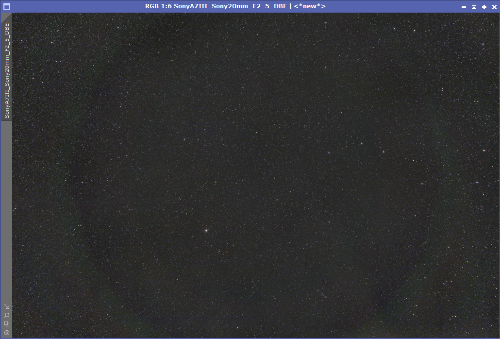

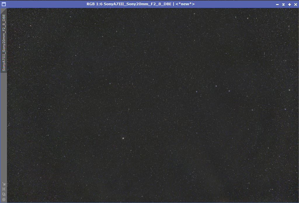

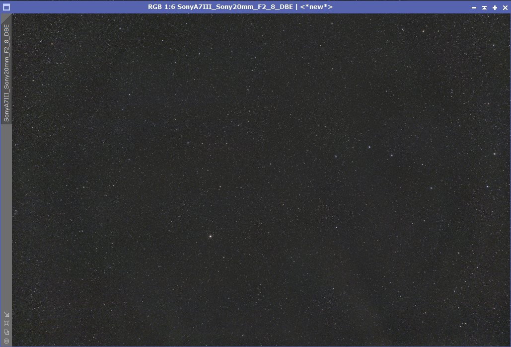

The last experiment - comparison of F2.5 vs F2.8. Sony A7III astro mod., Sony 20mm FE ISO 800 Lens correction - off Stabilization - off Silent mode 20x 30s, calibrated by bias, flats, and darks, all captured in silent mode. Stacked. Flattened by good old DBE. Stretched. Here is F2.5  The green ring is obvious, the pixel re-mapping didn't help. F2.8  There is still a slight sign of the ring, but this is useable. Conclusion: A7III combined with Sony 20 mm FE must be slowed down to F2.8, then it works well.

Hi Vedelou, I concluded that if I slow down sony 20mm to f2.8, the ring disappeared. What I heard A7iv doesn't suffer from it, so if you hesitate between iii and iv, get iv. However I will keep using my iii and the lens slowed down to f2.8
