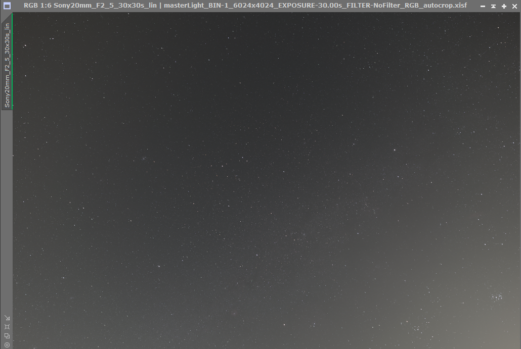

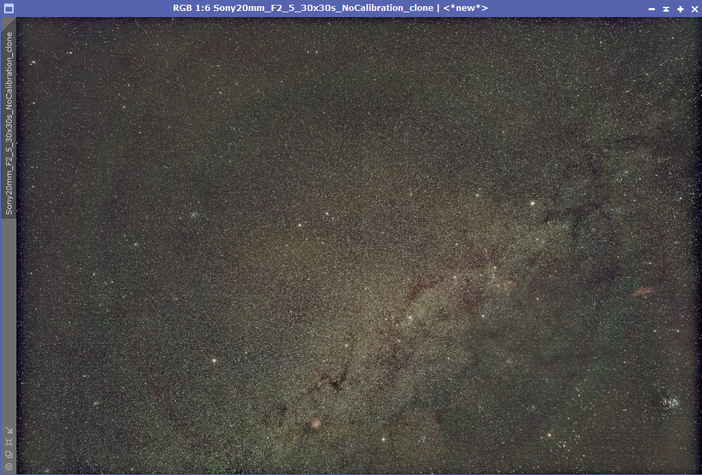

I managed to take a few tracked pictures (on 2.4.2024 - no Moon), specifically 30x30s, A7III astromod, Sony FE 20 mm G @f2.5 calibrated by 20 bias, 20 flats, and 20 darks. Everything was switched off: lens corrections, stabilization, etc.. My backyard is light polluted, so there was a gradient, which was corrected by GraXpert, then stretched. Otherwise, no other corrections were applied. There are some horizontal dark bands, but this could be caused by light pollution, clouds or so, The ring disappeared, so the mystery was solved. The camera is a keeper.
Is the electronic curtain on or off? Leaving it on, it may cause some linear banding (caused by artificial light sources). Also check if the bias frames are done correctly. Check stacked image with and without bias.

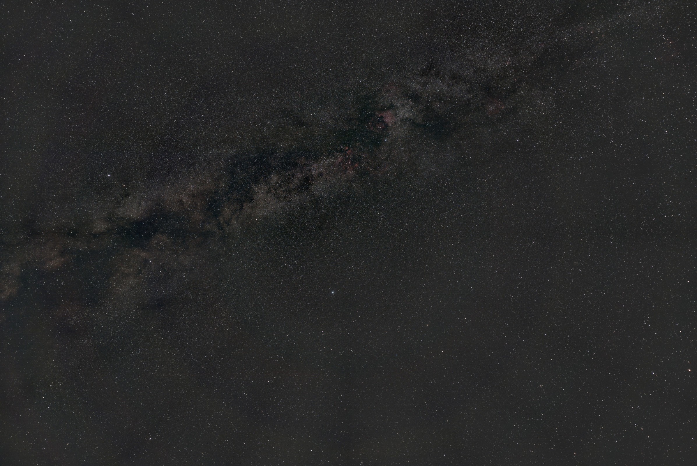

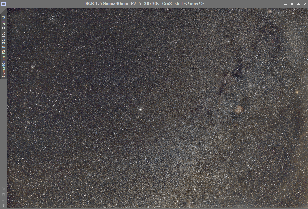

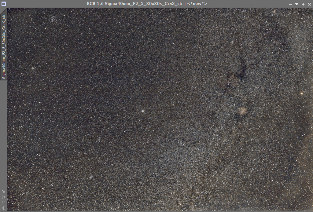

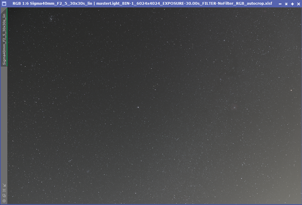

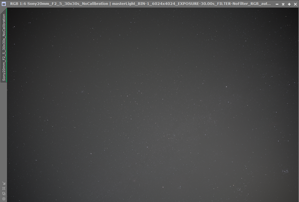

So, my endeavor continues. I captured the flats in silent mode. I started with Sigma 40 mm [email protected] EF attached by an adapter, ISO 800, lens correction off, and stabilization off.
Now the stack is much better calibrated. Here is how it looks stretched only by STF:
The GraXpert removed the gradient, and no bands or circles, or any other artifacts were visible - I am happy.

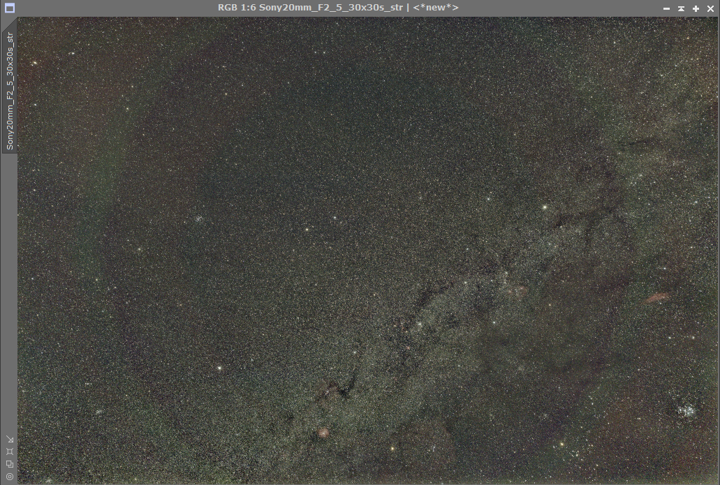

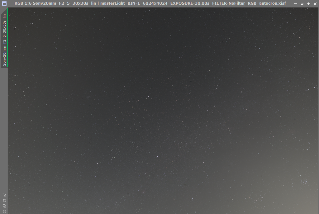

Then I switched to Sony 20 mm G [email protected] . Again, I can see that the stack is much better calibrated.
And if I remove the gradient by GraXpert, I get this:
A hideous red-green ring pops up. Just to confirm, lens correction was off, stabilization was off, and all calibration frames were taken in silent mode. I don't know what else to do. However, one has to think about the purpose of this camera. It is definitely not optimal for DSOs and long exposures. A dedicated cooled astro camera is going to do a better job. For Milky Way shots this ring should remain hidden because there is no need to flatten it with GraXpert.
One question remains: does the Sony A7IV combined with this lens suffer from the same background ring?
Could someone do the same exercise with A7IV?

Could you share a stack of the second photo without flats?
JaKor4578 0.00

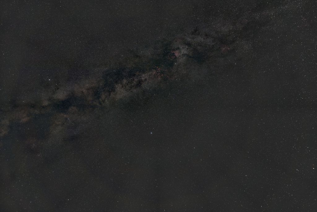

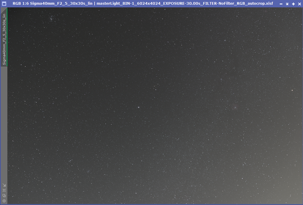

Yes, this is what I was thinking, so I did the stack only with darks, no flats, no bias.
Here is the picture just stretched by STF, vignetting is visible:
GraXpert applied, stretched:
I also tried without the darks, but it was the same.

I also own the combo Sony A7 III and the Sony 20mm 1.8 G Lens, but did not see any rings. Have you tried F/2.8 or higher?
When i get the chance i can try the exact same settings as you. A list of the important settings would be good. Then I can get back to you
JaKor4578 0.00
Good luck with that Armin. I did the star test and the stars had a small "wing" up to f2.2, at 2.5 it disappeared, so I set this f-number for long exposures.

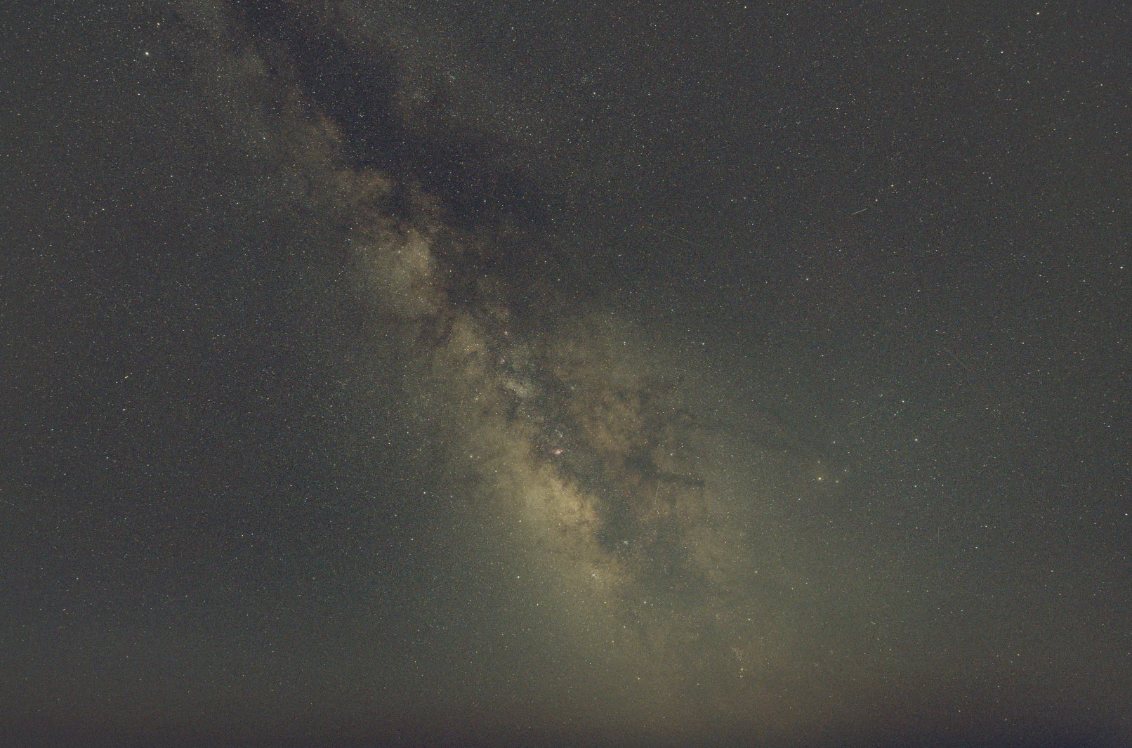

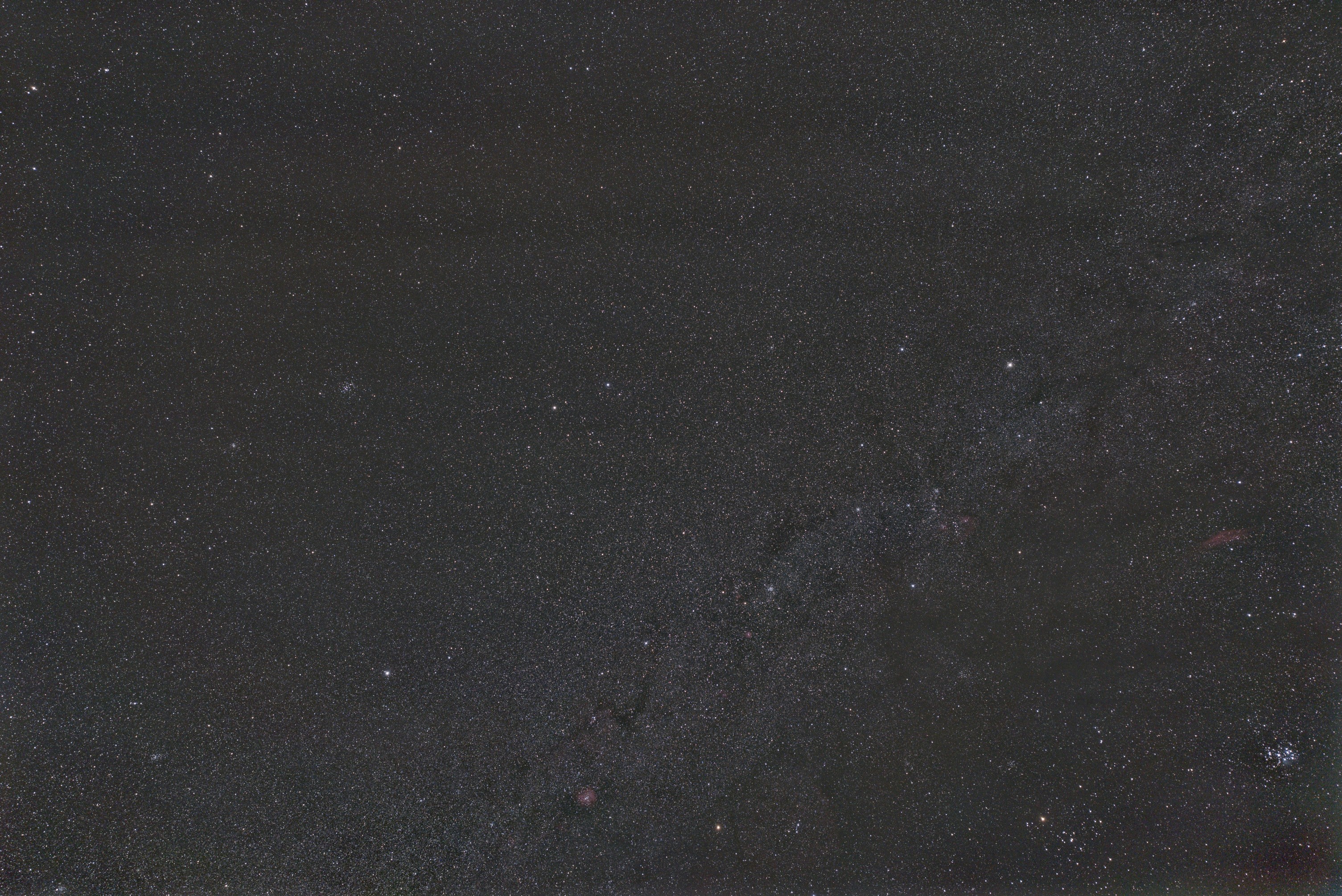

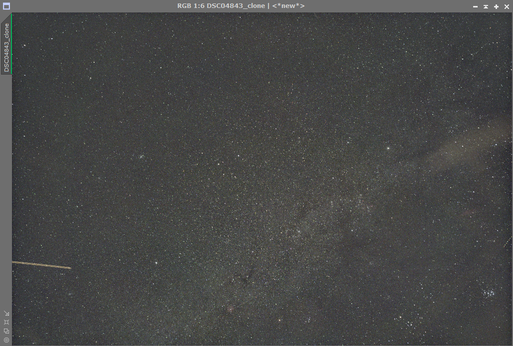

Here is a sample:
Sony A7 III
Sony 20mm 1.8 @ 2.8
ISO 800
Single Frame no calibration, after background extraction
I am not sure if I used silent shutter, but no rings at all.

This is just a single frame, mine is a stack of 30 frames, so maybe this ring cumulates.
I took a single frame and applied GraXpert:
The ring is almost invisible.
arminlks 0.00
Jakub Korbel:
I also checked other photos after stack (21 frames), and again no circular ring.
I would try to test different aperture settings and also turn off silent shutter.
If that doesnt work, maybe there is an issuse with the lens.
