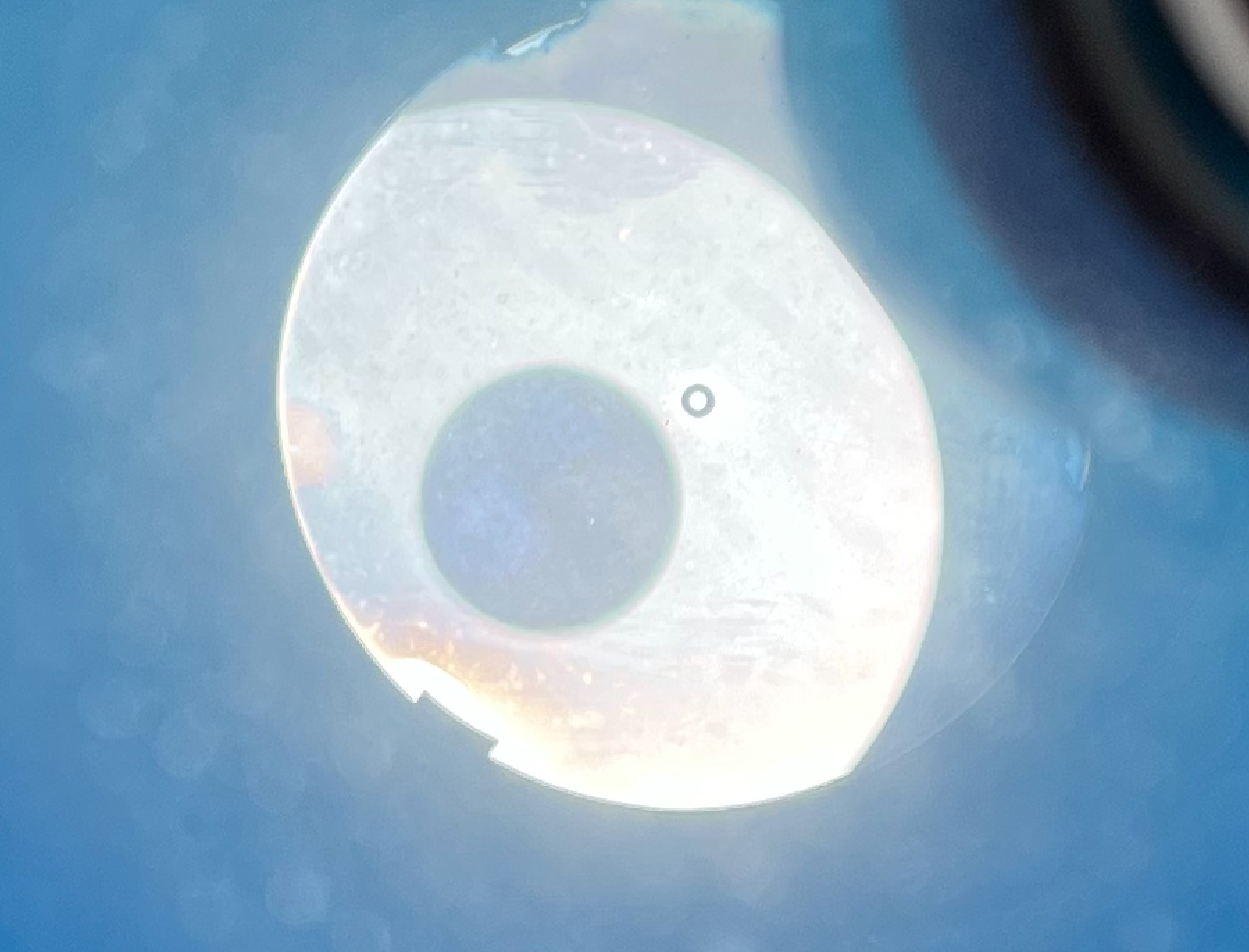

I'm afraid that I'm definitely getting a bit of dew on the primary mirror

Try with a pack of dessicant silica pearls taped to the inside of the primary mirror back cover. That should remove any moisture trapped inside the tube. Apart from a filter in the corrector ring, the MN190 is a closed system, and there shouldn't be any dew inside the tube. You must have very high humidity at your observing site.
Like Andrea, I also have a dew strap only near the corrector. This is attached to the heater output of a pegasus astro power box advance. I use the autodew function of this device, limiting the power to 40%.

I can confirm that I definitely experience problems with dew on the primary mirror. This is how it looked one morning this week. The photo isn't very good as I couldn't get focus on the mirror itself but you can clearly see a lot of dewScreenshot 2025-03-22 at 10.55.53.png
