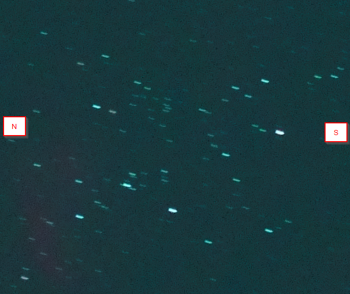

This is the type of tracking error I consistently get:
30" exposure - 100% magnification
Any troubleshooting tips would be very appreciated. It's extremely frustrating to be freezing outside wasting some of the few clear nights we've had so far this season.

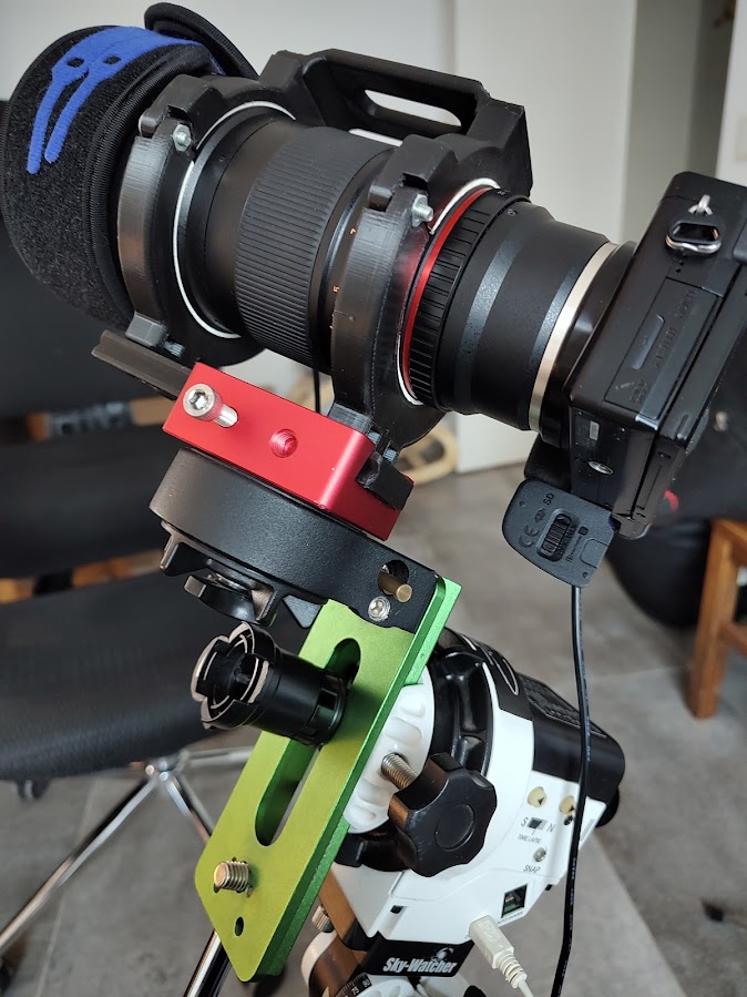

This is my setup:
I don't use batteries. I power the mount and camera with a USB brick.
The one thing that I recently changed is the red dovetail clamp but, if anything, it fixed a DEC balance issue I used to have.
Regarding the equatorial wedge, I don't like at all the altitude adjustment system, but still, I don't understand why would it suddenly start to misbehave...

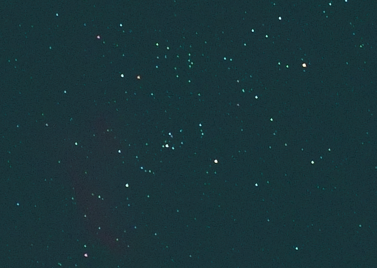

So... The polar alignment routine never failed before for 30" subs with the Rokinon 135mm and 3.91um pixels... And I got decent tracking on 90" and 120" subs before:
120" crop at 100%.
There's no NINA or any automation here, just the mount and the camera for the time being... By the way, I believe that the "manual" polar alignment can be much better for us southerners being that we have to get 3-4 stars within their respective circles instead of relying on getting Polaris on a somehow generic spot in the finder reticle.
I think you might be right regarding the grass, unfortunately I don't have a good solution available. What makes me doubt is that I got two really good nights and two aborted ones from the same spot.... I'll see tomorrow once I get a new session going.

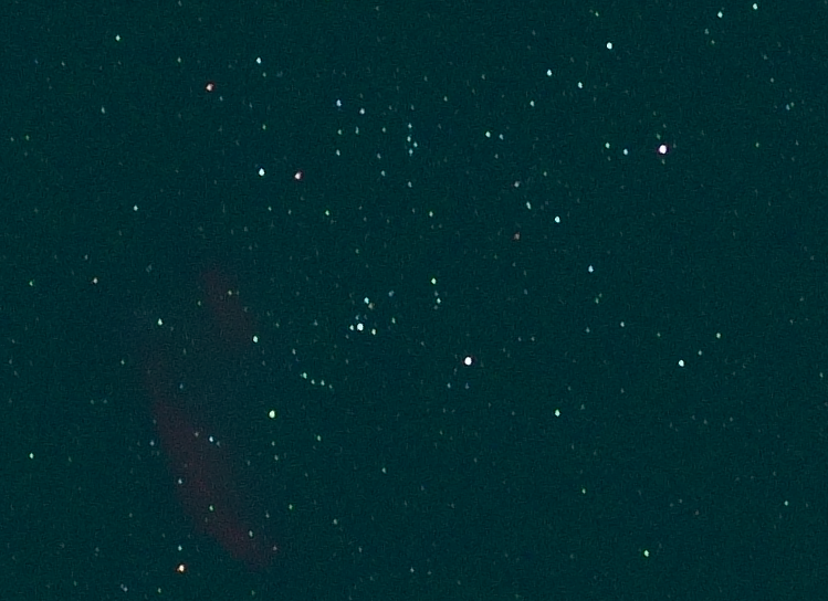

UPDATE:
121" exposure from a few hours ago. Crop at 100%.
Workflow changes:
. Set up and leveled the tripod during daylight.
. Set the altitude on polar alignment using always "up" movements as the knob tends to stay put better that way. If I needed to go down, I went below the target and then came back up to land just on the spot. It felt similar to tuning a guitar string always increasing the tension, never lowering it to get in tune.
That was it. I re-checked the PA after framing, it was just a tiny bit off but nothing compared to my previous night.
The hit rate doesn't seem to be very promising, though. I think that the unguided Sky Adventurer starts to show its inconsistencies shooting 2 minutes subs at 6.2"/pixel resolution. I still need to throw everything into WBPP and see what comes out but the results look very promising.

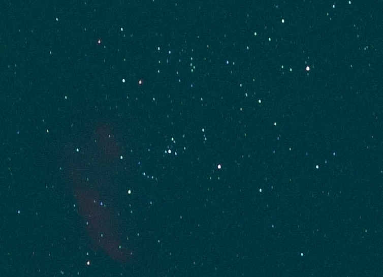

Well, this is embarrassing:
121" exposure from tonight.
Today I spent three hours troubleshooting my tracking issues, to finally get to the actual root cause: IT WAS ME 🙋‍♂️.
I was about to give up, nothing seemed to work, then I decided to follow the advice from @Guillermo (Guy) Yanez : I ran NINA for the first time. I used my desktop PC without any link or connection to the mount or camera. I installed ASTAP and configured the "fake" NINA camera that gets images from a folder. With that setup, I was able to run the three-point polar alignment... which showed that I was over 10 degrees off to the west 🤦‍♂️🤦‍♂️🤦‍♂️🤦‍♂️🤦‍♂️🤦‍♂️.
It turns out that the Octans asterism is almost invisible under a Bortle 7-8 sky with a 70+% illuminated moon and I was pointing at the wrong set of stars. It wasn't that the mount was losing polar alignment... it was that it wasn't pointing to the south celestial pole to begin with and, as expected, the wrong asterism kept escaping from the polar finder.
This also explains why I just started failing like this: all my previous imaging sessions were done from Bortle 4 or better skies, in which the visual PA takes less than 5'.
In addition to the polar alignment headaches, the tracking is proving to be not consistent enough to deliver a high percentage of good shots, it's hit n' miss, mostly missing. Given that I'm trying to start doing multiple-nights imaging sessions, lowering the exposure time really doesn't help (I already have close to 700 subs on this subject), I need to start guiding.
Having said this, I'm now researching for a good mini-PC to run NINA and start computerizing my setup, thinking about first getting a guider and then, finally making the jump to a real dedicated astro-camera.
Thanks all for reading and the good advice, you are an awesome community 🙌.
