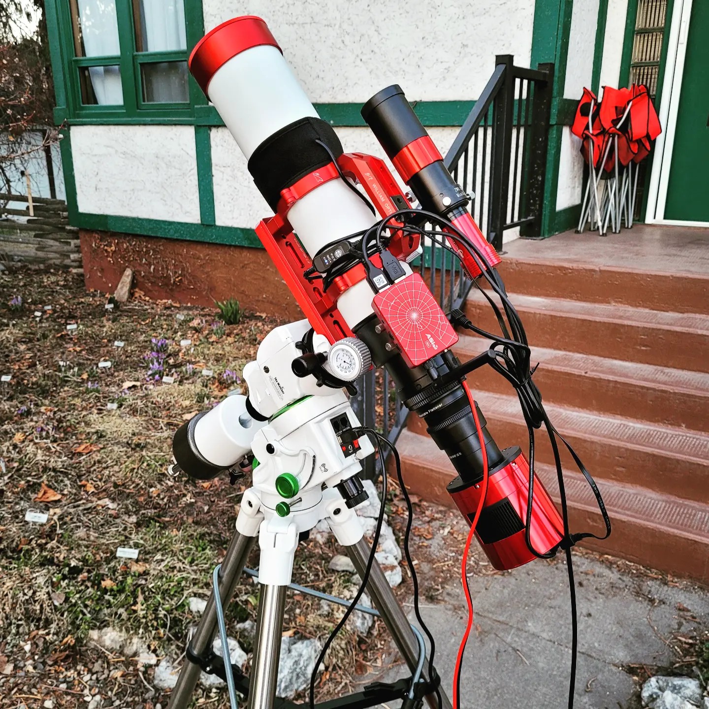

I was wondering if anyone has upgraded from an EQ Wedge mounted AZ GTI to the SA GTI? Is it a real improvement? Real world payloads (assuming a solid tripod instead of the factory unit), backlash, guiding accuracy, and of course plain simple reliability.
I was wondering if anyone has upgraded from an EQ Wedge mounted AZ GTI to the SA GTI? Is it a real improvement? Real world payloads (assuming a solid tripod instead of the factory unit), backlash, guiding accuracy, and of course plain simple reliability. I recently did this exact upgrade as I accidentally overloaded my AZ-GTi and stripped the Az / DEC tension screw by loading my scope before the counterweights. I repaired it once but a couple nights later it stripped again, and I can’t seem to fix it this time :/ Definitely my error, but made me realize how much stress was being put on that screw that it probably wasn’t designed for. I haven’t taken the SA out yet so I can’t speak to its reliability, but it seems way more robust.
let us know how you get on. Id like to try something pushing 6kg on my sw SA GTi
I had no problems running this rig when I had my GTI. I think this was about 10lb's. I don't think the 50% rated load rule applies to this mount.  |
Harlan King: I had no problems running this rig when I had my GTI. I think this was about 10lb's.
I don't think the 50% rated load rule applies to this mount. Just for clarity: you run the same rig (Z73 if I am right?) without issues on the AZ GTI + SW wedge as well, that's the message?
Sorry for the confusion - my response was to the original question. I have no experience with the AZ GTi. And yes, Z73  |
Harlan King:
Just for clarity: you run the same rig (Z73 if I am right?) without issues on the AZ GTI + SW wedge as well, that's the message? Sorry for the confusion - my response was to the original question. I have no experience with the AZ GTi. And yes, Z73  Thanks! My case will be a 2.8/300 nikon telephoto, same weight stuff. I'll give a chance to my old trusted Lightrack ii first, but the lack of fine adjustment on both axis and goto is a pain.
I've been wanting to use my sigma 150-600 sports telephoto (2.1kg) with my Star Adventurer GTi rig, but Im scared I may break it 😆
These weight ratings specified by many of these manufacturers I find confusing. I mean, I bought the mount because it can handle 11kg (assuming 11kg of my gear), but apparently that means including the counter weights.
Its a term we use for telescope heavy, that means that on RA rotation is just a tiny heavy on telescope side. That way guiding is more stable and without jumping. If you have a belt drive you dont have to think about this!!! Question: does the telescope go "up" or "down" in your hemisphere? I'm trying to translate that expression into southern terms to give it a try with my setup... Thanks!
My setup is about 7 kg ( SW 130 PDS, AsiAir, ZWO camera, ZWO OAG, ZWO EAF filter drawer, cables and 3d printed dew shield and Dew vent with cover behind primary mirror) and Total guiding error is from 0.4-0.9 arcs. Balance is a little East heavy on purpose. What PHD2 setting do you have? PHD2 reports that I have backlash above 6000ms. I wonder if the sidereal rate should be 0.5 or 1.0.
