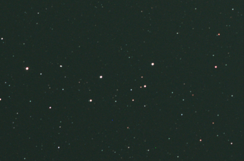

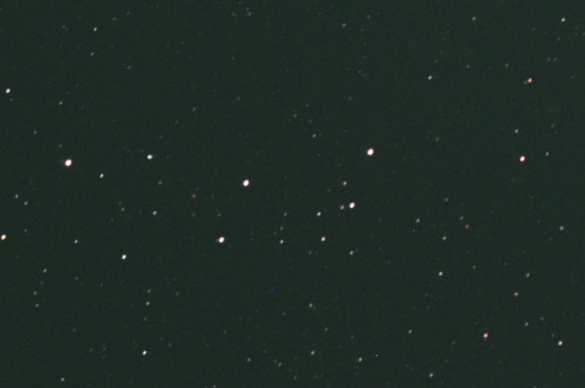

Can you upload a cropped photo of your stars when they are normal and the next sub when they are stretched? I wonder if this is due to dithering because I have this same issue a lot, but I haven't checked for metal pieces like you did. I'll attach what my stars look like too if your stars look similar (1st image is normal, 2nd image is the next sub with weird stars).Screenshot 2025-01-01 170424.pngScreenshot 2025-01-01 170436.png
