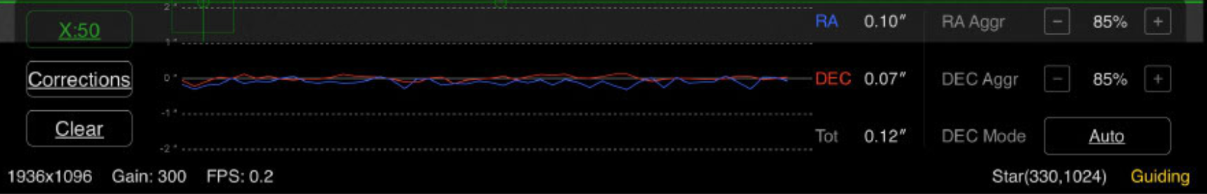

I recently did the Rowan Belt Mod on my 2 year-old HEQ5.
I was amazed at how well it performs now !
I easily get < 0.15" error, all driven by an OAG and guide camera from an ASIAir Plus.
My OTA and camera only weigh about 6 kg, which no doubt makes a difference.
I did a bit of tweaking with the aggressiveness setting - it seemed to work best with RA and Dec set to 85%.
Of course, I'm pretty happy with this result
Gary

Hi Gary, I do not want to sound overly jealous but the numbers are a little too good to be correct for a HEQ-5, are you sure that the focal length in PHD’s settings is set to the focal length of your lens? If the focal length value is correct then I am totally jealous…
Gary.JONES 6.90
I know what you mean - I had to look twice myself because those numbers are sooooo-oo good smile
Now you've got me worried …
I'll check that next time I set up - which could be a while judging by the weather we're having here at the moment.

Yes, the ASIAir does set the focal length based on plate-solving, but only for the main scope, not for the guide scope.
AAP determined by focal length at 3% more than the manufacturer's spec, which is probably due to the extension effect of the adapters and camera setback.
The guide scope doesn't plate-solve on guide stars - so the focal length has to be set manually.

Hi Michael,
Well it looks like your advice was spot on ...
I checked the focal length setting for my guide camera in ASIAir.
It was set to more than 6.7 times what it should have been - I have no idea how that happened.
So, doing sums on the back of a postage stamp, the *real* value for guiding should be more like 0.8", rather than 0.12".
Not quite as good as 0.12", bit still not too shabby.
The lesson : always check your assumptions !
Thanks Mike - I'm very grateful for the tip - no need for you to feel jealous now
Gary
