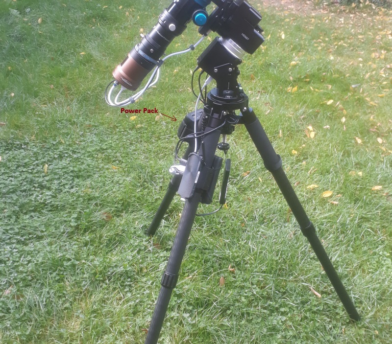

SkyHoinar 0.90
Hello F.T.
You can find lightweight portable power packs on Amazon or on astronomy specialized stores.
Me, I always power my mount via a power pack because I find it more convenient.
As I targeted portability when I built my rig, I also chose the power pack to be lightweight and at the maximum limit of what is allowed on airplanes (max capacity of 100Wh).
So, I have this one:
https://amzn.eu/d/alTbMMr
It is about 600g, capacity 99,16Wh, and it can deliver 100W via PD (power delivery over USB-C) in different combinations (me, for my iOptron HEM27 mount I need 12V/3A).
With my setup, powering the mount + the cooled imaging camera + guiding camera, it lasts about 4,5 hours.
But you can find others too. There are plenty of them available. You just need one to match your mount's power requirements. There are also converter cables from USB-C to DC plug available on the market.
I also have the Celestron Power tank:
https://www.celestron.com/products/powertank-lithium?srsltid=AfmBOor9m2RHylf5srZzAMJA3Yrz5uuLQq7aO5ZxbRaEMa9sfUJin8AE
But this one is almost double the weight, so I use it when I am at home. For air travel, the other one is more suitable as it is lighter (I can take 2 of them for the same weight)
This is how it looks like:
I hope this helps.

Hello. Thank you very much for the advice.
With such a light weight it would be perfect and with the 100w I don't even have to worry about the fact that I am underpowering the mount. As durability for me it would even be too much!
I already have the usb/DC cable so I should just get the battery. Thank you very much again!
