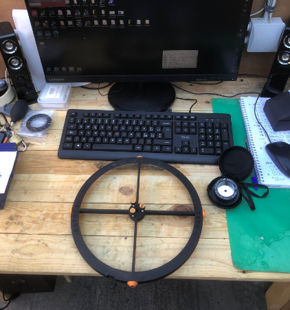

Hi, I've recently discovered I have the possibility of making my telescope better with a friend's 3D printer. Unfortunately I'm not accustomed at all to 3D softwares. I managed to find a few models that, even if they technically don't fit my telescope, just need to be scaled, not a big deal. The only problem I encountered is the recessed substitute spider vane which is probably the most important piece I wanna print. I found a 150 and a 130 model but no 250. I found the dimentions I needed and all but considering I don't wanna make a bad model from scratch I thought I could modify the original ones I found to get to a good result. The only issue is that I can't just change it's diameter to 285mm or something and keep everything else the same since it scales with it. I found a CNC made one dedicated to my telescope but it's 260, very expensive. Do you have any input or advice for me? Thanks  |

Aister: Hi! Thank you. I actually already have it on my computer, but I can't import the stl file it seems like. I tried using blender but I got confused for non basic things like adding a cilinder etc. In my specific scenario, what's the best thing to learn right away to modify my original model? I would start with making your own model, basically staring out with a cylinder, extruding it to the height of the spider and then creating sketches with different shapes to subtract from the basic shape. You can also make holes where you need them. That way you can make it as you like it. once you understood the basic concept of the CAD softwares, you can basically create anything you want. just go step by step.

Making some of the support structure from 3D printed parts would probably work fine; however, 3D printing is the wrong approach for making spider vanes. Those should be laser cut from sheet metal. My favorite laser cutting service is www.sendcutsend.com. They are quick, they do an outstanding job, and their prices are reasonable. John
why is it the wrong approach? can you elaborate on that?
