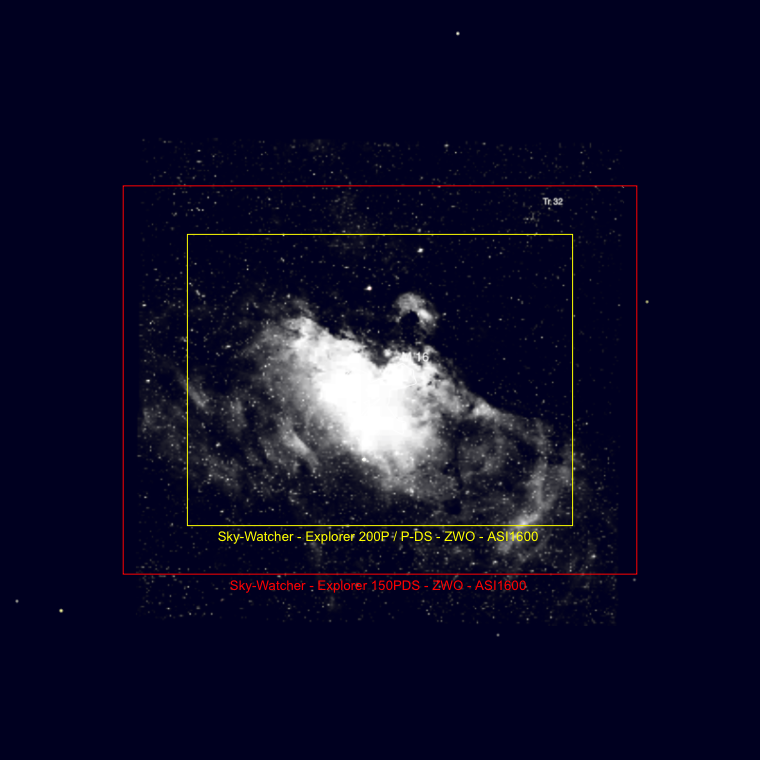

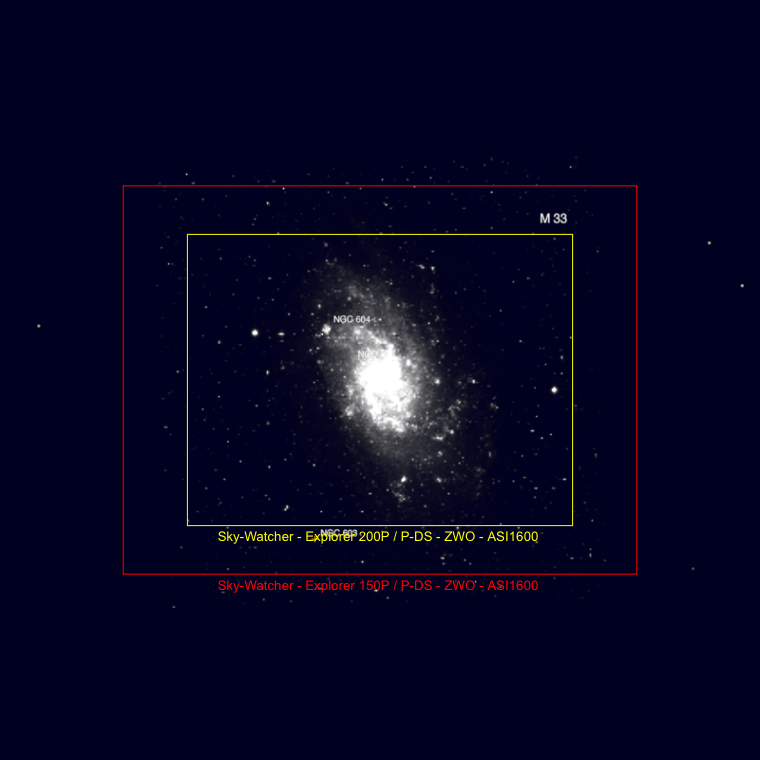

wimvb 3.11
The longer and wider the tube, the more it will catch the wind. So why the 200pds? A 150pds is shorter and not as wide. It will be less if a sail in the wind, while the focal length idn’t that much less. Besides, a shorter focal length gives a wider view ( good for nebulae) and a somewhat coarser pixel scale, which is more forgiving for tracking. Plus a lower weight for this mount.
