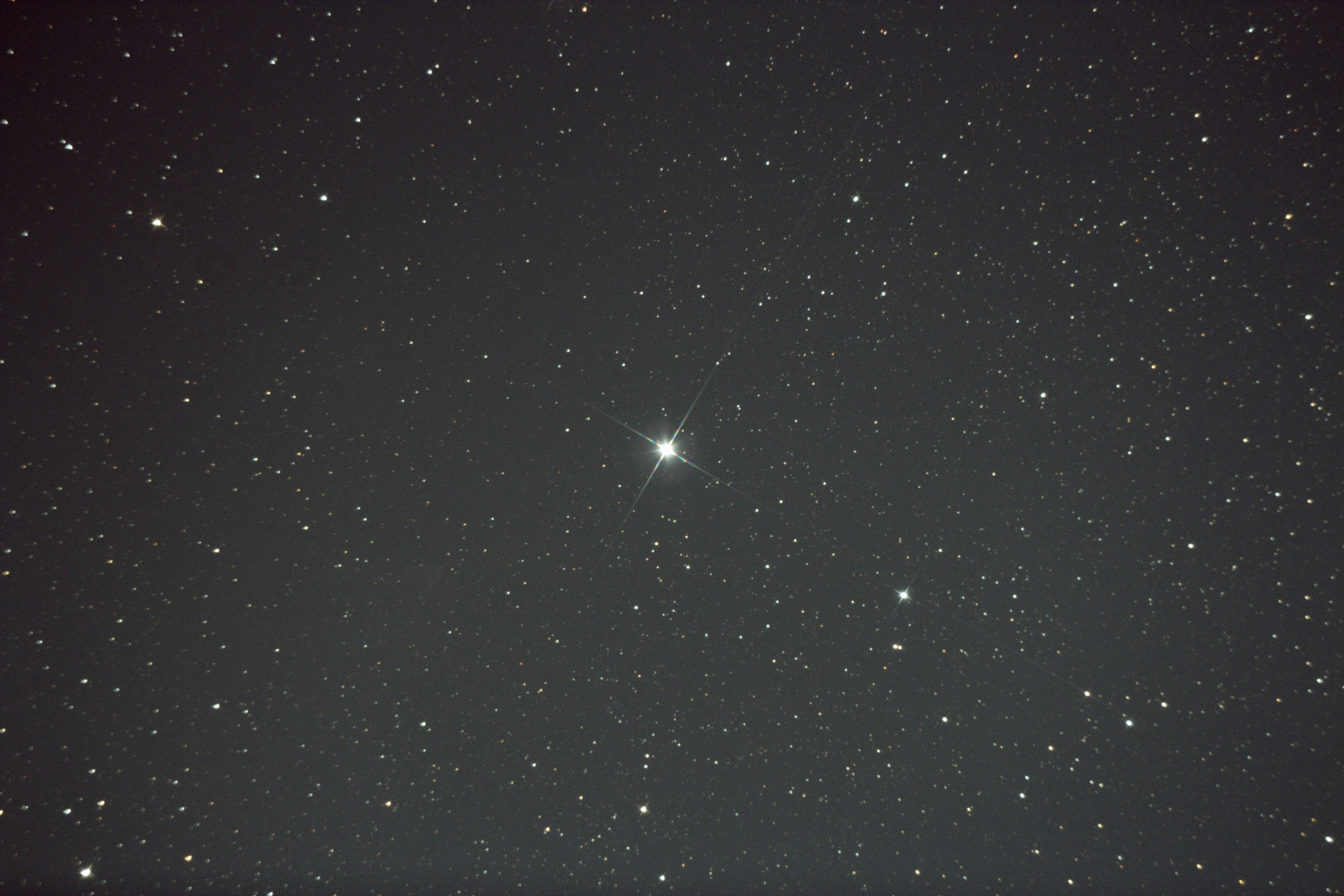

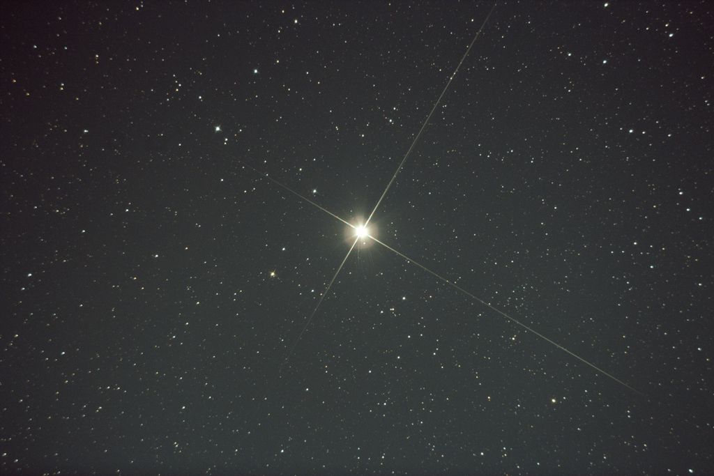

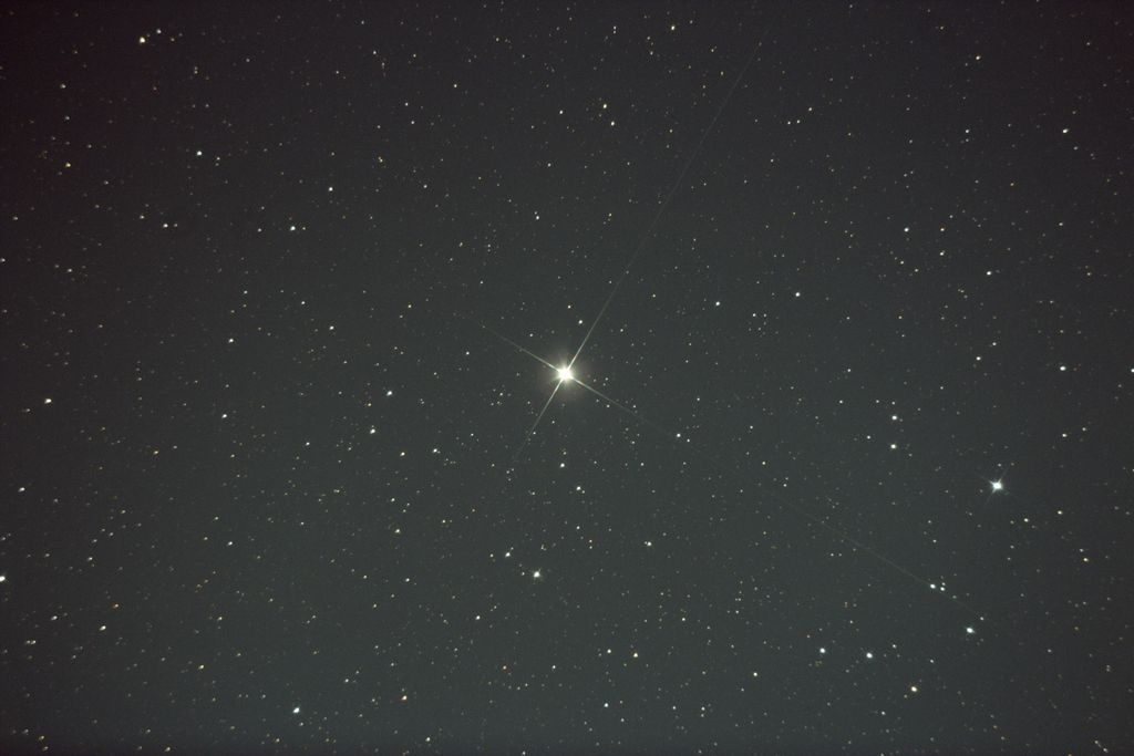

Hi all,
I just installed a primary mirror mask to hide the mirror clips as well as a CNC spider from backyard universe.
Had about 10 mins of clear sky to test the result and am puzzled by the extreme asymmetry in the diffraction spikes as can be seen in the images below.
I emailed the manufacturer and he advised to apply velour to the spider struts to eliminate this effect (eliminate reflections from the cnc material)
I will do this as soon as I can but am just wondering how reflections from the spider would cause 2 of the spikes to be longer than the other, especially considering that the images were taken in completely different parts of the sky.
I should note that there is no coma corrector in place and there was no time for the scope to cool down.
Collimation was done before taking it out and then verified with a star test.
Any advice would be appreciated

I guess that:
1. The spider isn't centered
2. The mask does a poor job of suppressing clips diffraction (see flaring on bright star)

Thanks Andrea. I assumed the spider would be centred with a CNC spider but perhaps it is not.
I can’t see the clips at all with the mask in place but the focuser tube intrudes 25mm into the OTA which I suppose causes its own issues

Well, something is there with a 3-fold unsymmetrical pattern beside the spider diffraction and that doesn't look like an effect from the focuser tube protruding into the light path (which is showing in the first picture).
Anyway, the best course of action is actually measure the spider thing.

It's the spider, clips and focuser intrusion w and the other stuff won't give you that fine extended spike IMO. If you have a refractor take a moment and play with string and tape and observe the patterns you get. I suspect that it's an error in the machining of the vanes of the new spider. The last thing I would want to do is get a fancy machined spider and then thicken the vanes with valore. You may as well trade your primary in for one with a lower strehl ratio because that's what you'd be doing.

Makes sense. Does this therefore imply that 2 of my vanes are already thicker than the other 2? Is that what could lead to 2 orthogonal spikes being so much brighter and longer?

For what it’s worth I don’t see how this can be a diffraction effect.
If you had one vane machined slightly different to the rest it would create two different spikes 180 degrees opposed, not orthogonally.
If you had two vanes different and they were 90 degrees to each other, than all 4 spikes would look the same.
 I think it’s likely a reflection issue as the BYU chap suggests.
