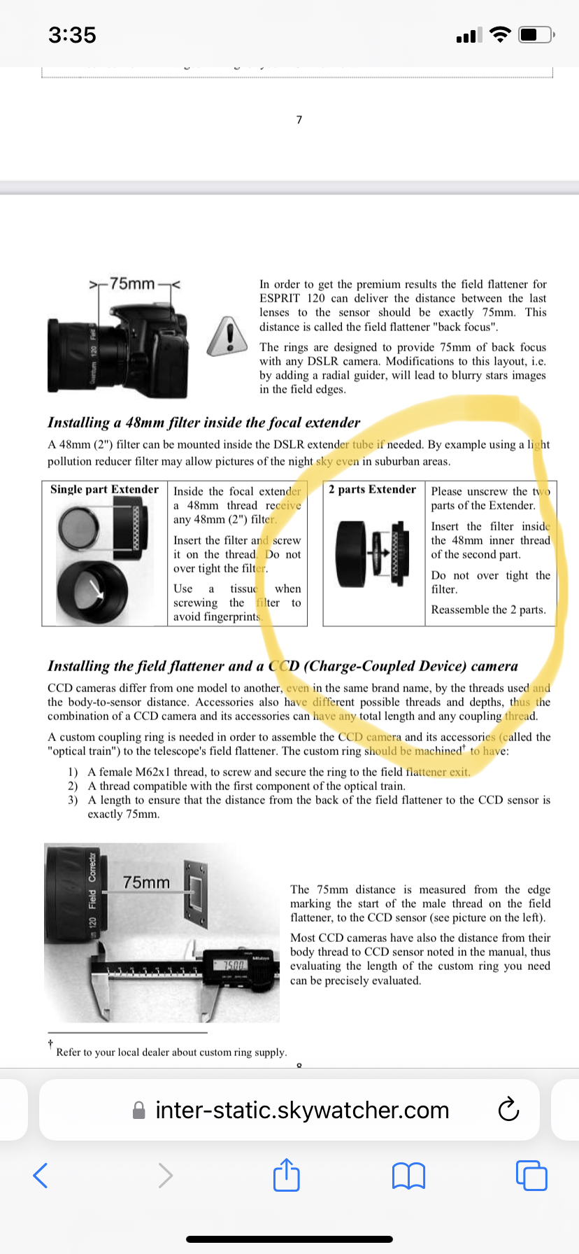

what accessories do i need to use a 2-inch l-ultimate filter with my esprit 120?
is there a way to just screw it into the esprit without changing the backfocus?

Filter drawer is required. I use the ZWO 2" drawer. You just pull out a spacer, or if you have an adjustable flattener, to subtract the width of the filter drawer from your backfocus. I don't have the specs on hand, but I believe it was 12.7mm for that particular drawer. I had the ZWO spacers for the ASI2600MC so there was a spacer of equal width.

You don’t need a filter drawer it will screw into the two piece extender that attaches to the flattener on the esprit 120

Yep - you need a filter drawer or filter wheel
Thx!
i will try it.

You could do that, but that means adding or removing it would be disassembling your image train, and your flats would need to be reshot every time
