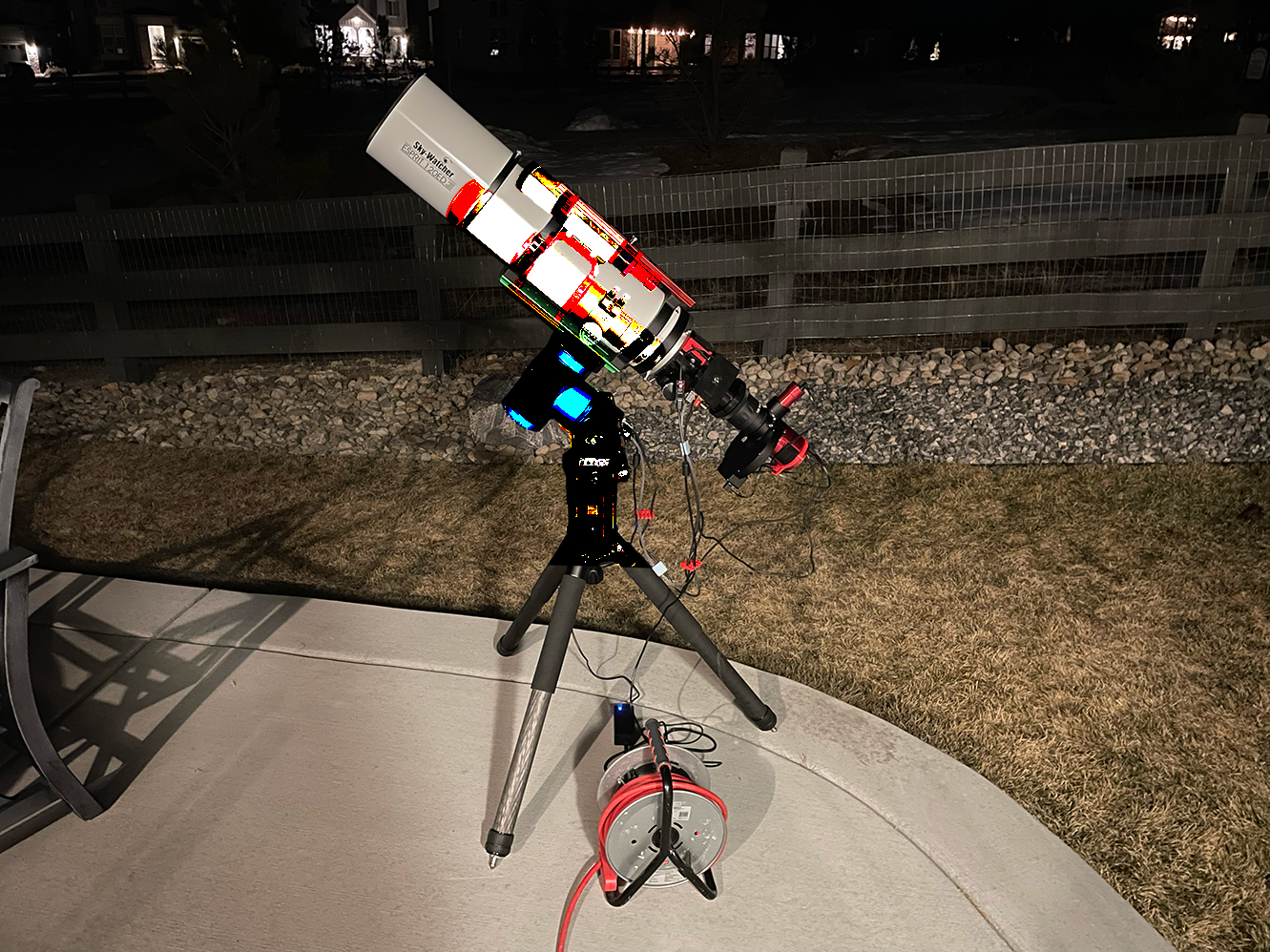

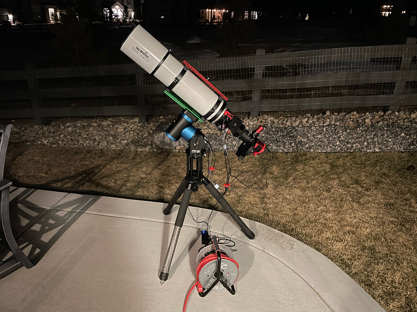

  • It's so much bigger than the GT71 (see second image)

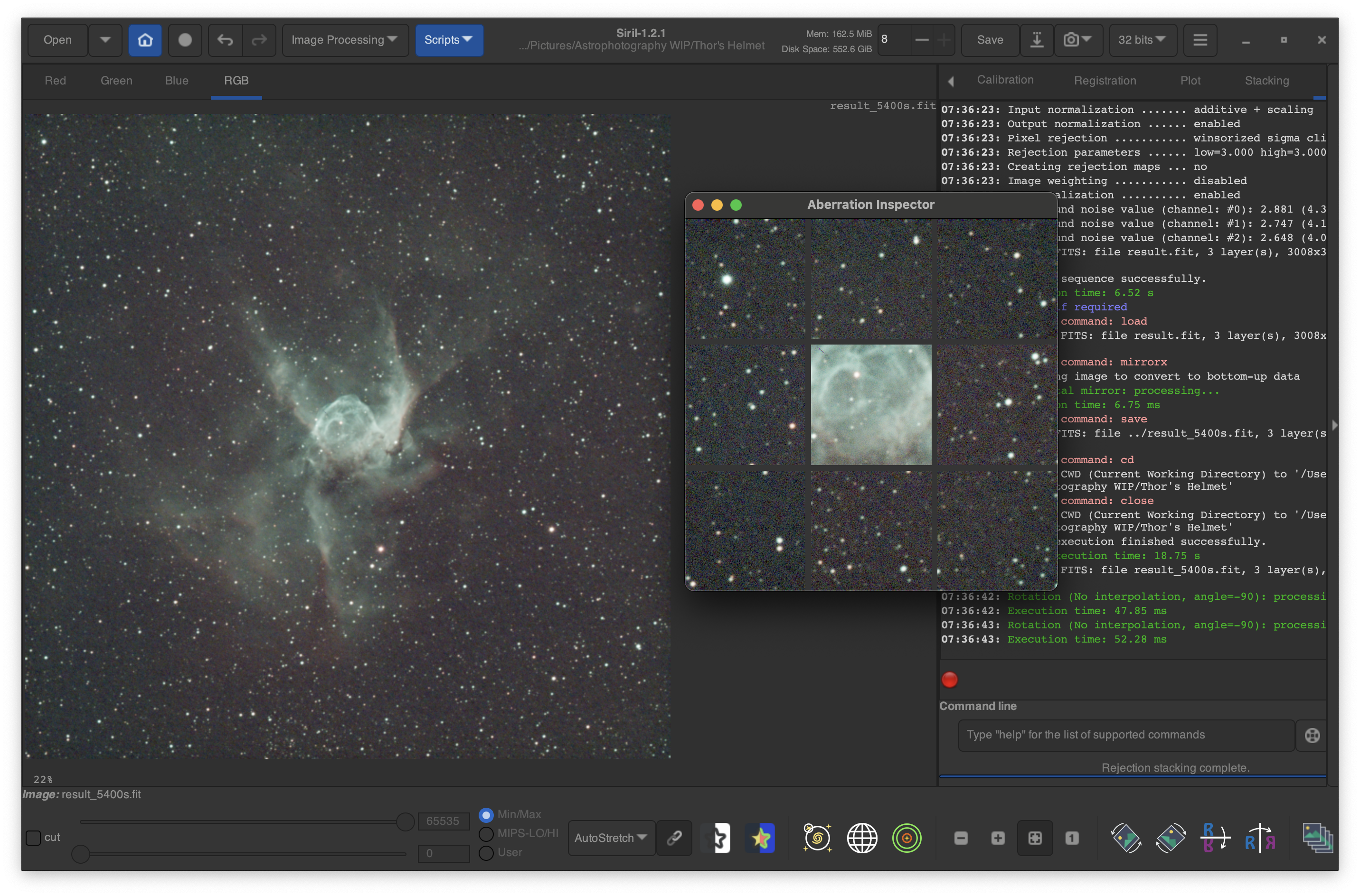

I have only been able to capture 90 minutes of data for NGC 2359 - Thor’s Helmet, but the results look promising!
Attached is a basic Siril stack and autostretch with no processing.
This is from a Bottle 5 sky using the Optolong L-Ultimate filter paired with the ZWO ASI533MC Pro. I am so happy that I don't have to fight back focus.

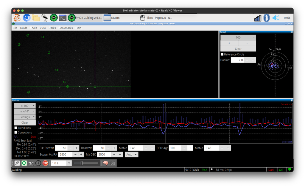

Guiding was also good enough for me:

I see no weight bag in use, tripod feet spiked meant to be embedded into soft ground but instead being used on concrete, a pier extension that "looks" like its not nearly rated high enough for that setup on a tripod recommended for 15kg payload, all holding up a $3500 refractor.
Noice.

Luka Poropat:
Noice.
"If it works, it works."
Total weight is 12.25 kg (OTA, rings, filter wheel, cameras & raspberry pi).
The default pier from Pegasus is 3 rods, so I’ve doubled that and it is very stable.
I found that the rubber pads introduced a lot of vibration, which others have also encountered on different tripods:
https://stargazerslounge.com/topic/414497-spikes-or-rubber-feet/#:~:text=I%20prefer%20spikes.,that%20makes%20it%20super%20solid
Thank you for your concern.
Alan_Brunelle
Not to sound fearful, but I always am when it comes to expensive precious gear.  But the photos, to me, look as if this setup could be unstable and fall over.  I will assume that you have tested all possible scope positions and even those that can occur during a meridian flip.  And at the higher speeds of a meridian flip.  While these mounts claim very good load support without a counterweight, these loads are dependant not only on how much weight they can handle, but also where that weight is.  To add to that, while the mount head can handle the weight, the stability of the whole thing depends on the footprint of the tripod.  And that tripod looks small for the scope.  Support is best when in line of the the legs.  However, the linear distance of the mount head center to a line between the feet is quite small and that is how the tripod will tip, given the chance.  So be sure to check that all out.
I can see how rubber pads could allow a bit of sagging as the weight of the telescope moves.  However, the translation of vibrations on the ground, such as walking or cars driving past will be transmitted to the rig much more efficiently with hard contact (i.e. spikes) rather than with rubber.  I think the lesson is that you should try to minimise being active around the rig during imaging.  And then it won't matter what you have on the feet.

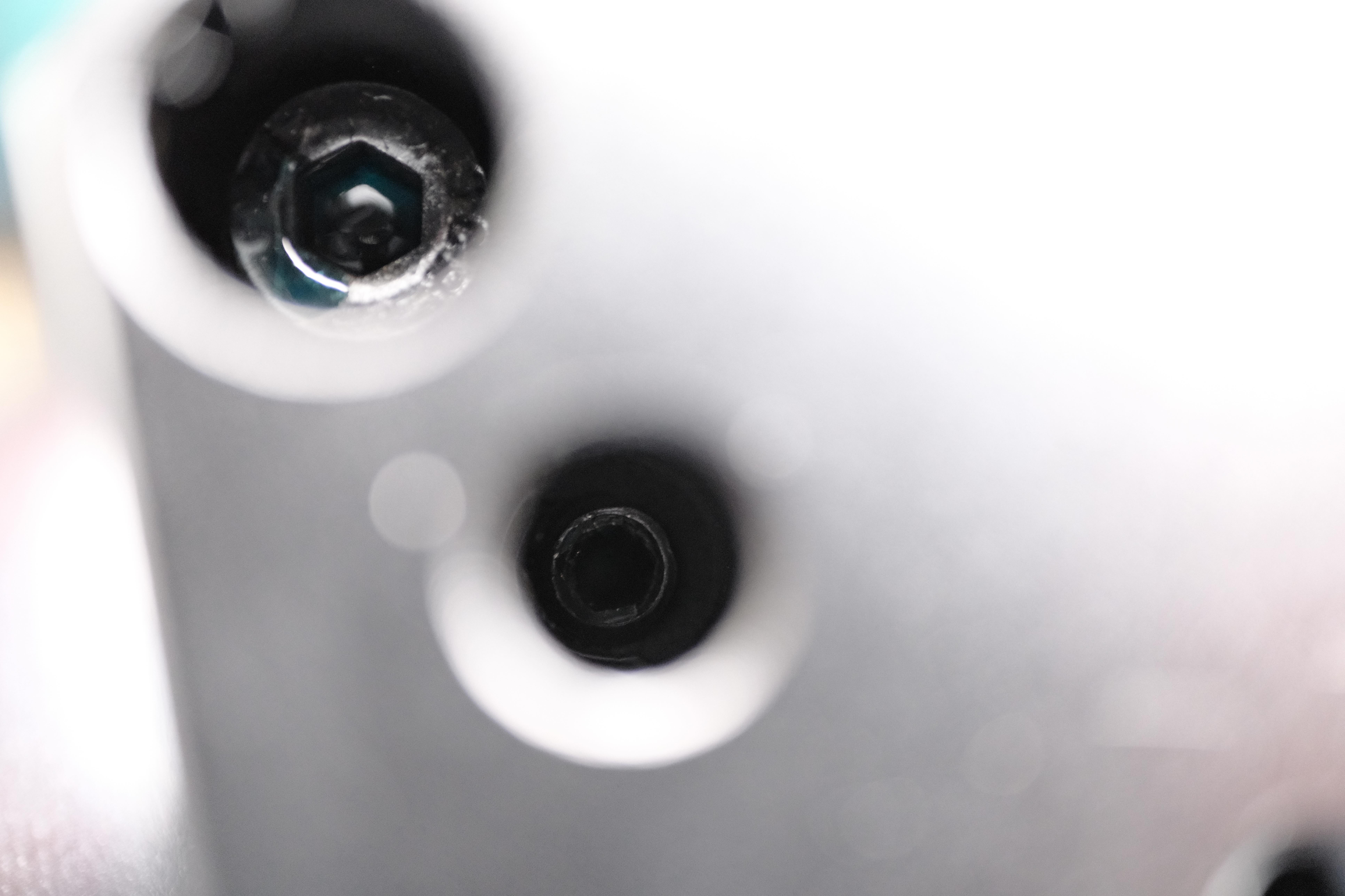

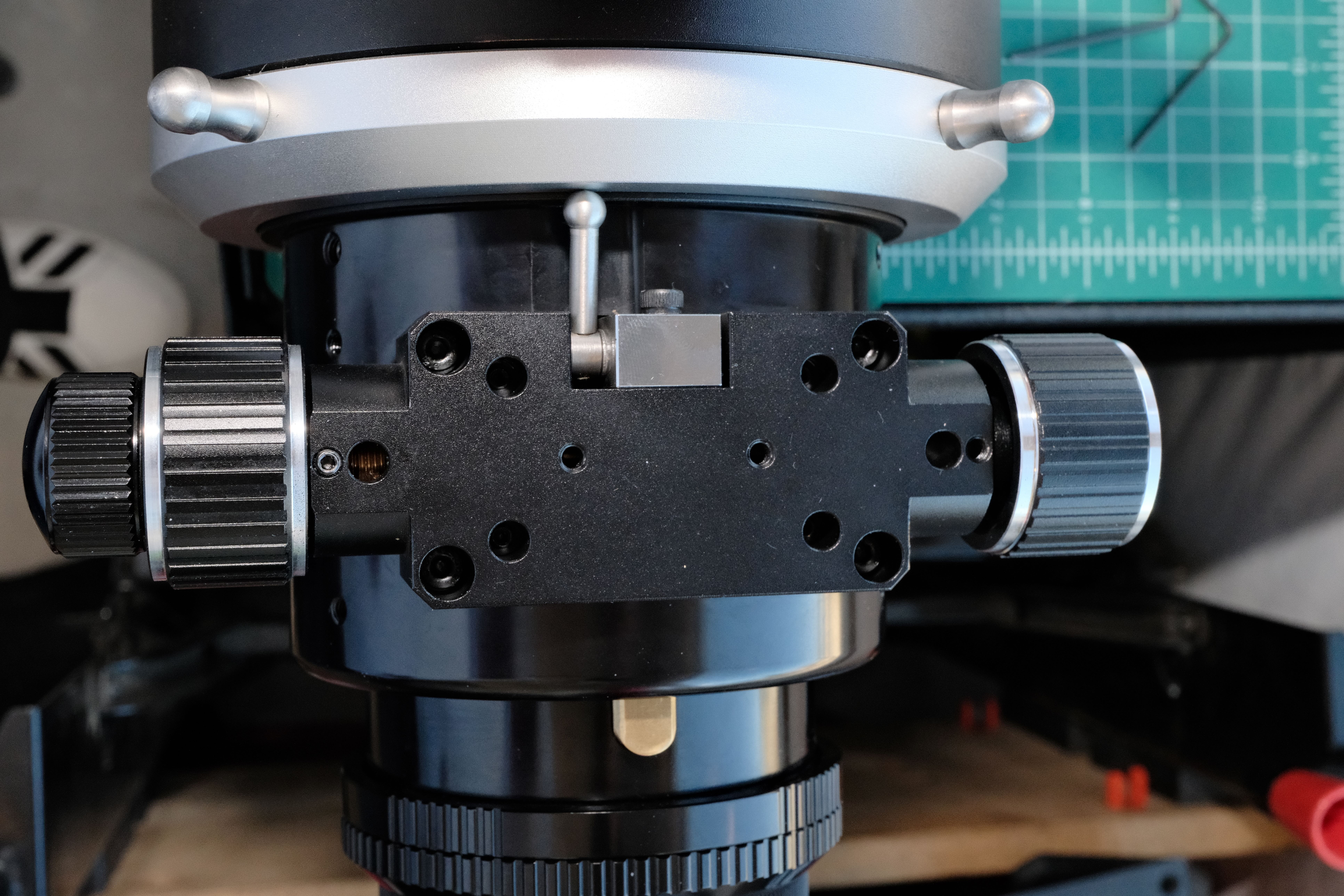

Update: I think there is something wrong with the focuser. The fine focus knob will stop at 55mm, 65mm, 75mm. If I nudge it past that point with the coarse focus, it will continue to work. I'm trying to use the adjustment screws, but I have no idea which ones to use. Sky-Watcher support says:
"Each corner has its own set of
screws. The inner screw is a stand-off,
while the outer screw is the tension.
You will need to balance those until
the focus runs smoothly."
I guess that means the screws aligned diagonally? It doesn't really matter, because they're all filled with blue lock-tite!
We'll see what Sky-Watcher support has to say. I'm beginning to regret not buy the WO 120FLT instead
Semper_Iuvenis 3.10
Why would you touch those screws?  The focuser lock is that compression bar. I put a sesto senso 2 auto focuser on.  Focus at about 80mm, almost fully extended.   Very stable focuser.
ryan_faulkner 1.20
Sky-Watcher support says to use those for adjustment!
I think the focuser was bent when it was packed: the coarse knob without the fine focuser has an obvious wobble to it.
I’m very disappointed with the quality and I’m fighting with my local shop to exchange this.
Semper_Iuvenis 3.10
The good news is that once you are in focus the focuser only moves a millimeter or two from then on.   My 120ed focuser has been at 80ish mm (almost fully extended) for the past two years. Autofocus 8 times a night in the winter.
