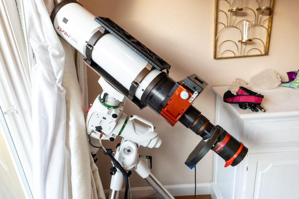

Scotty_Maxwell 0.90
This is the Primaluce ring set up I switched to when I installed the Moonlite Nitecrawler WR35:
seen on scope here:
Esprit 120 with Primaluce 155mm, 30mm risers

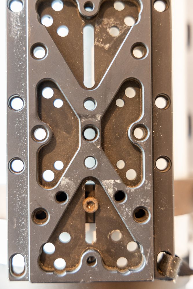

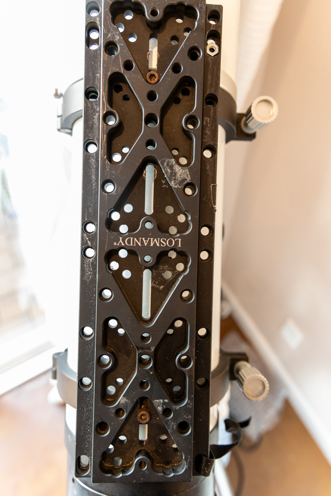

gmeyer 1.51
plenty of good responses...here's mine.0N0A6277.jpg0N0A6278.jpg0N0A6279.jpg0N0A6280.jpg0N0A6281.jpg

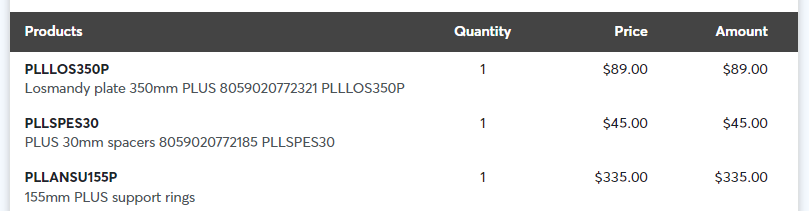

I replaced them with Primaluce rings and dove tail plate as well. The 155mm Plus support rings fit the scope. You will need to order support ring spacers as well.IMG_5116.jpeg
*Thanks Greg! Is that an 11" rail, or shorter?
Edit: I missed the markings, 14". Exactly what I'm looking to install.

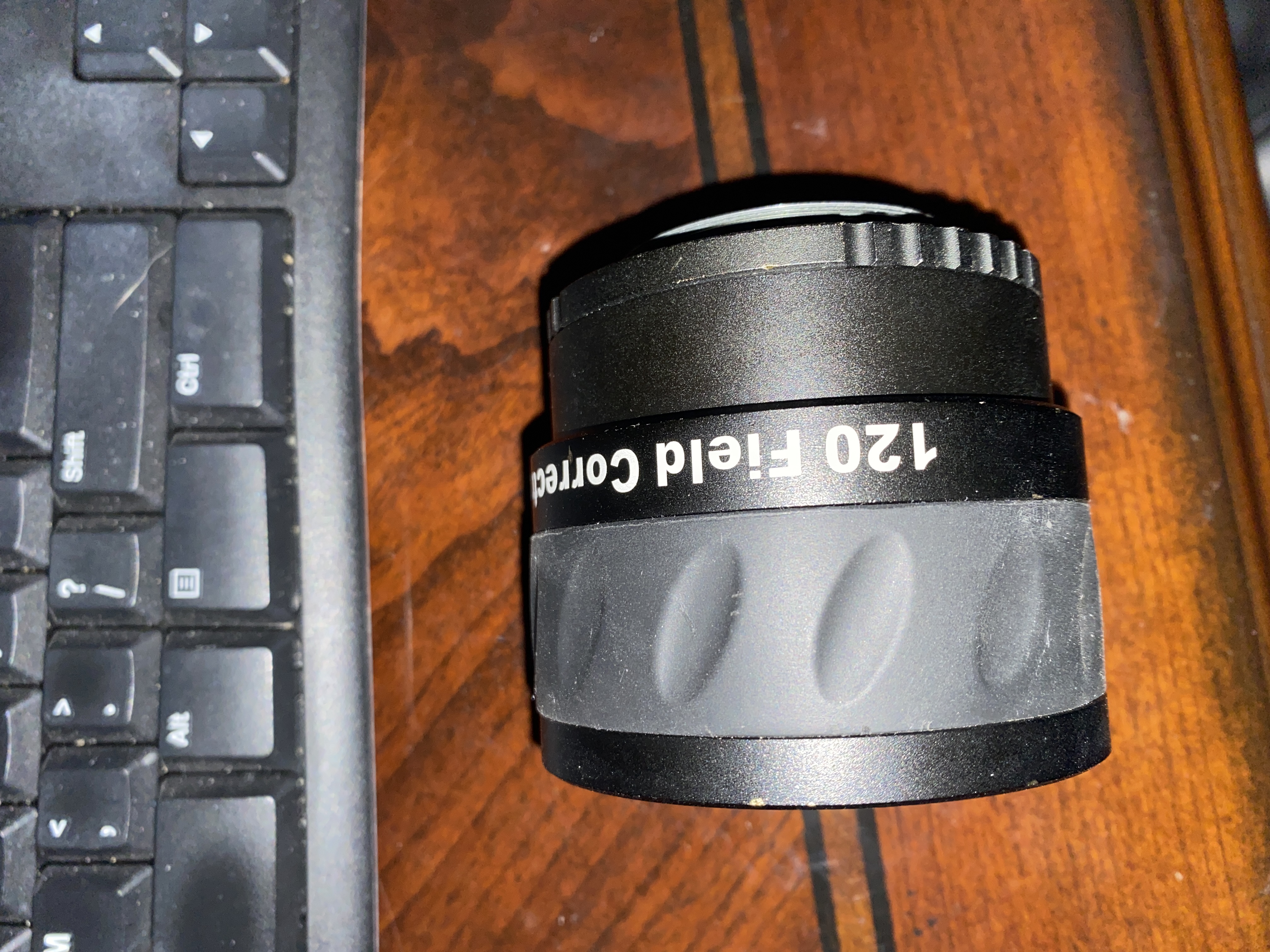

Very cool feature. I can't wait to get started. Could I ask you another question? I removed my image train from my old scope, SW Evostar120 with the SW 0.85 reducer/corrector, and plan to connect it to the Esprit120. I have exactly 55mm back focus. But, am I right that the Esprit 1x and 0.77x flatterners end with an M62? That is odd. But the correct back focus is 55mm from the flattener to the sensor, right, or is it 75mm? How did you manage the M62?
Thanks,
–Paul
woodp2001 0.00
image.jpgThe flattener and spacer that reduce the thread size to m48 and 55mm of back focus come with the system in the US. The picture is the flattener and spacer/m48 thread adapter assembled
ganymede235 0.00
Excellent! Many thanks. Just so I understand, using the M62 - M48 adapter included with scope yields a backfocus of 55mm from camera end of adapter to sensor?
woodp2001 0.00
Correct
