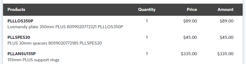

This is the Primaluce ring set up I switched to when I installed the Moonlite Nitecrawler WR35:  seen on scope here: Esprit 120 with Primaluce 155mm, 30mm risers |
I replaced them with Primaluce rings and dove tail plate as well. The 155mm Plus support rings fit the scope. You will need to order support ring spacers as well.  |

Patrick Wood: I replaced them with Primaluce rings and dove tail plate as well. The 155mm Plus support rings fit the scope. You will need to order support ring spacers as well. Interesting... I did the same thing with my Evo120. Not Prima Luce, but another generic brand. The flat tops of the rings seems essential.
