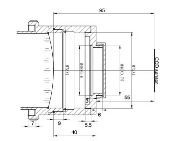

The backfocus of the total 0.77x reducer is 95mm. (55mm from the top of the start of the M-48 male thread). If you put a filter, which can be placed inside the reducer itself, you already know that 1/3 of the thickness must be added, in the optolong 0.6. Therefore the total with filter would be 55.6 mm. I have never used 60mm  |
If you're using the flattener/reducer that comes with the Esprit 120ED, you'll need a back focus of 95mm. For the flattener only, 75mm. This is measured from the bottom of the threads of the flattener/reducer to the sensor of the camera. See pages 8 thru 12 of the user's manual for your scope.

I have both the flattener and the esprit .77 reducer for my Esprit 120. The additional back focus needed from the dedicated spacer that is suppled with the reducer and flattener is 55mm on both systems. Yes the focus position changes. In my case from 16000 steps to around 6000. This of course is dependent on the step size of your focus motor.
note: because I shoot mono and my chroma filters are 3mm thick I add 1mm to my back focus for a total of 56.

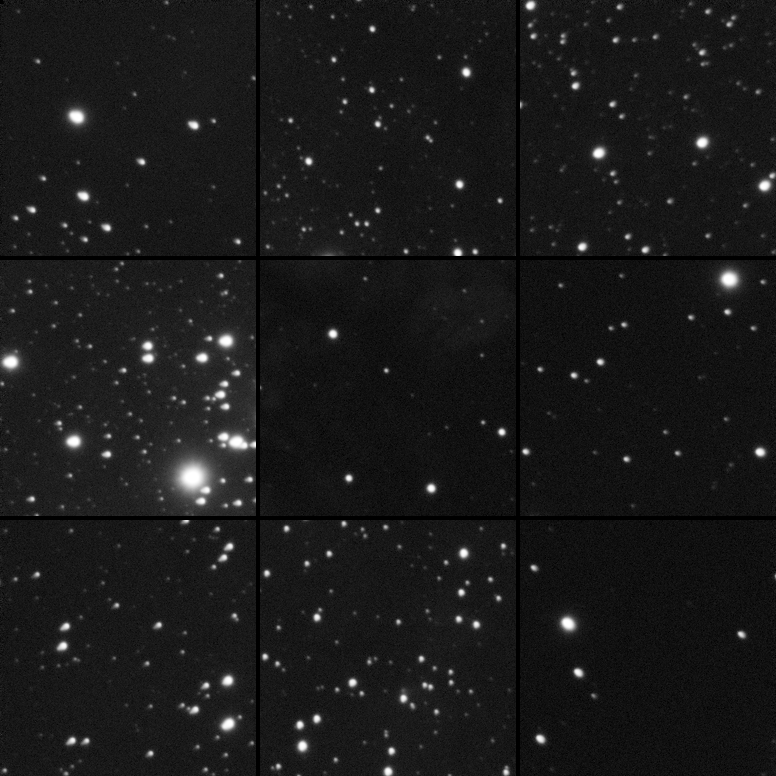

Hi guys, seems like, im not the only one having funky stars, using the reducer. tomorrow i will get some spacers (1mm and 0,5mm) and i will do some trial and error from 55mm all the way up to 60mm. i watched locamaticos YT video about the reducer and in the comments, he wrote that 59,5mm gave him good shaped stars. Lets see, will give an update eventually
I think you have the same problem I had which is a dud reducer. I got all the way out to 62mm of back focus and couldn't get round stars. The focuser would stop around 1000 steps. I finally decided to just purchase a new reducer and I now get perfect (to my eyes) stars across the field with 55.6mm of back focus with filters. Now it's in focus around 7200.
If you have the ability to return or RMA your reducer and get a replacement, I'd say give that a try!
Thank you for your advice. Since i bought it recently, i will definitely change it, if the spacers won’t help. what bothers me is, that the stars are egg shaped not only in the corners but everywhere in the frame. So, its not that typical backfocus issue (too far/too close) rather „vertical-egg-stars“ even in the middle, not changing the orientation or shape. will give an update with the final solition.
