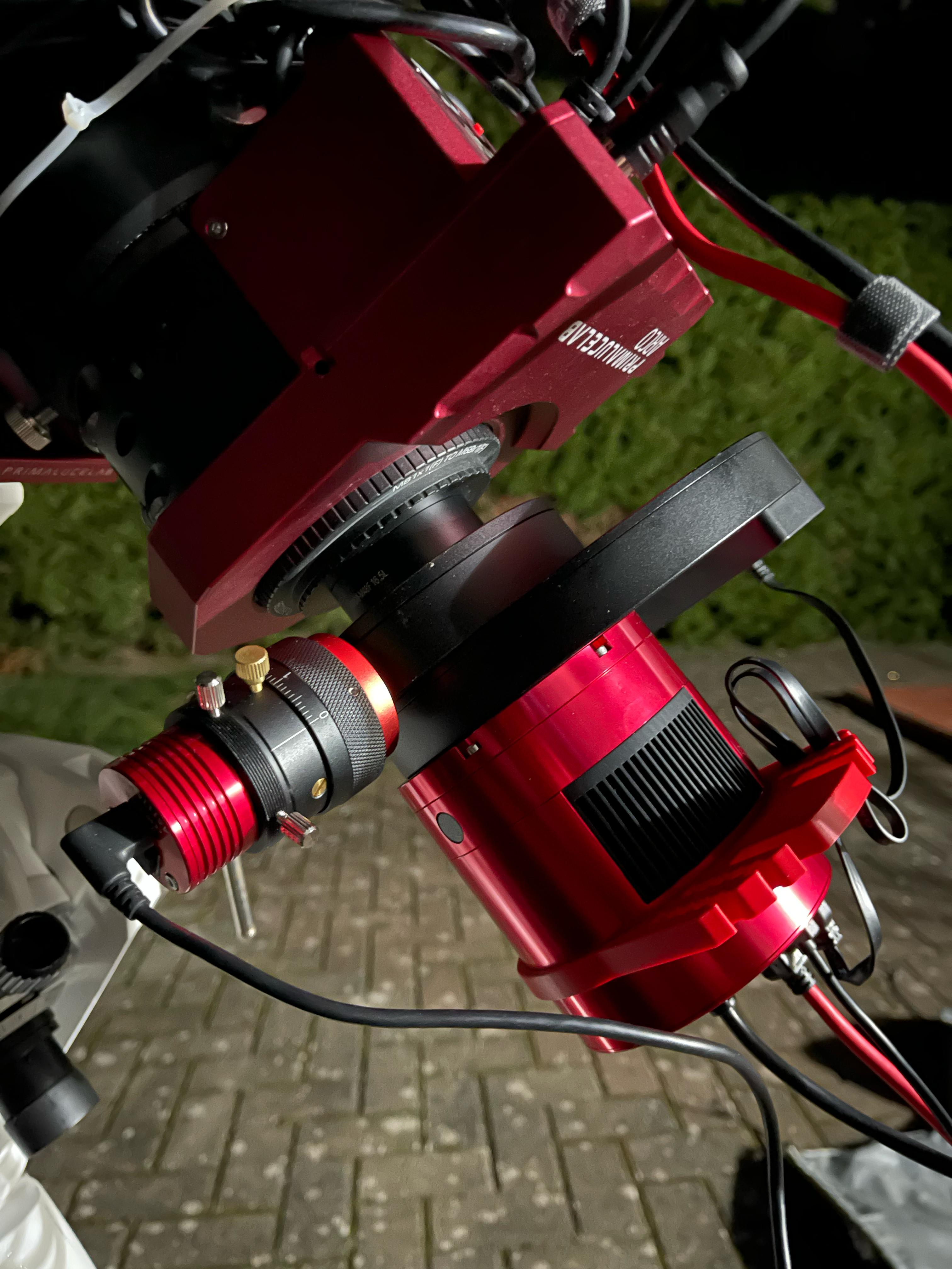

I think I followed those instructions, I'll attach a photo where you can take a look.
So from the camera to the OAG is 55 mm, and after that I first attached a 40 mm adapter and it didn't work, last night I put a 16.5 mm + 1 mm spacer, so a total of 72.5 respecting the thickness of the filters that move the focus a little. So even with that 16.5 mm adapter it's too much, it probably needs a shorter one, that's why I wanted to find out how far your sensor is from the m48 thread that is attached to the riccardi.

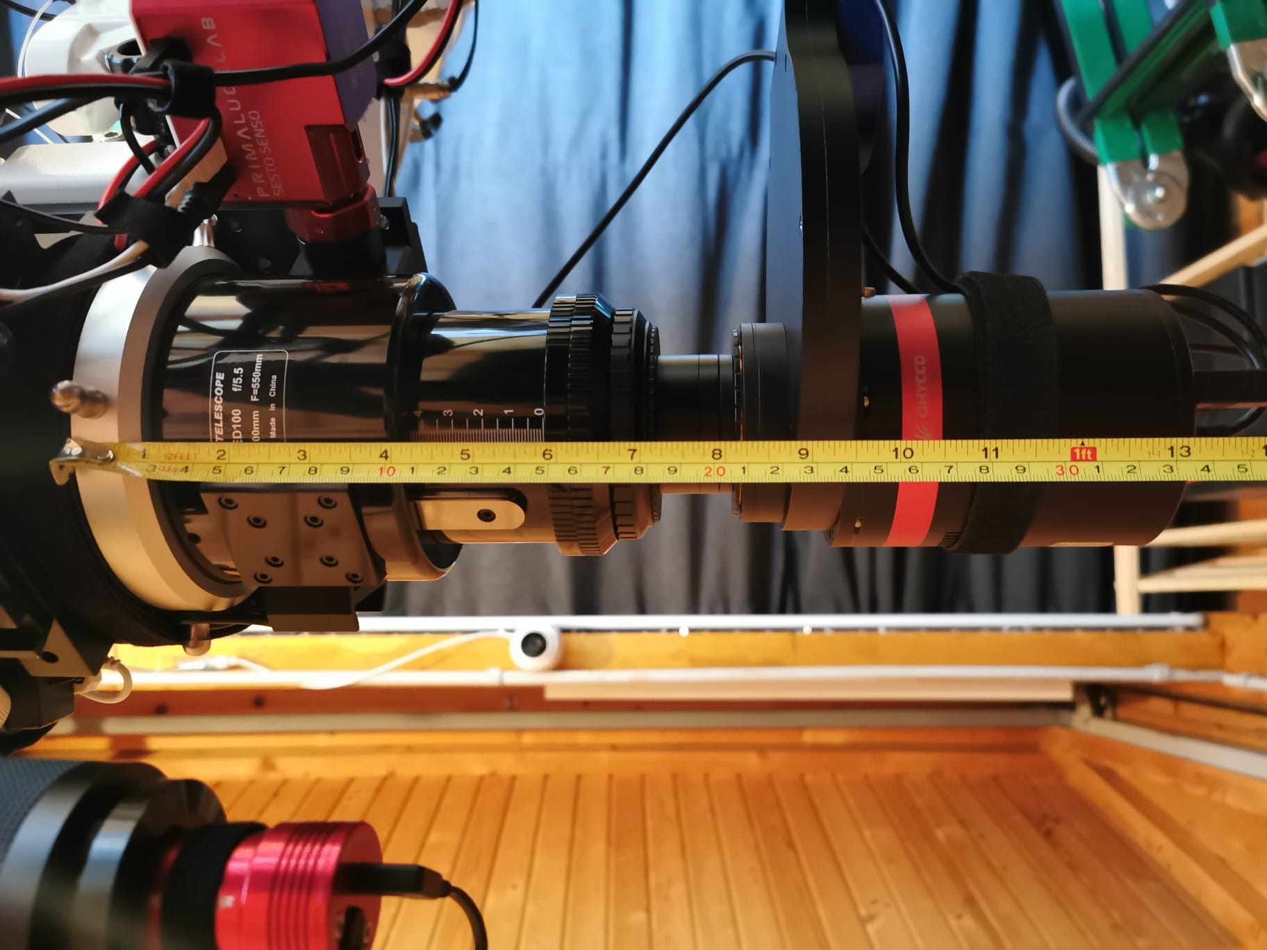

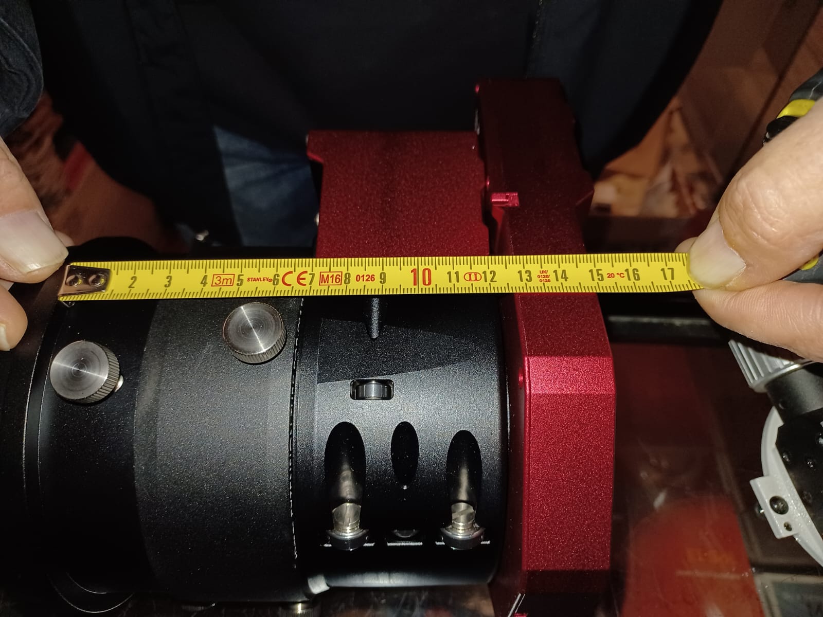

I have recovered some images of how I calculated everything.
My backfocus from the riccardi to the sensor is approximately 77.80, that is my starting point. With essato or without it. I used the riccardi before changing the focuser, if you have put it new, its backfocus is enough. 77-78mm.
Yo u need more spacers.

Thank you very much for your help Tonismile I realized I was wrong after seeing your pictures, where you measured the distance from the first adapter to the Arco and it is 150 mm, on my telescope it is 175mm.

A picture is worth a thousand words.smile
I'm glad you found the error, now let's see if you enjoy the team with this change. I wait for news.

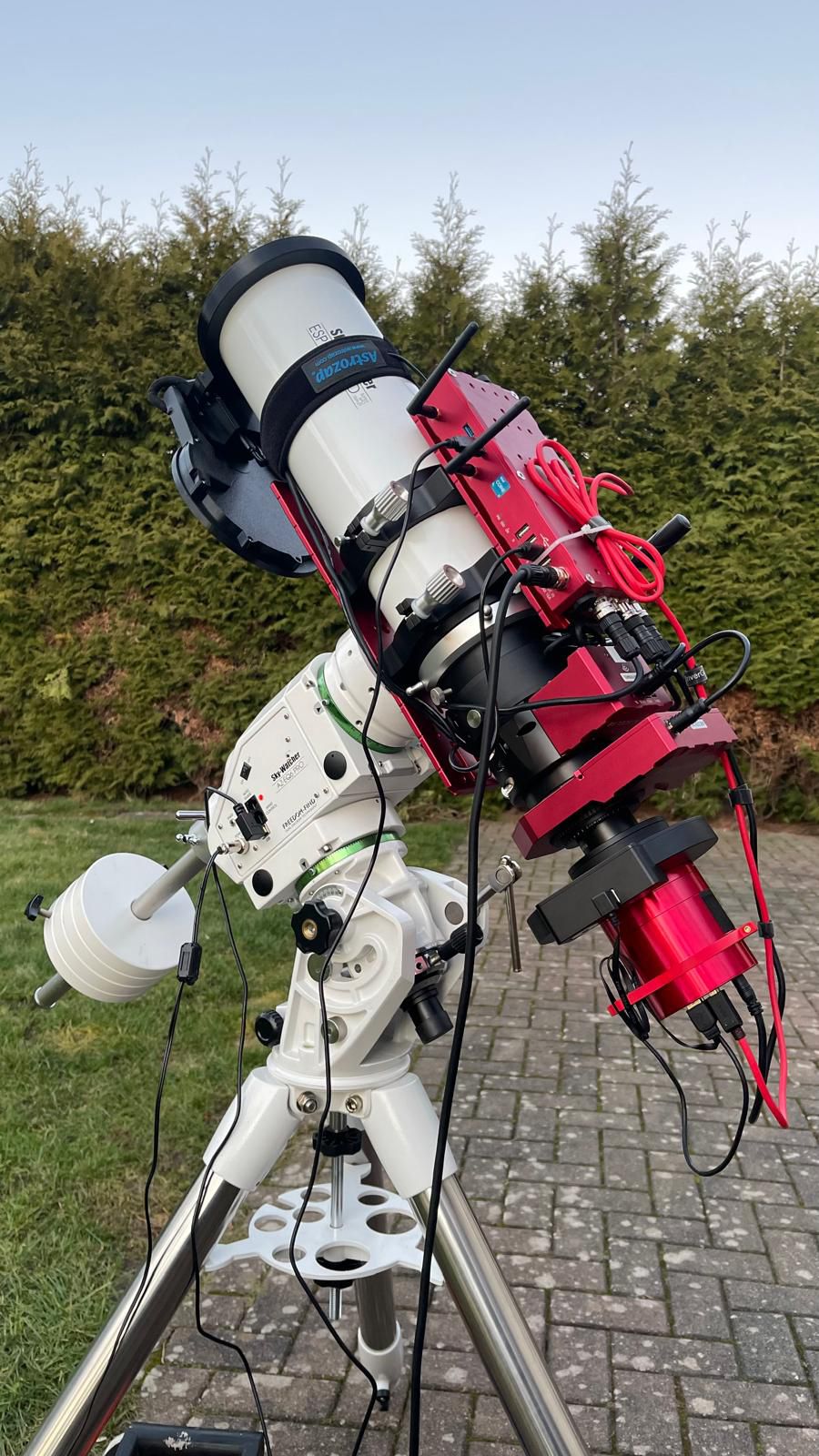

p.s. I will upload a picture with my telescope ​​​​​​

I'm glad you're finally able to focus.
The tilt issue shouldn't be happening; this must be a very strong block. I hope you can fix it.
