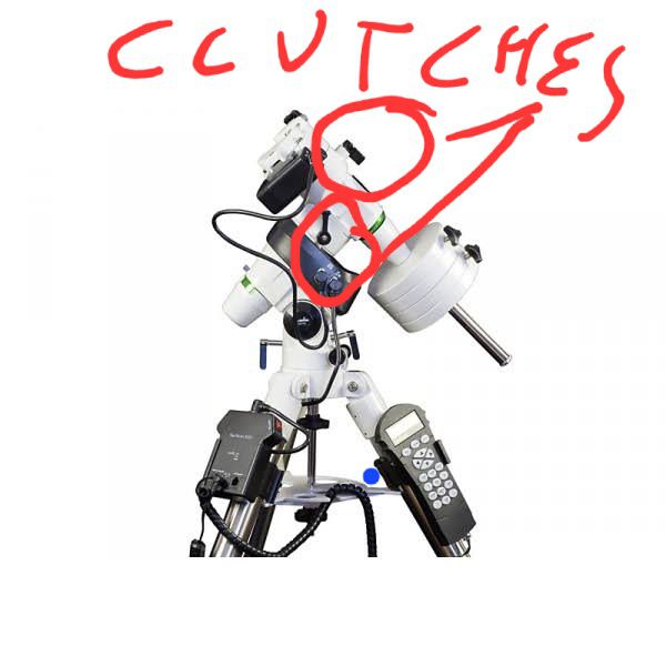

Have you checked that the clutches are engaged?
GalactoseIntolerant 0.00
What do you mean by engaged?
It means they are closed down so that the mount isn't free to move just by hand. If that is the case then I can only suggest you open the motor enclosure and see whether the gears/pulleys are actually moving.
PhilosaurAstro 0.00
Clutches must be closed so that you can hardly move it manually
afettoxiulong@gmail.com 1.20
Please double check that both axis clutches are closed or mount can't move.
released them 'till you can smoothly move your setup on both axis, put your mount at "home" position and then close both clutches properly.
with eqm35 if you don't use any device like asiair or astroberry, you also have to perform star alignment before proceeding to any target by goto hope this might help. This mount imho is simply fantastic! shopping.jpeg

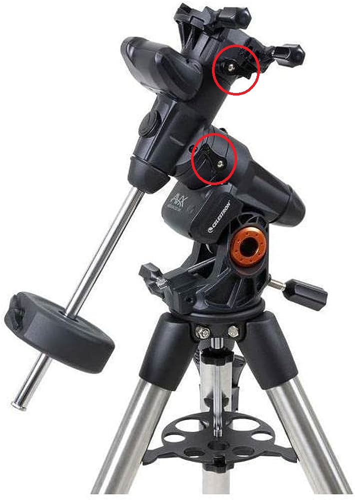

This was happening to my AVX mount, the clutches were not engaged (in my case, they are two small black handles; one close to the DEC motor and one close to the RA motor).
It was making a rough whirring sound, but not doing anything, it moved a little sometimes on one axis because one clutch was engaged more than the other. I was about to sell the mount, because I thought it was defective.
