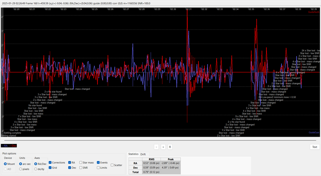

Daniel Petzen: I forgot to attach the PHD2 log; Please find it attached: PHD2_GuideLog_2025-01-27_205755.txt

There are only minor guiding artefacts, and it looks like the Centaurus A image has less guiding artefacts.
Don't get me wrong; I'm happy with both images. A few hours more integration time tonight and they'll hopefully turn out quite good, but I was hoping for a much lower RMS error, which, in my experience, just subtly does wonders to the end result when it comes to clarity and details. Out of curiously... What kind of RMS performance were you expecting from the mount?

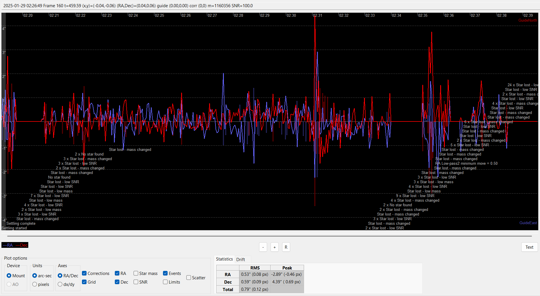

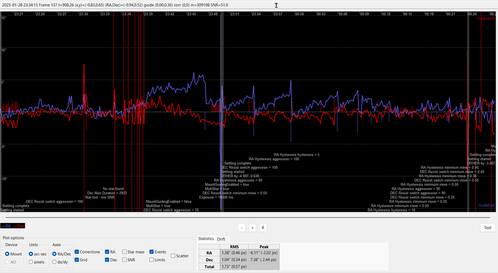

I tried to take a methodical and scientific approach to my attempts at guiding last night, but it did descend into chaos fairly quickly. I disabled PPEC, switched to a 400mm guide scope (from a 190mm), I verified polar alignment and double checked everything. I too an unguided image of NGC 1532 while I was running the guiding assistant and it looked great:  The PHD2 guiding assistant was very inconsistent and reported a backlash of 2210-3107 with very different graphs, but I did run it against NGC1532 that was sinking fast (60-35 degrees 23:00-01:30), so the position of the telescope was different. The second unguided sub was a bit worse:  I tried the following: 1. Unguided: worked well early in the evening (NGC 1532 lat > 40) 2: Bump guiding (RA MinMove 0.5-1, exposure time 8s): this worked very well to start with, but RA started to slip to the north when the altitude decreased (graph below) 3: High MinMove and aggression: I tried with 10s, 8s, 5s, 4s, and 2s exposures and MinMove 0.25-1, but the guiding was going past 1.0" RMS at this time, not matter what I did 4: Encoders switched off:: I only did "full" guiding liek this. PPEC didn't seem to have any impact. I saw both improvements as well as problems (spikes). 5: Switch back to my old 190mm guide scope, full guiding RA+Dec, 2s exposure, no encoders: this dropped the RMS error from 1.15" to 0.7", but I only got 10 minutes before the clouds rolled in. This is the PHD2 log from about an hour's worth of experimenting:  This is the log from when I ran EQ6 style, i.e. no encoders, 190mm guide scope and full PHD2 guiding at 2s exposure (with a lot of star lost because of clouds):  This is the full PHD2 log for the evening: PHD2_GuideLog_2025-01-28_194122.txtGetting high precision tracking last night was extremely frustrating (there may have been some swearing in the night), but 95% of the subs were stable enough to pass a blink test (a unusually kind Blink test, but still...), so I can get by with the guiding I have with my current equipment, but most of my future plans are on hold for now. It'll be until next week before I'll have clear skies again. Yet again, thanks to everyone who has helped me with this. I really appreciated your help and advice. I learnt, the hard way, that the best way to become a better astrophotographer is to listen to those who has more experience than yourself.

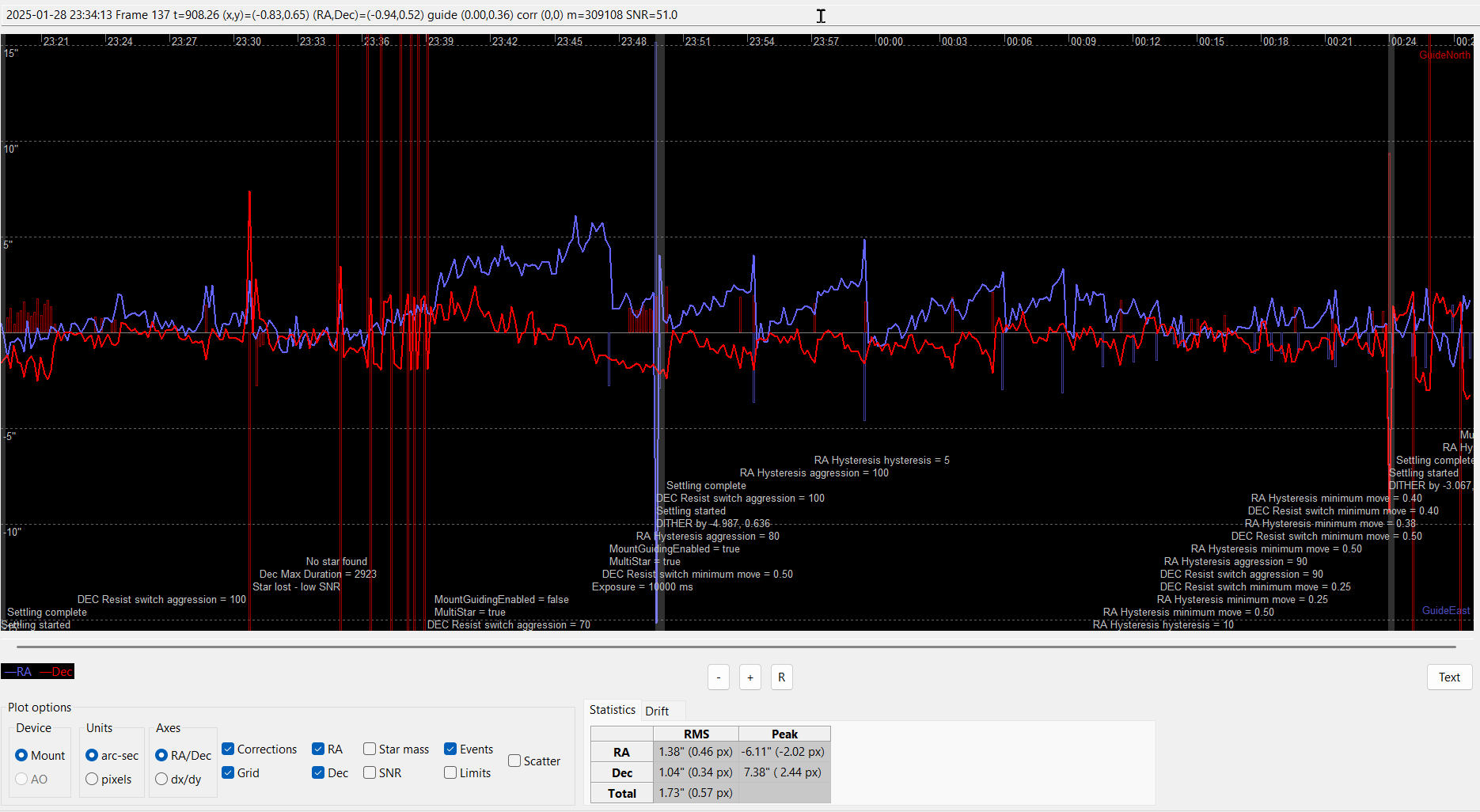

Daniel Petzen: I tried to take a methodical and scientific approach to my attempts at guiding last night, but it did descend into chaos fairly quickly.

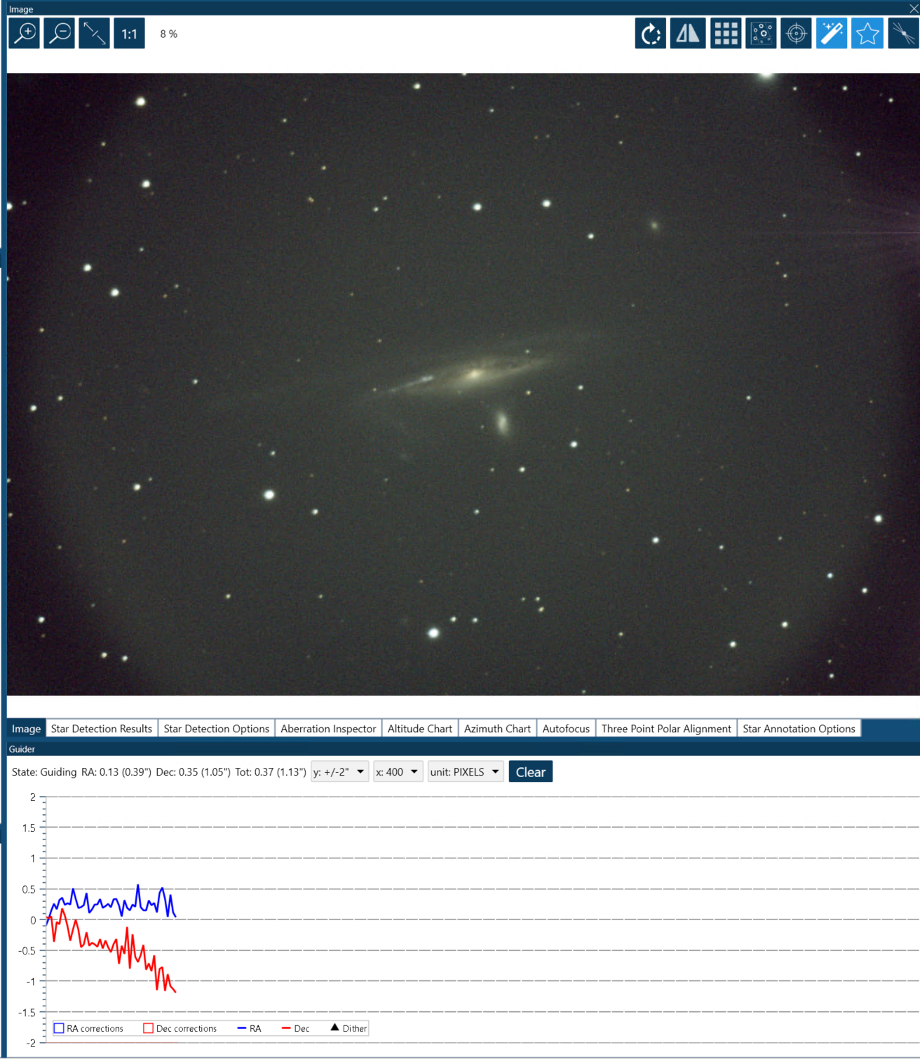

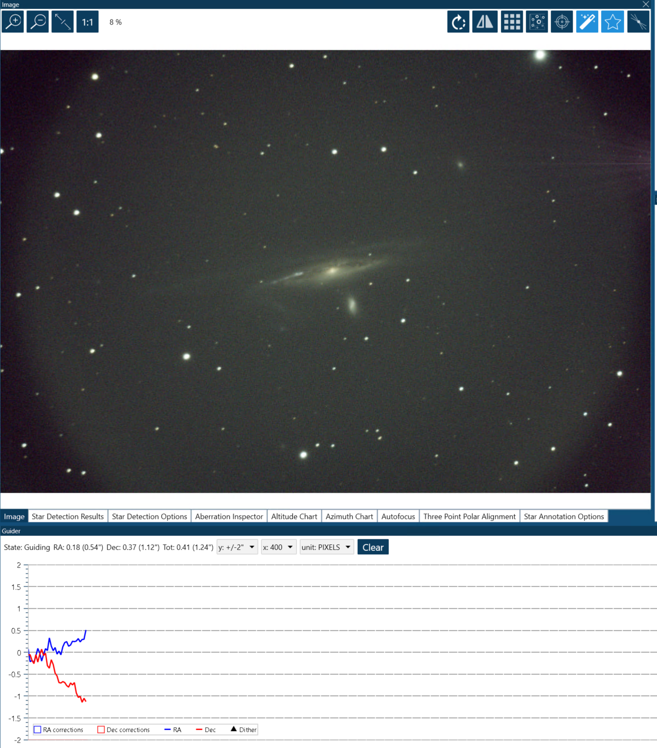

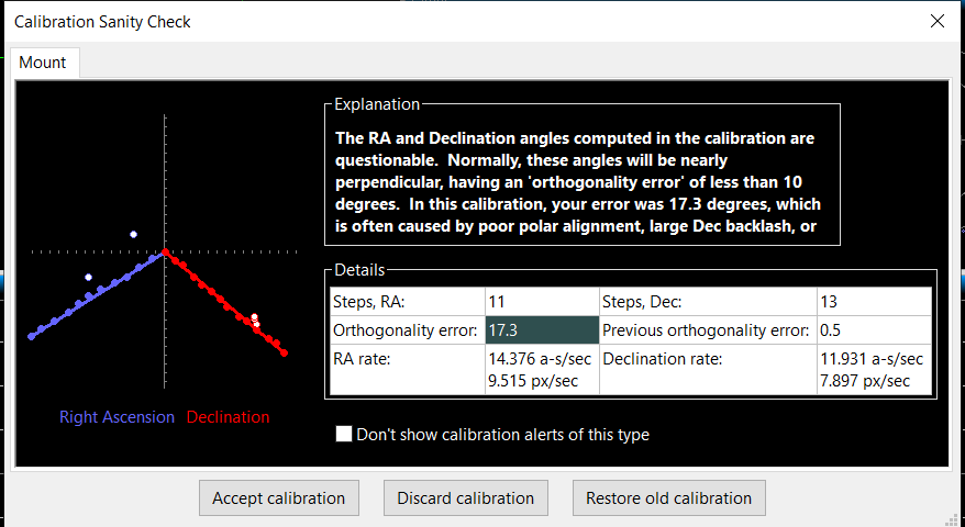

Yet again, thanks to everyone who has helped me with this. I really appreciated your help and advice. I learnt, the hard way, that the best way to become a better astrophotographer is to listen to those who has more experience than yourself. I actually find the PHD2 guiding assistant very hit and miss too, the figures it reports on backlash and in PA are always different and sometimes a lot different, as in your case with your backlash readings. This does not help your cause either as you have no real idea how much lash you actually have, I wish they would sort it out, and make it more reliable and more accurate.

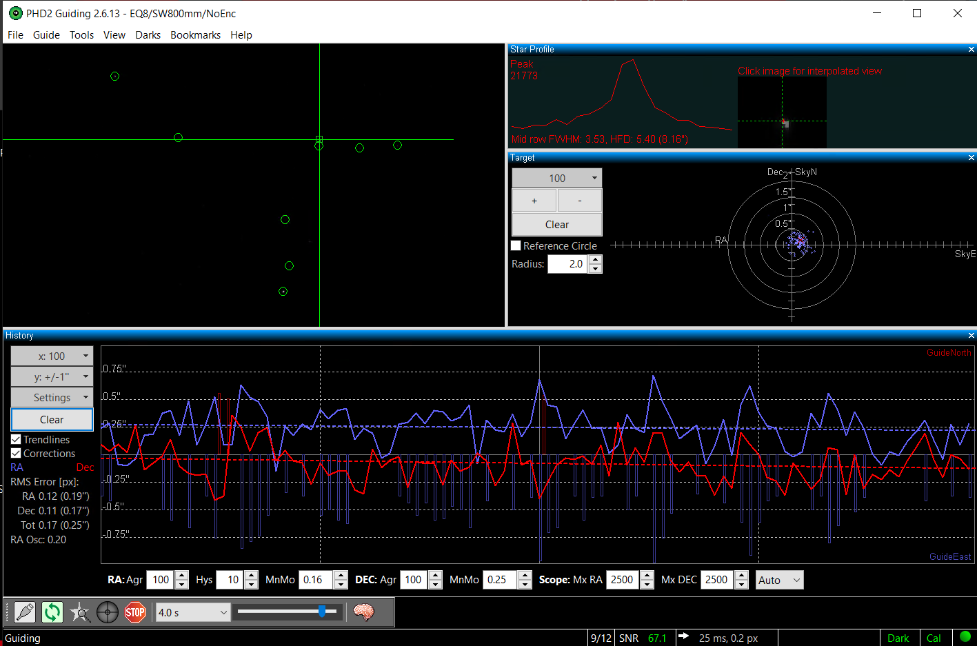

Your Daniel Petzen: 4 nights, close to 30 hours troubleshooting, tantrums, words, angry emails, and, of course a lot of help, and I could take this snapshot before I went to bed last night:
 That didn't come easy. I've tried pretty much everything, including some mad stuff.
I still need to analyse all the final settings and logs, but I think the key was to find the right adjustment frequency, so the most important part was to find it at 4-6 seconds exposure (guiding delay didn't work).
Worth noticing in addition to the settings in the snapshot is:
- Encoders on
- PPEC/adaptive PPEC off (jury is still out on that one, as I think it need more training)
- Hysteresis for RA, ResistSwitch for Dec
- Using an 800mm guide scope (I may get an Celestron OAG, my ZWO OAG just doesn't work), but the focus is still terrible
- Backlash compensation + guide direction auto (I had guide North or South to avoid backlash to start with).
- Dither in RA only - it did WONDERS for how dithering affected guiding. It went from chaos to unnoticeable.
This I'm considering
- Camera suitable for guide scopes (IMX 462 based)
- Celestron OAG
- Finishing building my pier
- Dual Losmandy saddle. I want to run have both my telescopes mounted at the same time and can use my Askar 103APO as guide scope.
- Zero backlash upgrade
There is much more to do and I need consistency above all, so PHD2's comments about backlash and failing to pulse the mount are still worries.
For instance PHD2 said this after my last calibration:
 I then went on to do 2h19m at 0.4" RMS and then 1h 0.33", so I'm not sure how serious to take this.
 The polar alignment was near perfect, but the backlash was reported at 3,212ms.
