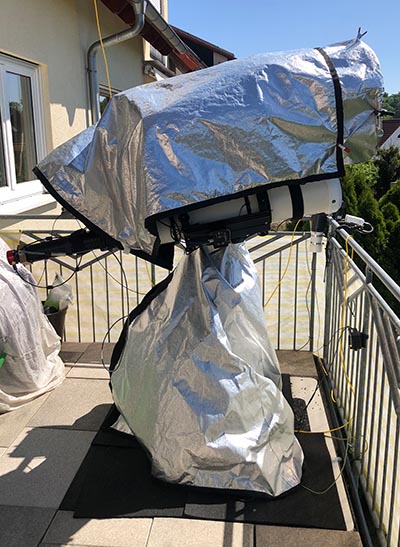

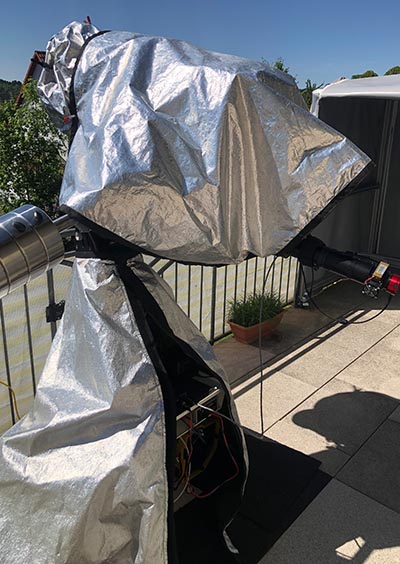

In my opinion there’s no danger to leaving your mount outside during the day. Don’t forget, people do solar imaging during daylight - this is more stressful than plain storage.
Reflective coverings are a good idea. And make sure that the mount is dry and free from dew before you cover it. Heat isn’t a problem for electronics, metal and lubricants, but humidity is a different beast.
I leave mount mount *and* OTA/camera outside under a reflective cover during good weather periods. And my mount stays outside even for a few rainy days.
Maybe this eases some of your concerns. I don’t think you damaged your mount.
