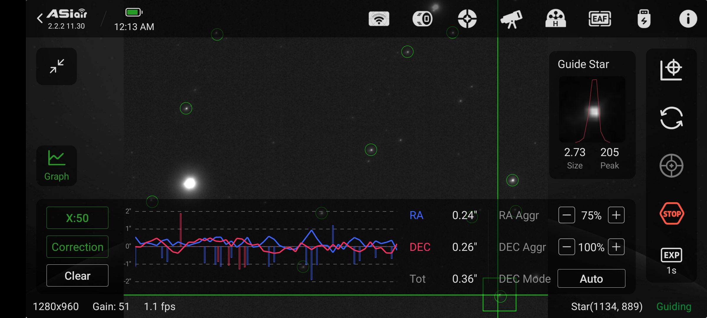

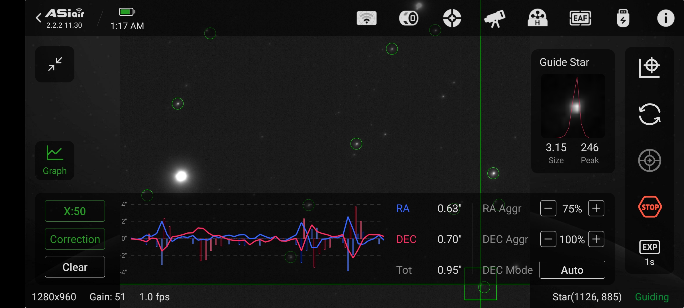

The spikes in guiding that occur. 1000000940.jpgThe guiding going from good to bad.1000000942.jpg
I need to grab a timer to see if the spikes are periodic or random.
Despite the spikes appearing in both DEC and RA I'm only getting elongated stars in RA
