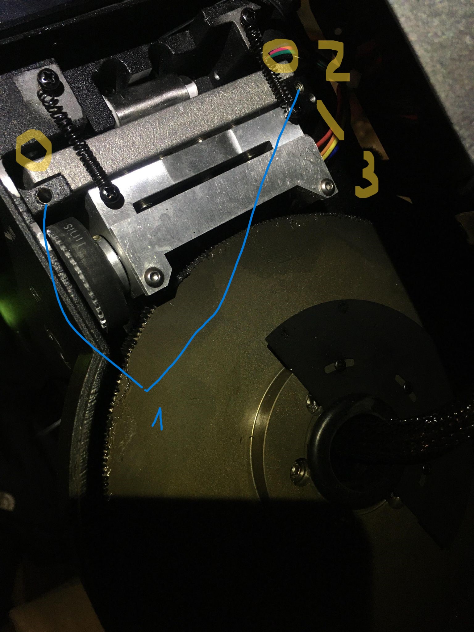

  1. the lower end stop adjusting allen screws (gear ON/engaged)
  2. the upper end stop adjusting allen screws (gear OFF/disengaged)
  3. the allen screw that maintins the floating assembly tight AFTER adjusting play
  4. In the middle, the 4 allen screws to tune the play (but they are already described by Skywatcher)

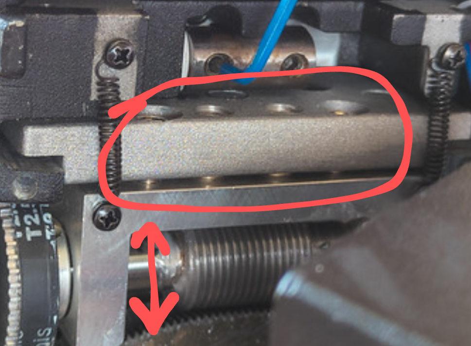

battleriverobservatory 6.06
Philippe Germon:
There are more than 4 allen screws.
There are also 2 allen end stop screws for the lower (wg/w ON) position and 2 allen screws for blocking and maintaining the floattng assembly - how could I say? - tighly.
if those 2 last screws are not adjusted, then the floating assembly is floating when gears are engaged. Then the mount can't guide cause the floating assembly is...floating.
So, there is no precision.
Adjustting the play is made of 8 screws.
 Touching the other screws wasn't necessary in my case. Everything else was tight and as it should be. I was able to adjust up and down engaging the gears as much or as little as I liked. Can make it grind all day in any position if I want. That's not the issue here. Once locked down there's no "floating". Video proves that.
You shouldn't have to adjust those other screws though. You can get mesh as little or as much as you need just moving the 4 in a row. I see no reason to adjust the other screws. Just use feeler gauges on each side to keep it the same.

@Matthew Proulx :
Well, in fact, the upper end stop are perpendicular to the floating assembly.
The lower end stop are angled.
So, sometimes, after "accident", when re-tuning the play, you need to re adjusting the low end screws. Don't ask me why : it's only my return on experience.
Because what appears is that after tuning the wheel play (sometimes), the floating assembly is not tigh and is floating when engaged.
The low ends screws are like "centering"  because of opposite angle and the tightening screw, then is maintaining the floating assembly tigh.
The tuning on this mount is complex and each part of the tunig is "interactive". So, sometimes, you have to do a lot come and back like :
- "This one is good? Oh ok."
- "Now let's check the other one."
- "Ok, back to the first."
And back and forth...
