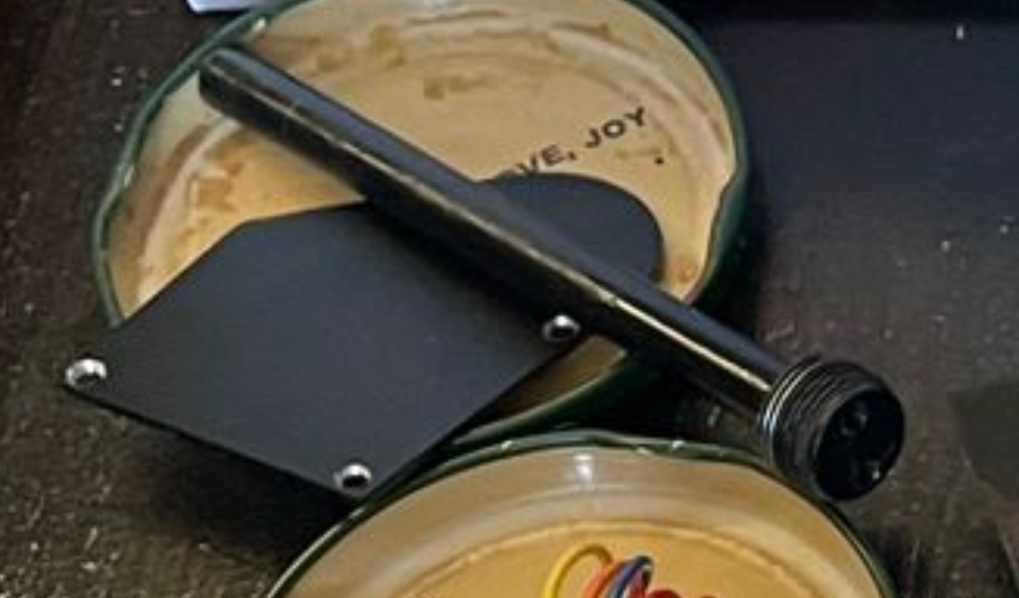

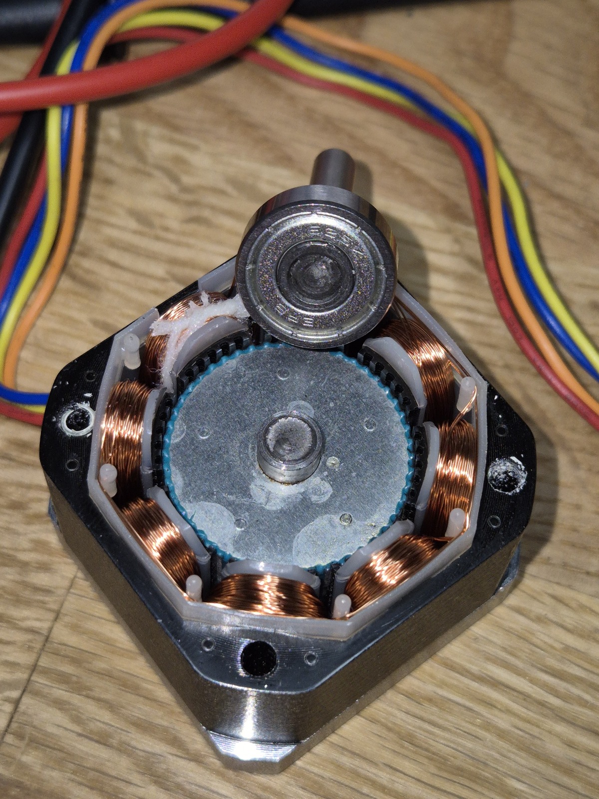

And here's an image of our motor, which was jamming - after opening the housing the shaft just fell apart!

Wow I can’t believe that shaft just broke.  That’s wild.   Ok so I don’t even have to take the 4 Allen screws that adjust the worm to ring mesh?  I need to get that plug off and unscrew that brass bolt and remove the unit.  I will make sure to document it so that hopefully it can help someone.   It could possibly even help your people out in Namibia.   It’s not fun wondering if you’re doing it right lol.   My issue was exactly as described by Nico.  It was a consistent issue more or less depending on the pointing in the sky.  After zenith was not as bad as before but still the same issue.  Thanks so much for responding again and I will respond back here for sure when I update the video with the worm drive out.

Nico, the motor shaft broke at a groove (read stress concentration) at the point of highest moment. I would suspect too high a belt tension and I'm surprised the bearing nearest the break didn't go bad first.

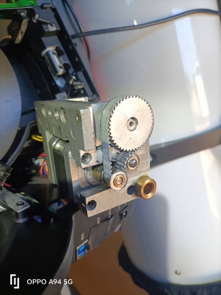

Bumping into the discussion, as I am facing a loose belt on the RA block, if I understood well the block goes out easily … but to do so how do you remove the front teethed wheel ?

The main RA wheel is held in place by 6 screws which are easy to remove. Its advisable, but not really necessary to remove the wheel by the way...

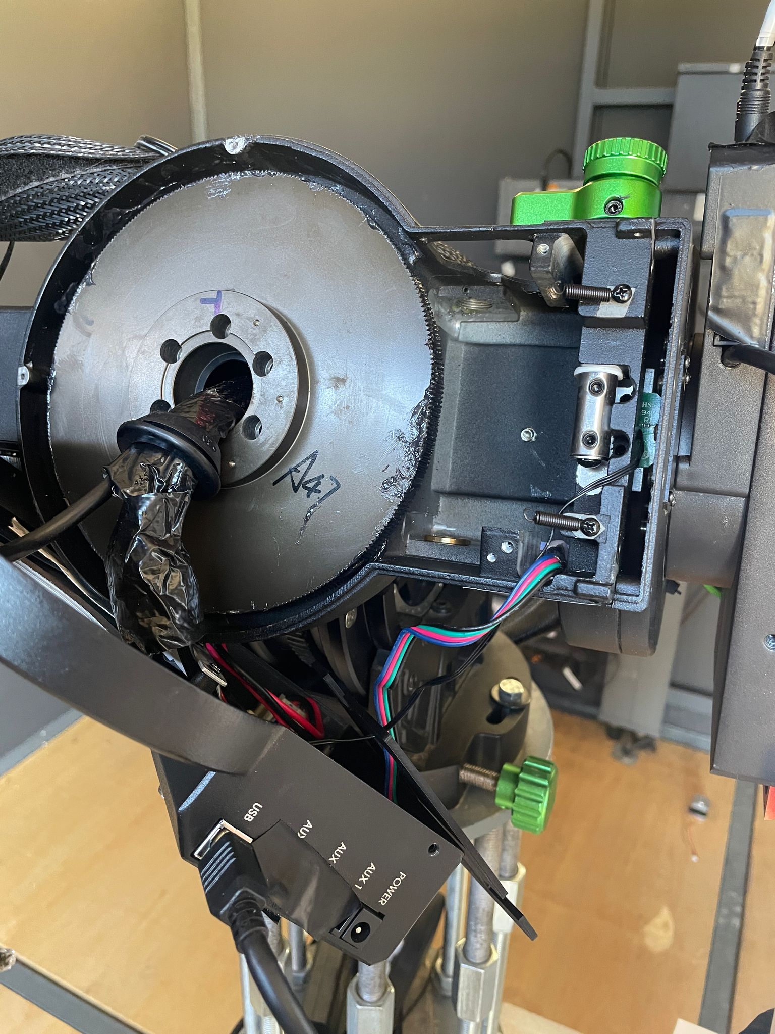

I found a pic of the moutn with the RA block removed...
The inability to remove the belt easily in this mount is actually one of its biggest design flaws... hopefully one day I meet the guy who came up with this, and tell him how many hours we spent to figure out how to replace the belt.
If your belt is just slack, you can try if you get it tensioned though the small "RA service opening" on the side, but I think that the bearing that they use as tensioner cannot really be adjusted - its just held in place by cheap screw and a shim.
I think the shaft was loose all the time - they probably already broke it at the factory.
After a couple of months we were experiencing step loss during fast slews and then the torque went down.
Basically the shaft was just held together by the pressure of the casing.
Sourcing a replacement was actually easy, but finding the error was tough - as I wrote above the CQ350 uses the same motors as the EQ6-R and they are sold by some shops.
That’s weird as my mount doesn’t seems to have this access door on the side of the mount …
On mine the belt is really loose … you can suppose move it by hand.

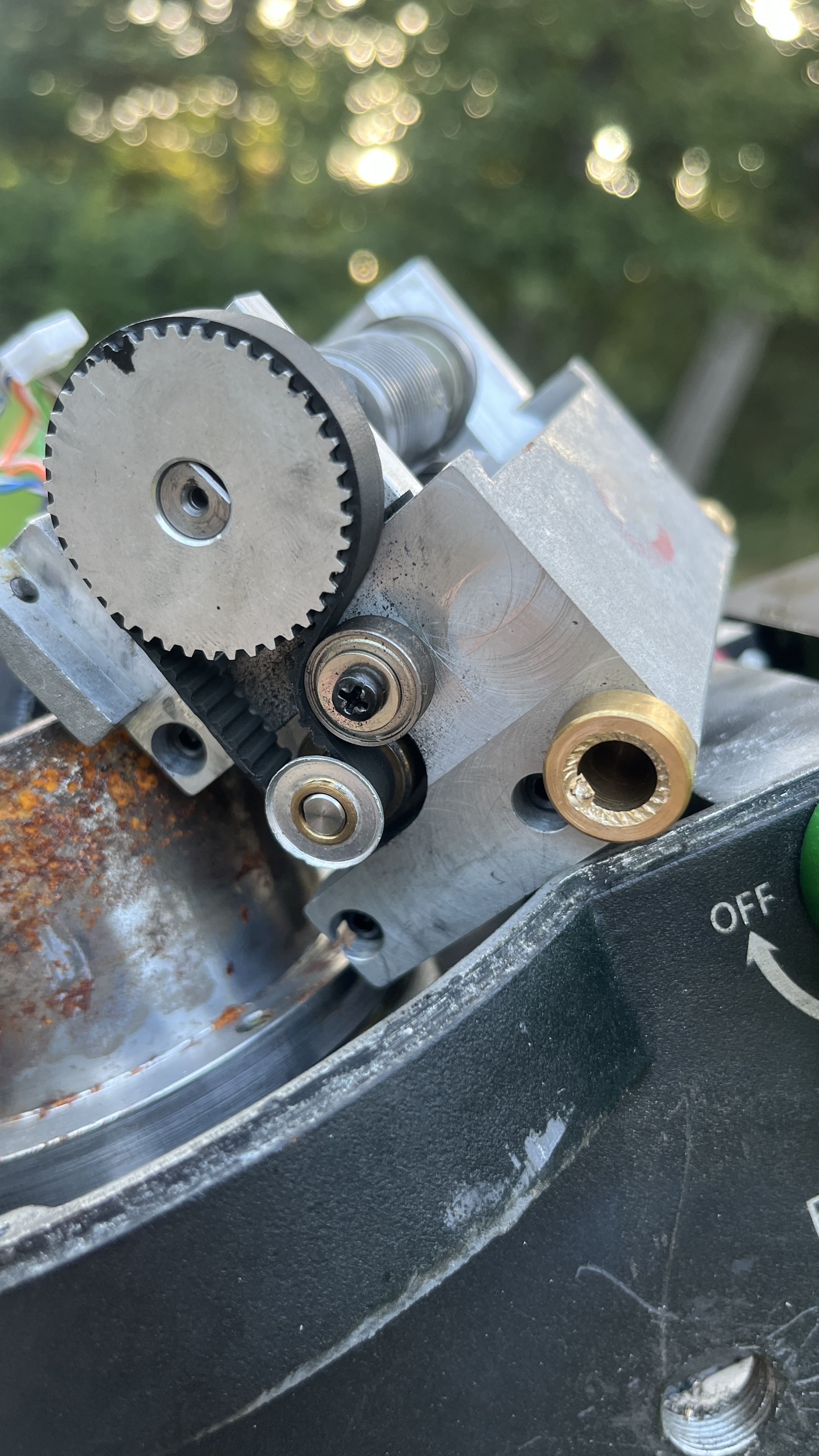

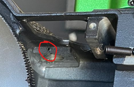

So that pin that holds the worm block in on my mount is stuck in there bad.  The Dec one comes right out.  I ordered a eq6 worm bearing removal tool that looks like it’s made for the two hole bolt head that holds in the worm block.  I would really like to replace that pin if I can ever get it out but I can’t find it anywhere.
DP2 0.00

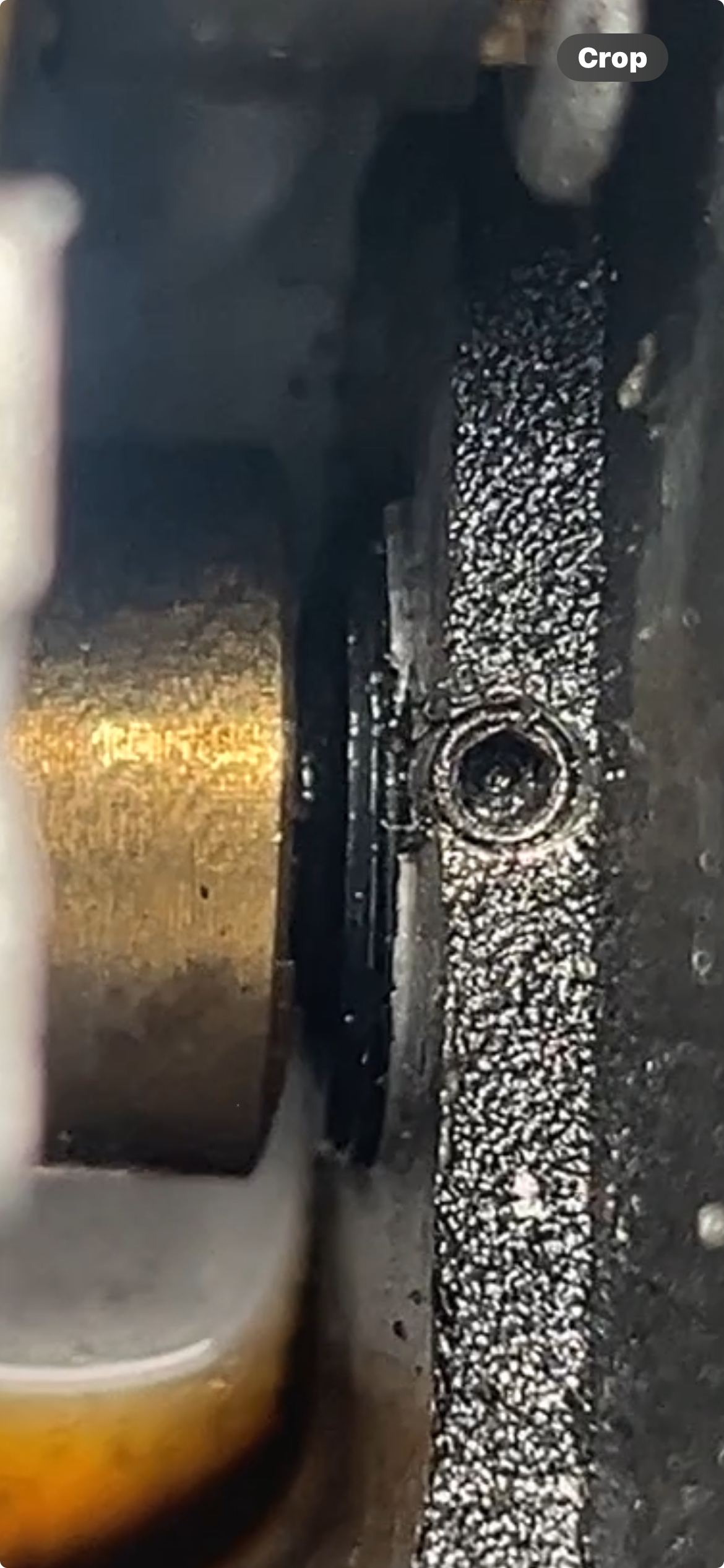

In Niko's picture (which seems to be a different CQ350 version from yours) it looks like there is a locking set screw that needs to be backed out before pin removal or you'll gall it.
AstroNico 0.90
@Nick Fritz : This is what @David Pitou  is refering to.
Another BS design IMHO, because the grub screw will damage the thread.

Yeah I have stuck every size Allen I have down that hole and it appears there’s nothing in there.  The Dec bolt came right out but the RA is not.   I’ve looked in the hole too and it looks like a threaded hole with nothing in it.   Oh this mount!!!

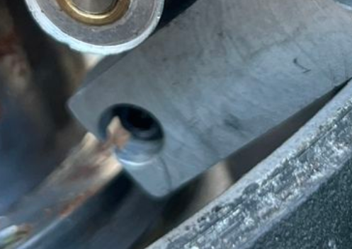

Yes I have.  I ordered a new set to try again.  My eyes tell me that hole is empty on both bolts but I’m going to stick everything I can down there while I wait for this eq6r worm socket to show up.  Hoping the holes are the same on this bolt as they are on the socket.   Anyone have any ideas where to get a new bolt just incase?   I should be able to repair and make this one work again if it ever comes out.
DP2 0.00
Can you post a picture of the DEC one? My guess is it looks like it would be custom which means factory or your local machine shop. You can just take it in and have them duplicate it. Won't be cheep (unless you plead your case like an academy award actor or send your wife), but may be worth it. Repair would be cheaper - just get a GOOD set of needle files and take your time.

I just got some more pictures from our mount.
Here you see how he bolt looks like, when it is removed.
Looks like the have put lots of black paint on the threaded part, which can make it very difficult to remove once it is screwed in.
Can you send a picture how yours looks like now?

That's custom, so repair would be best. Can you get it to rotate at all? If no - wait for the socket or you'll just bugger up the holes (looks like they shouldered, jammed, or black-paint glued it to hold it in place instead of using that stupid set screw, so a lot of torque is going to be needed for removal), if yes - spray it with some WD40 along as much of it's length that you can get to and work it back and forth a bit (be careful of the holes). If you can get a bit more rotation keep working, if not, again just wait.

When my tool arrived and I uncover it again I absolutely will.  I intend on shooting some more videos that show how to do this.   I used to work fastener company and we made stuff and had things made so I might try them if I can clean it up real nice.   It’s the head with 2 holes in it that kills me lol.  A spanner wrench is too wide and the pins are all too big.    Silly design I think.  Should’ve been an Allen head inset like everything else.   I’ll get there eventually.

I just saw the pin painted black that you posted above.  I’m thinking this is my issue as well.  The Allen locker screw is a 1.5mm but neither were tightened down on this mount.   I went ahead and backed it off some more but I see they did not have the RA lock screw hole drilled correctly.  Almost half of my locking screw is exposed.  This is a picture of the Ra and the Dec locker screw. IMG_9143.jpegIMG_9144.pngIMG_9145.png

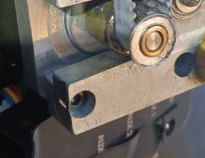

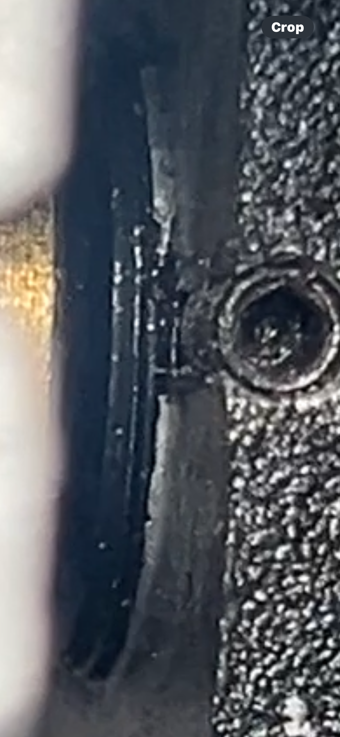

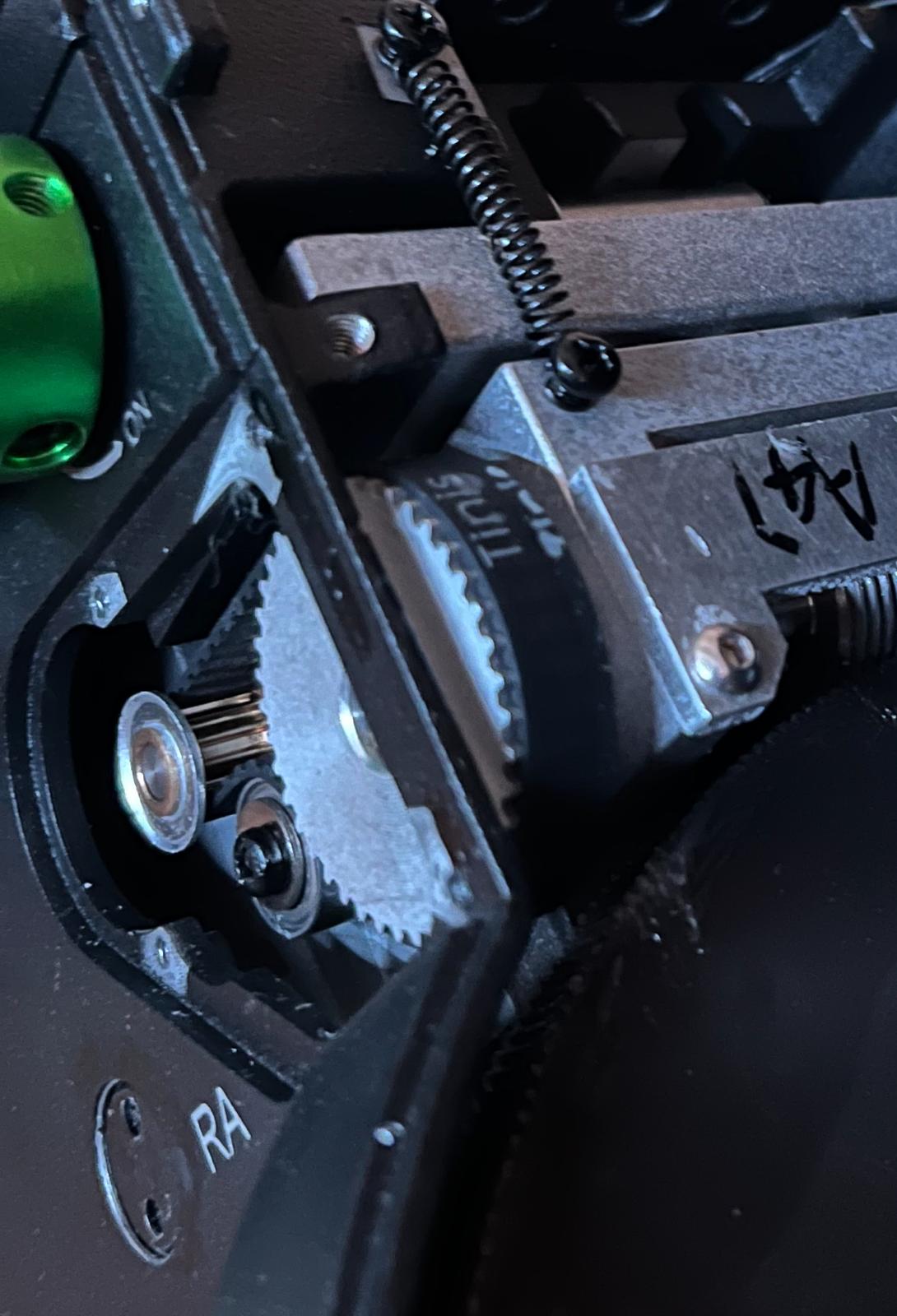

Hard to tell from your closeup, but it looks like the belt isn't tracking correctly (it's protruding over the edge of the pully) which is a wear issue and if there is some edge runout can it intermittently touch another surface (may be the cause of your spike)?
Astrofritz 0.00

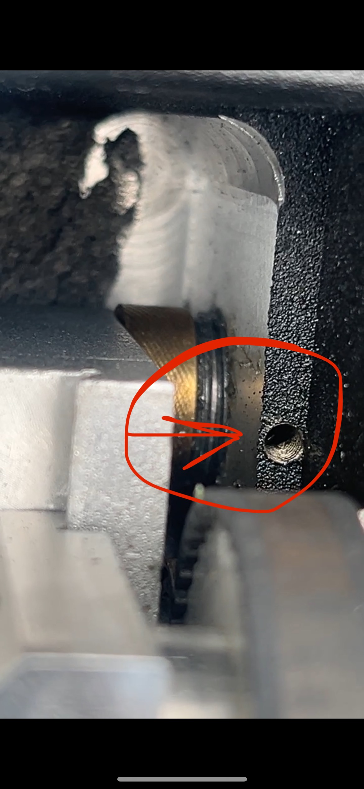

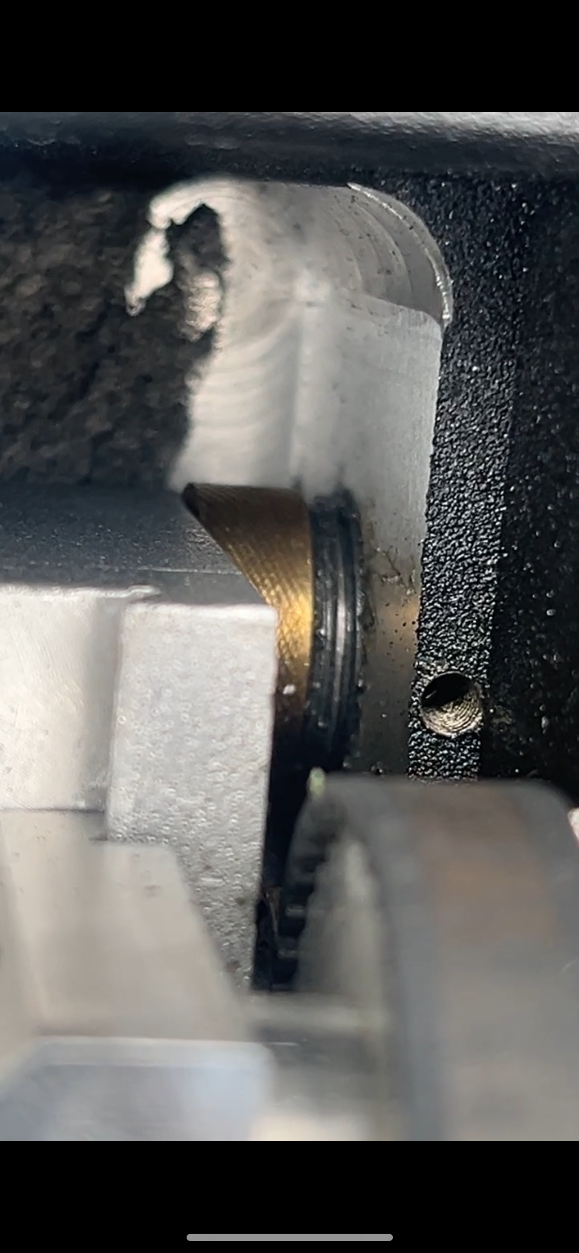

Notice how the first picture you can see the pin and the second one you can’t?  They did not do a good job job drilling the lock screw hole on the Ra.   See how you can see the pin?   It should be in its screw hole but 1/4 of the hole is exposed.   This should’ve never left the QC table.  The belt definitely is not staying centered   The noise I’m hearing and spike I’m getting is most certainly going to be from a hard part failure    My tool just landed in America so hopefully I get it soon and can remove this Ra worm drive pin to get to the root cause    I was just pretty surprised Skywatcher let this go as good when I would’ve said whoa whoa whoa    Who drilled that hole?   You missed!!   Start over with another one cuz that’s not gonna cut it
Astrofritz 0.00

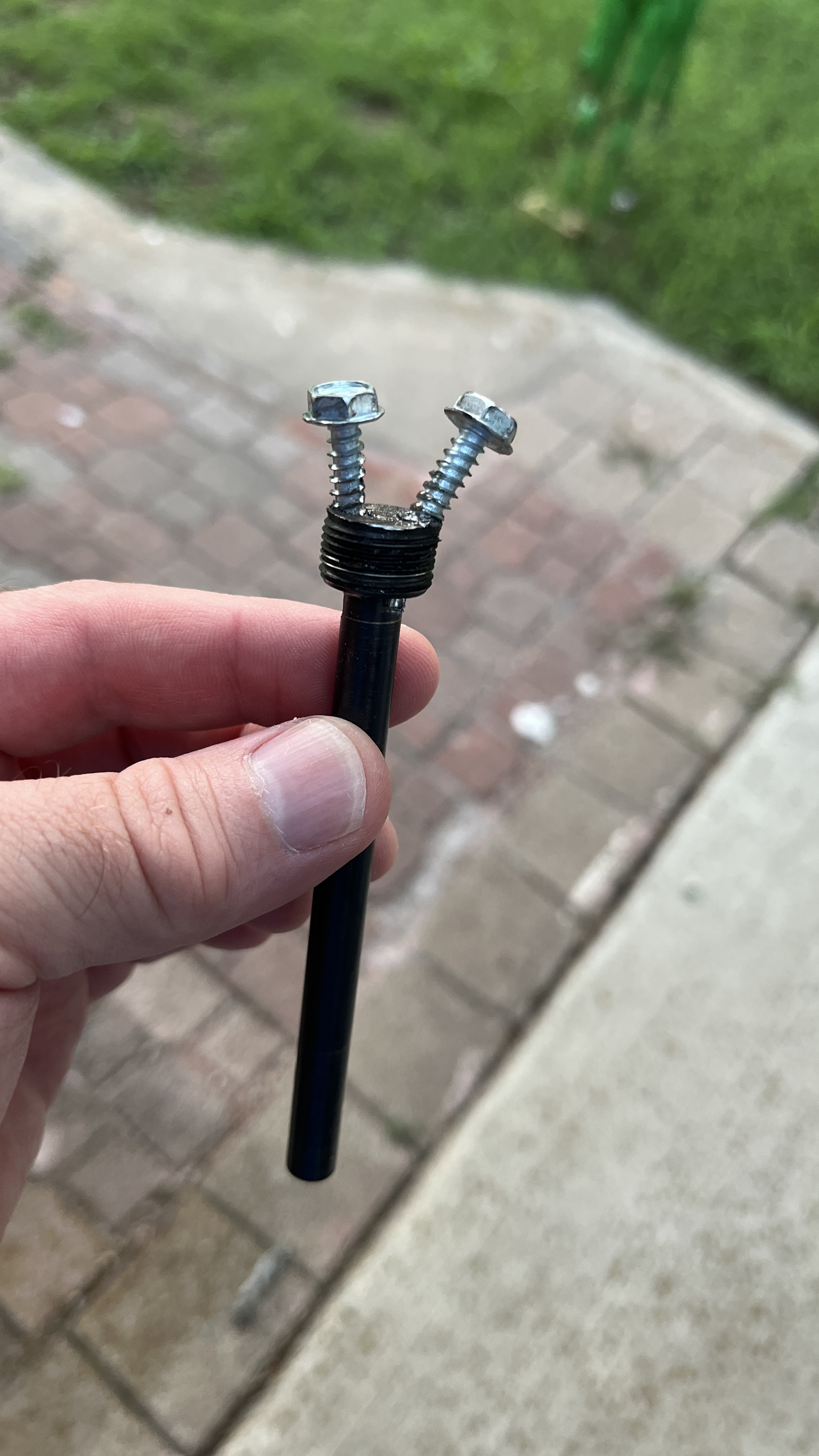

Good news is the bolt is out!!   Bad news is it took a lot to get it out.  It is out now and the worm block quit making the noise.  The worm drive feels rough when operating the ra drive so I believe I will be ordering that along with a belt and a new bolt for the worm block.  Skywatcher said something like 45$ for the bolt.   I am going to take the idler pulley off tomorrow to get the belt off to free spin the worm shaft and ra drive and see if that tells me anything else.   One question…. Do you guys just cut and solder the wires in for the new ra drive motor?   Thanks a bunch and will be posting again soon.  IMG_9212.jpegIMG_9207.jpeg

Almost there Nick! Thanks for sharing this journey and public service
AstroNico 0.90
Hi @Nick Fritz,
congrats to the creative solution, and ouch... it looks like that bolt and the brass part on the RA block is damaged - you should definitely file that brass chip off.

By the way it looks like this hole is also not drilled correctly...
seems so be a general thing... ours also looks weird at second sight.
