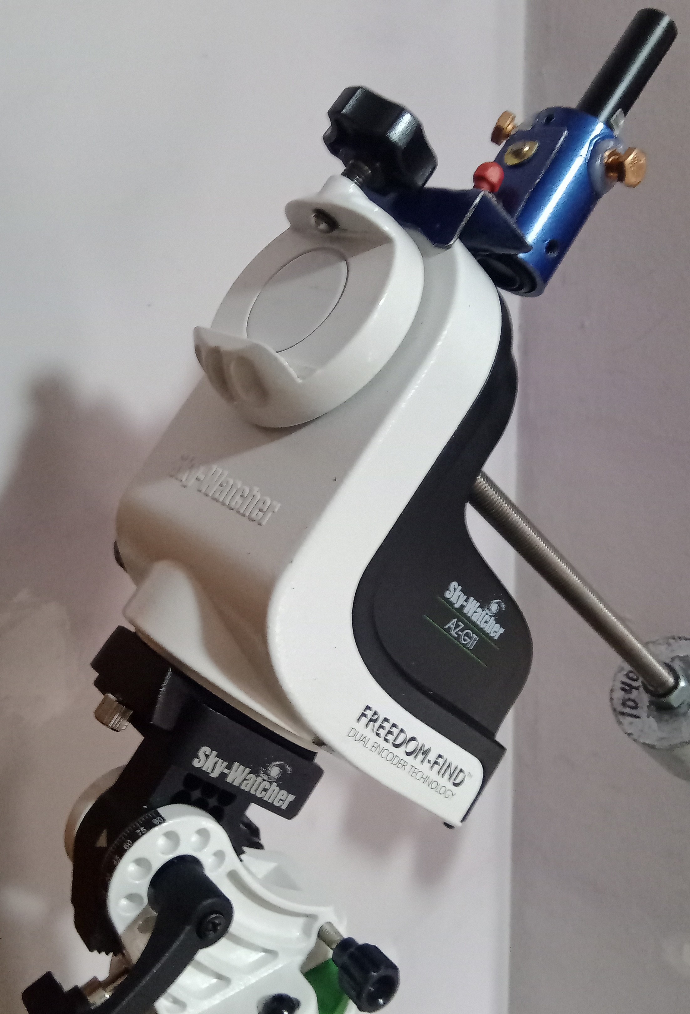

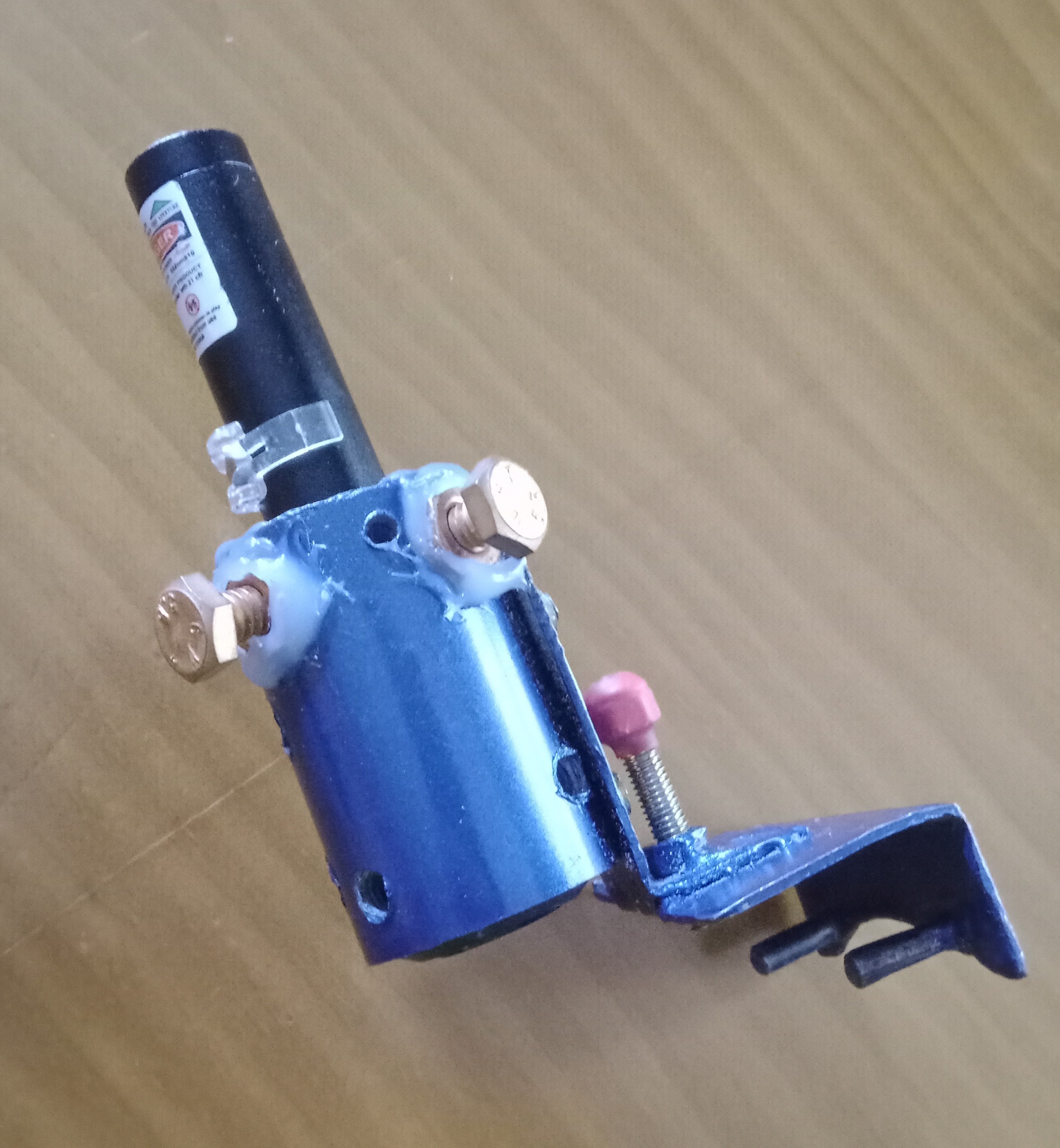

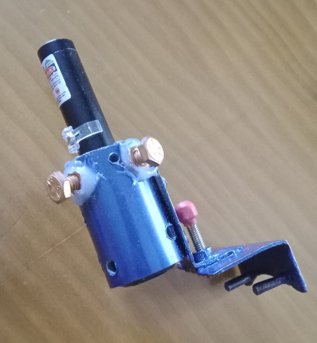

Hello. This is my handmade solution for polar align with AZ gti, i kwon that there are some comercial solutions. Laser pointer must point to celestial north pole. After of this, you can do better align by software, PHD2 for example.IMG_20241023_135903_319~2.jpgIMG_20241023_140208_495~3.jpgSorry about my english level...IMG_20241023_140624_652~2.jpg

https://starlighthunter.com/articulos/buscador-polar-az-gti/
I found this article by Oliver Gutiérrez where he explains quite well how to make a homemade polar finder support. It seems simple. If you are not very handy, you can search the web for "az gti polar scope adapter". The Kepler brand has a commercial system at least.
